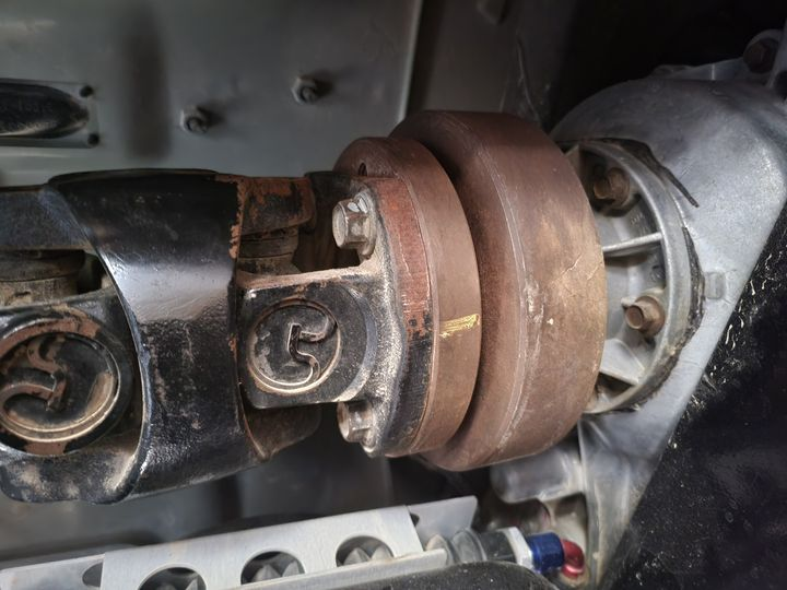

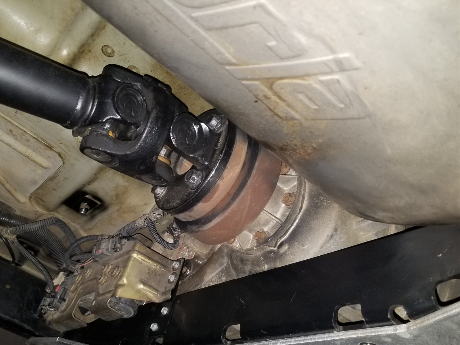

Is the factory dampener on the 241 removable? and is yours removed or do you still have it?
Mine is still present. I don't believe them to be removable...kinda like a harmonic damper crank pulley. We'll see though. Parts are showing up tomorrow to rebuild my 241 due to a bad front output bearing (and stretched chain, most likely).
Reactions: PRNDL
Never had one so I wasn't sure if it's part of the yoke flange, pressed onto the shaft in front of the flange, or what, and I could see how changing it out to a yoke might be a 241 mod to get more driveshaft length. This response sounds like the dampener is indeed tegrated in the yoke flange such that running something like a 1310 yoke gets rid of the dampener...
I am currently running a 1310 yoke with a conversion u joint at the case end since my used case didn't have the damper. This thread and a few others led me down the path to source a damper before they were even harder to find than they are now. I have a used damper on the bench I sourced from ebay. I am currently running the stock lj Rubicon driveshaft for now.
Mine is still present as well. I believe to remove it, you have to press it off the shaft, meaning you have to disassemble the transfer case.
I've thought about cutting it off, but it has a 50/50 shot of making it worse vs better.
No reason you couldn't drill holes in it to make it lighter and higher resonant frequency or do the opposite and add weight to make it a lower resonant frequency.
A shorter output shaft could go a long way to improving driveline angles. That said, I know of exactly zero kits, so I suspect it would be custom fabrication.
I believe it has a rubber center isolator just like the harmonic damper on the engine, so theoretically it will fail eventually.
It's just an assembled output flange. Comes off just like any other output. Swapping to a regular output does make the driveshaft a touch longer or put another way by maybe 2 inches.
Biggest thing is make sure you get an output specific to this case. I am currently running a jb conversions 1310 output. I snagged the damper for when I regear to try out if I developed vibes.

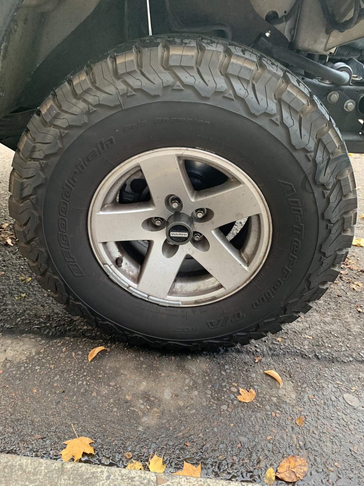

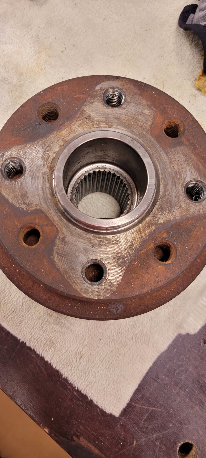

As someone who's never laid hands on either one, what about that photo indicates it's a Ram Man conversion vs the standard conversion with a Warn hub?
The fact that it is done on the factory 5x4.5 wheel. They were the only people offering that AFAIK. Most installers would have some concern with the wheel strength/integrity drilling that out so close to the lugs ...

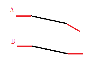

No need to catch up beyond just my most recent post, I just put it here because it's relevant to the thread, rather than starting anew. To distill it down to the important points:
1. The 1-3 I found wasn't just the pinion vs the output, it was the nominal operating angle of both joints. So if the output was perfectly horizontal 0, the pinion might be at -1 and the shaft at 1-3. The point was advising against having any joint at zero angle, or said another way, the shaft in a straight line with the output.
2. If a u-joint likes to have 1 degree of operating angle, conventional wisdom says we can't really do that with a DC shaft because if the pinion u-joint is not at zero, there's not another joint to cancel out the angular velocity difference.
Ergo, the point of this thought experiment isn't to reduce angles but actually to add angle at the pinion so that no joint is running straight-on.
Your observation with the XJ's running double-double-cardans in the front however is well taken. That was the main concern I was thinking of - since the two joints don't perfectly cancel one another out there's going to be some of that acceleration and deceleration, and then we'd be doubling it. If they end up having that high speed vibration in XJ's then it's probably not worth the expense of building the driveshaft to try this out.
A double DC would be added cost and complexity in a situation where it isn't needed. That's the main reason.
a great reason for most rigs. I'm only entertaining it as a consideration for rigs with seemingly unsolvable high speed vibrations.
IF one were to do a double DC, I'd raise the pinion even more so that both DCs were at the same angle. Seems like this could be a solution for too-steep short shafts.
Same angle like A? I think to have the best chance at eliminating vibes you'd want it set up like B.
