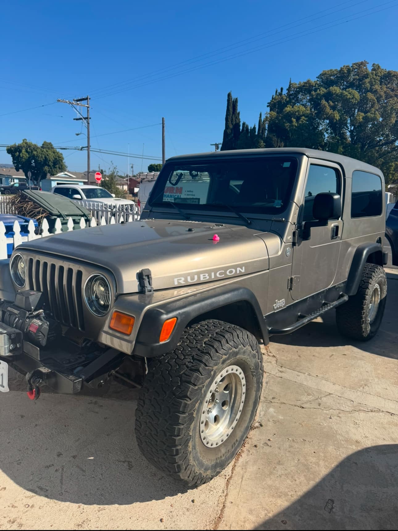

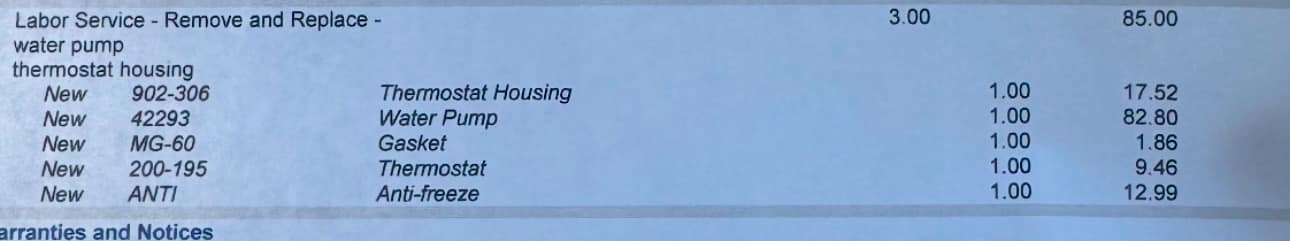

I have a 2006 LJR with 100k miles, automatic, which I've only had for a few months. Today, it started overheating while going uphill in hail on trails with an ambient temperature of 78 degrees (San Diego weather). The engine temperature went up to 239 according to OBD2, but the oil pressure remained stable. The previous owner had done some work, replacing the thermostat, water pump, and more 10k miles ago, back in 2020. The radiator is not original, but the coolant and radiator appear clean. The fan clutch seems okay. I've had other TJs before and know they typically run between 210-220. What should I check?
