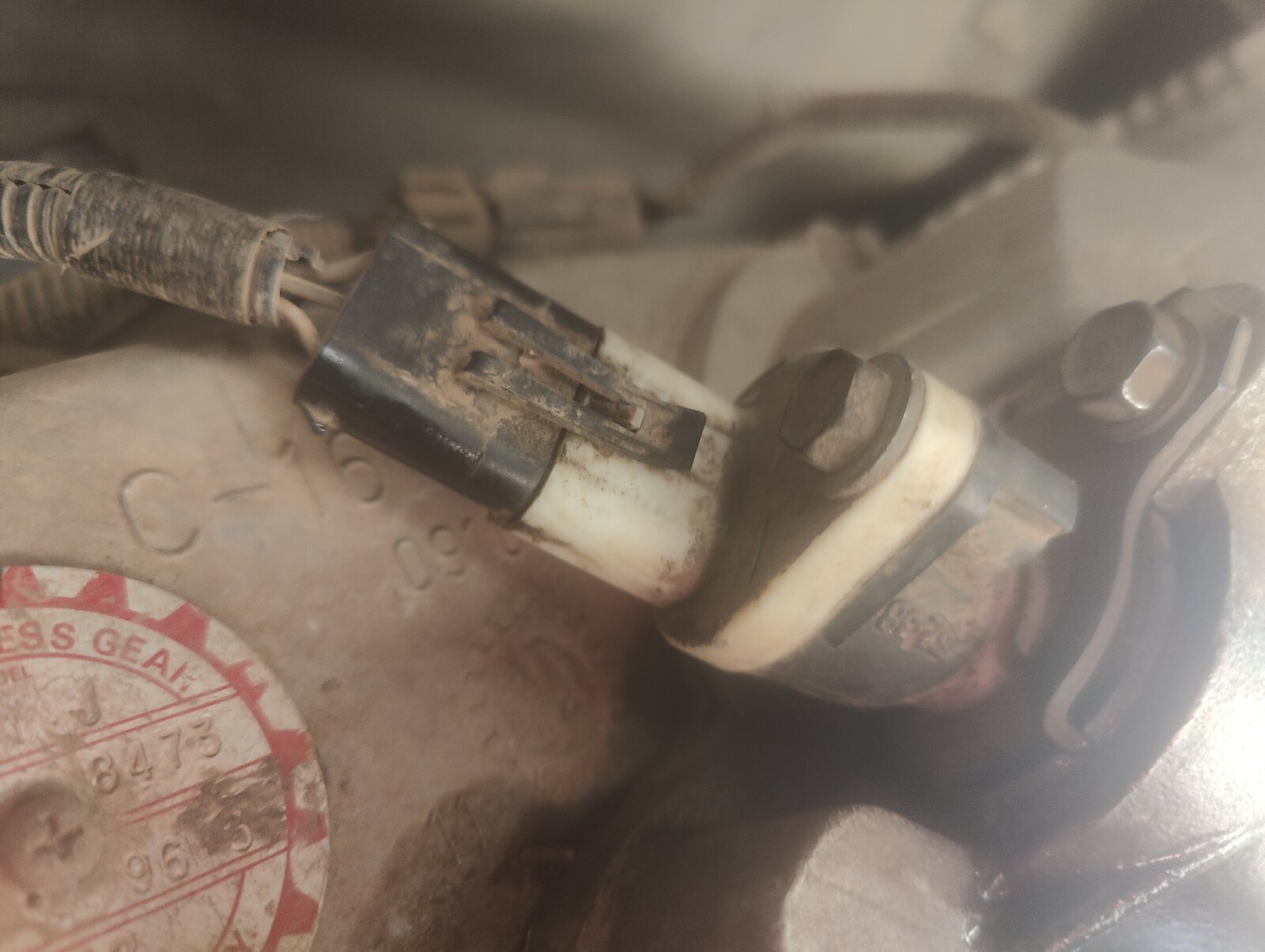

Since the seats were out I started diagnosing the ODB port... working through the FSM and checking voltage on connectors. 8w-30-9, 8w-70-19, 8w-80-26, 8w-80-24 and 8w-80-7 have all the diagrams. Basically redid all my trail troubleshooting verifying power at connectors and splice points working towards the connector.
Until I really looked at the connector and port 16....power connector looked corroded...once I put on readers so I could really see...I realized that not only was the wire green dust...but the connector was completely missing...the PO probably stripped the wire and shoved it in the hole. This would explain why I had to wiggle my Bluetooth code reader to get it to work.
Called the local auto electric looking for a single pin...he recommended an entire new connector...grr... don't want to wait...so I ordered one from Amazon.
Meanwhile going to repeat the PO hack and strip the wire so I can read codes...

Hard to tell from the picture, but that looks like an industry standard connector pin of some sort. Check with Newark, DigiKey, etc.
Yup I completely agree and I wish I had a ziplock bag of a 100 of em. Betcha @mrblaine can cite chapter and verse of the connector type.

ODB port is fixed. Depined the new one... disappointed the wire is aluminum...and just replaced the power wire.

Messed around with the speed sensor. Tried figuring out from research how to clock the housing and then realized that I already knew where it shouldn't be... actually two of the four possible positions. So I rotated it another 90 degrees and presto it's working perfectly albeit all the in and out might be seeping fluid. Going to run the torn up gear for a week and put in the one I bought for 35s...never installed it because the one for 33s was pretty damn close. And drain and flush all the plastic out. Might get my endoscope in and see if I can see the screen on the oil pump... hopefully not jammed with plastic bearing chunks.

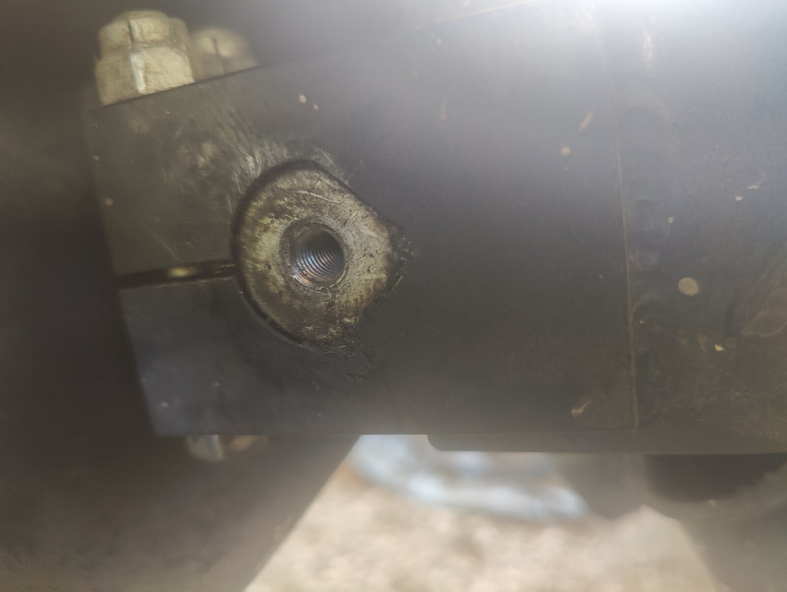

Missing bolt on my Swayloc. Can't identify the thread and pitch...think it's M8 or 5/16 fine... nothing fitting. Reverse thread?
Check engine light came on for the speedo sensor. No return of cylinder 6 injector or downstream O2. Cleared, clocked and hasn't returned.

Driver's side? I can take a gander at the one I have sitting uninstalled if you would like.
Yes please! I think my threads are dinged up and it needs chased with a tap.

Oh yeah the thread.... right hand thread 5/16 NF both ends.

Thanks for the bolt size!
