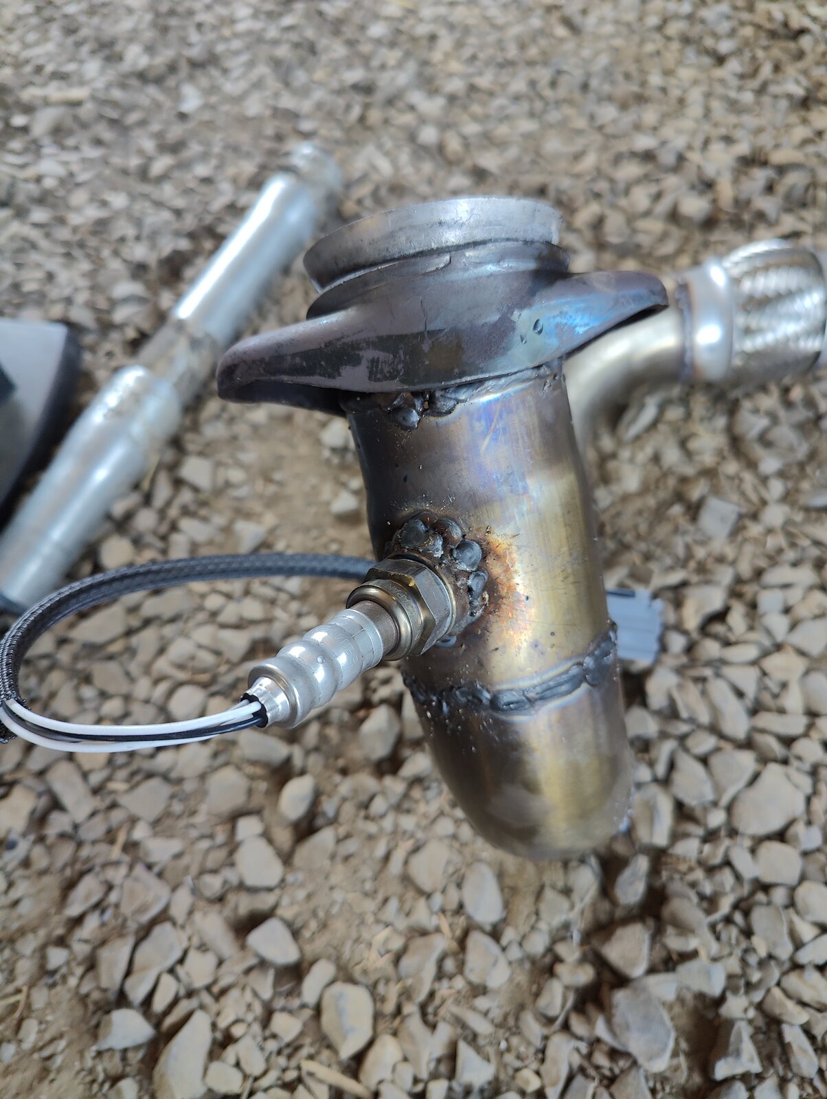

Mopar O2 sensor arrived from Rock Auto and the stainless bungs from Amazon. Drilling a hole in stainless is a royal PIA. Ate a step bit quick. Managed to get a 5/8" hole in and hogged it the rest of the way with a carbide burr.

Stevie Wonder weld that 02 bung? 😁
