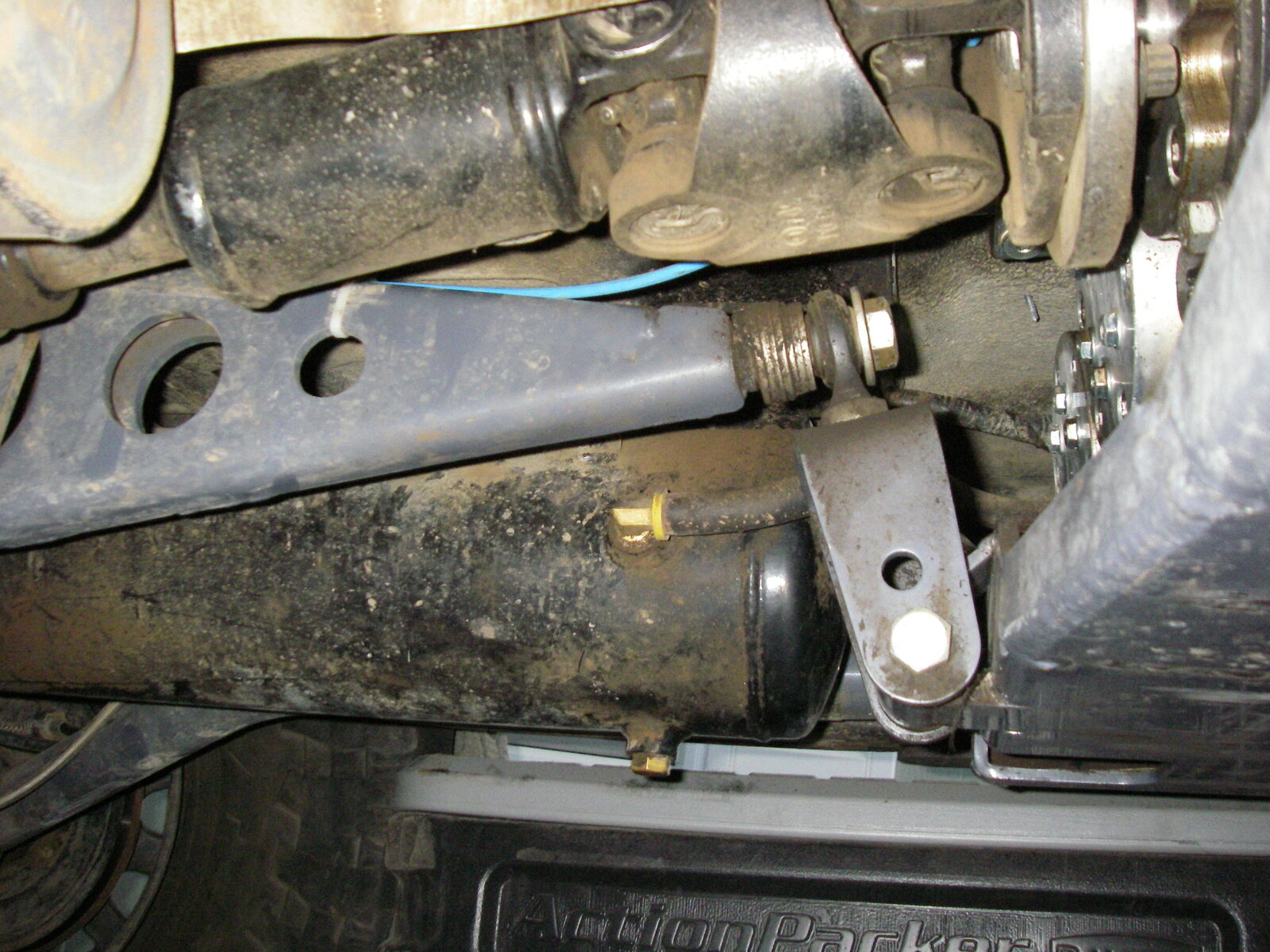

Did something wrong. Sorry. The bushings are at the bottom where the inverted "U" is mated to the bottom plate. Tried to measure them today, was going to remove them but chickened out. They are oil swelled and I did not feel like fighting them back in:)
Close as I can tell they are 1" OD. The bolt is 12MM. I still think it should have a sleeve inside the bushings.

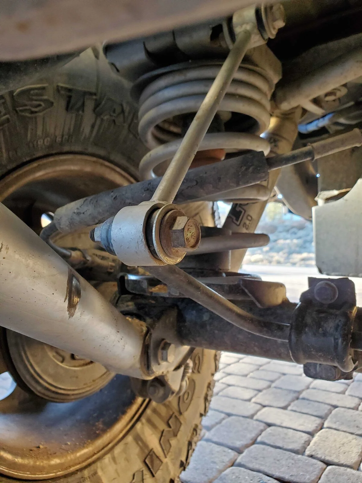

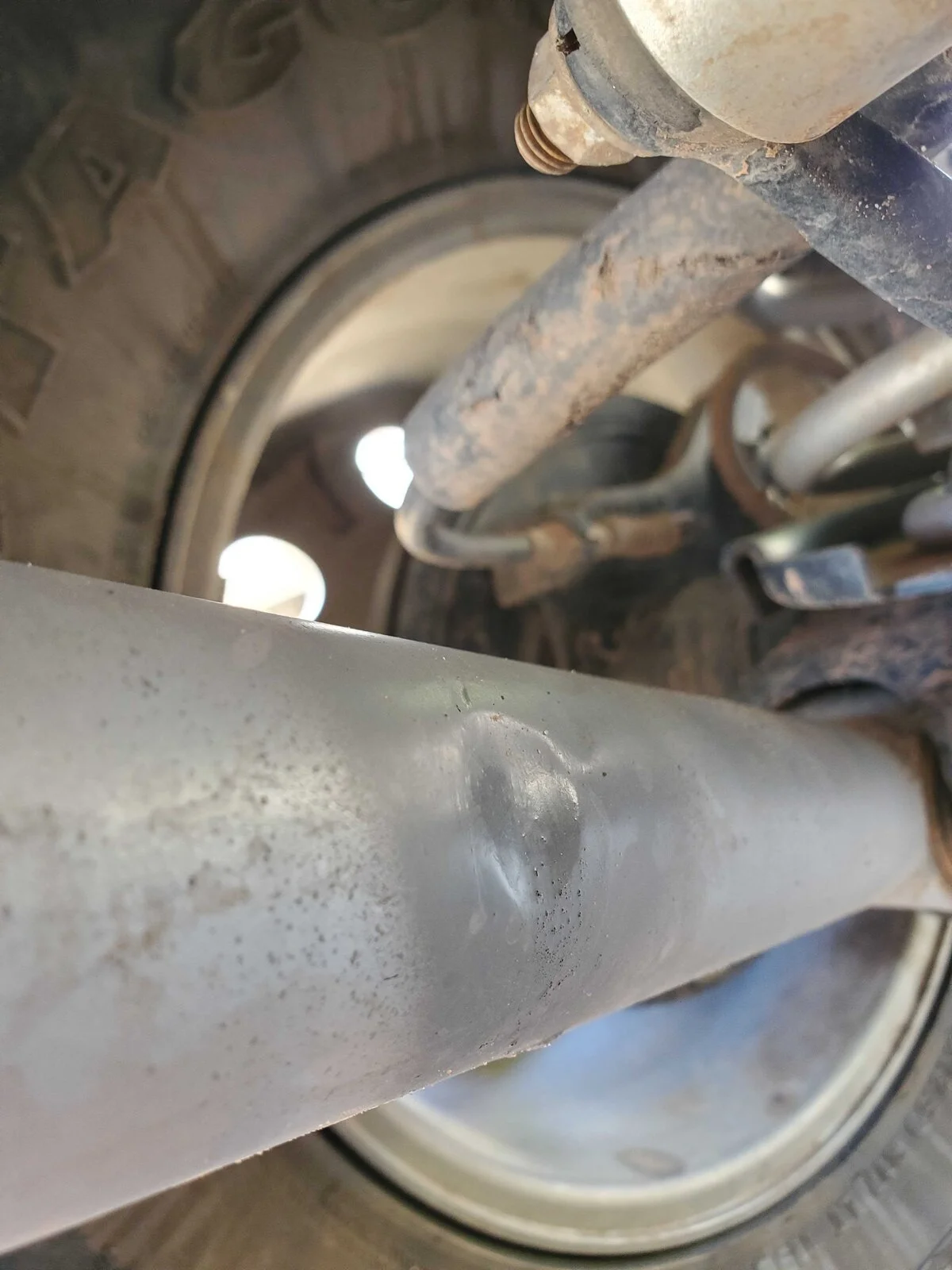

Same thing happened with my rear control arms. The driver's side only lost powder coating, but the passenger side lost a decent amount of material (would guess 20-30% of the .250). I painted it and have been keeping an eye on it. Guess that's a potential disadvantage of the dog-leg design, though we also could have both avoided this with proper accompanying parts from the get-go. I installed 1-1/2" shorter sway-bar end links and that addressed the issue entirely.
I think @Malibuss is right though...your best bet will be to weld back a little material if they're worn down deep enough.
