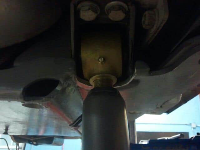

Did Dave say if it was difficult to swap out the Gyro Joints for Johnny Joints?
He said it was something I think he has to do at his shop.
From his description you replace both the frame and axle joints.
Currie 2" narrow x 9/16" x 1" the axle end can be replaced by a synergy dual durometer or cut off and replace the cold cut ring with metal cloak. It needs a high misalignment, self centering bushing that has less resistance than the stock cleavite that was used by nth degree.
This eliminates the binding for guys that want to run with low lifts as well as more downtravel than the clam shell allows.

Yes, I just wasn't sure if it involves cutting and welding, or if the John Joints just pop in.
That's cool! Let me think about this, as Moab is still a ways away, so there is time.
I didn't know Dave has a complete long arm kit. Did you see it laying around at his place @psrivats?
I have not seen the Jeep west long arm, only recently learned he had one. I did see his 3 link rear and 4 link rear setups though.
It takes drilling but I am not sure what else. He'd have to answer that question.
Dave posted info on swapping the Gyro joints to Johny joints here -
The guys from All J also do something similar or use to.
It's a mid arm like Savvy's not a longarm. I am not sure what his arm lengths are.
I have Dave's midarm in my Jeep ...

OK guys I am not to good at this forum stuff but need some help. I resurrected a Long arm Nth degree lift kit from a junkyard for my 06 LJ Rubicon that I am building to moto around the desert here in Yuma and the Parker area.
First question I have is about springs and shocks as I didn't get any with the kit. I am going for a mild 4in or less lift. I have the Nth spring pocket relocators installed on the frame for the rear axle and from what I read it adds approx 1.75 of height of the lift so am I right in thinking get 3 in springs for the back and use 4in for the front ???

What are you needing? Or just sharing? Did you get the frame mounts brackets for the gyro joints?
Yes I have everything and its installed in my frame just need help right now with springs and shocks and final adjustments. BTW I have a source for Gyro joints that are CNC milled out of a 95 Durometer urethane material with a 2 week turn around and he will make you a full set or just fronts or rears. I will post some pics here soon.
Have you read thru the install instructions at the beginning of this thread?
All J products is also going to be making gyro joints soon. But that is good to know that others are making them now also.

With the long arm you will need to be more than four inches of lift or you will have to get creative on some of the adjustments as the kit was designed for 4.5 or 6 inches of lift.
@Blackjack I am running 4.5 springs and the spring bracket relocator on the back and 5.75 on the front. 4" spring with a 1.75 spacer. My next question is about the Shock shifter. This kit has been an erector set that I resurrected from a junkyard. I have been piecing it together as I go along. I got none of the shock shifter parts with the kit so my question is. Is the Shock Shifter required or a great thing to have with the kit?

I have a full LA kit on my '03 TJR.
I've purchased a few replacement bushings and such from All J, really glad they are keeping some parts alive and accessible!
Have a few random questions:
- What is everyone running for caster and pinion angle front and rear?
- Has anybody had issues with their rear slider cracking at where it mounts to the axle tube?
- Has anybody found the correct axle side track bar replacement bushing that fits in the Nth track bar? I have been struggling to find one that fits. Don't really want to buy an aftermarket track bar as this one did work great for me (just had a loose bushing).
- Anybody have a rear stretch kit? Might be something I'd like to go to in the future....
- How far can you stretch your WB with a non-stretched Nth LA kit?
If you are talking about the forged front trackbar, it is actually just a stock WJ front trackbar.
