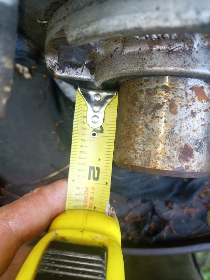

@Rickyd i have my tape measure, what do I need to measure?
Pretty sure all 242 from Jeep (not sure on Liberty though) were behind an automatic transmission.
picture is NP231 that came from behind my NV3550. Top left corner to third way down on edge of pic, is a stud to mount Tcase to Trans, tape measure is against splined input we are discussing. I dont know if this is a long, medium or short as discussed here and for several post after.
My 242 off back of an Automatic is dismantled so cant measure but my memory is that it was shorter... what is your's when measured same way (flange of seal retainer? to end of input female).
My assumption has been need to get 242 to match this. I dont know if this is a long, medium or short
Mine is 7/8" on the 242. I swear I read that the 3550 would work with short or long but I can't remember where
