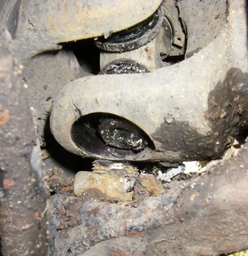

This was from sawing the steering lock to lock and foot in the floor (V-8) with 38" tires and stock u-joints on Alloy USA shafts. They warrantied it and I put 300M u-joints in them then. But now I have RCV shafts. It was deep snow and I was working the steering trying to find some traction.
