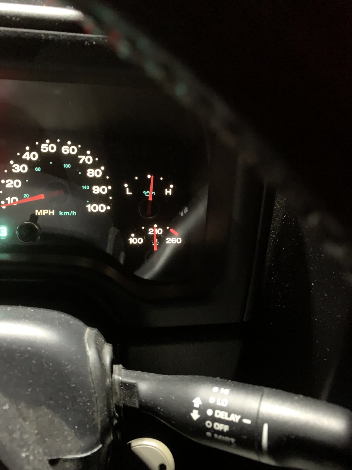

Update, replaced the thermostat with another Stant 195 and engine runs hotter, looks and feels like my other TJs did.
The shop that did the work back in summer, did use a Stant 195 F t-stat, though it must’ve been not operating quite right.
Pic is with the new t- stat. I could definitely feel a lot more heat! Thanks!!!

Yours is running right where mine does! Congrats on getting this part fixed!
