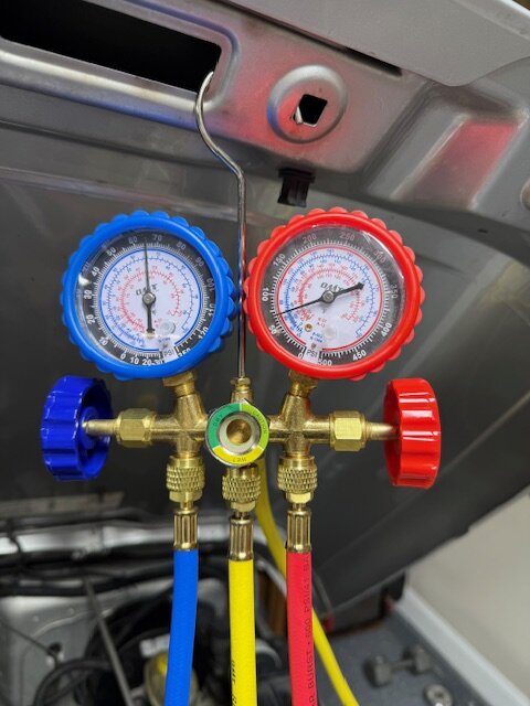

@Renegade TJ Update: Got the oil - 1 ounce and added it to the system, but I realized that it wasn't cycling the compressor due to defrost, but it would come on, low side would drop to about 25, then kick off, it would do this continuously. Added the oil and one ounce of R134A that's in the can, then a few more ounces from a can I can have to get it to about 30PSI on low and 155 on high and it stopped cycling. But I wouldn't get the compressor to stay engaged when revving to 1500 rpm. It would kick back off. So maybe a metering orifice stoppage there? The compressor does quiet down a lot after it runs for 15-20 seconds, but gets loud again every time it cycles. Oh yea and there is a leak someplace on the high pressure side. I can hear it hissing directly after I shut off the engine and the high pressure equalizes. Something from the inlet/outlet area of the condensing coil....fun.
