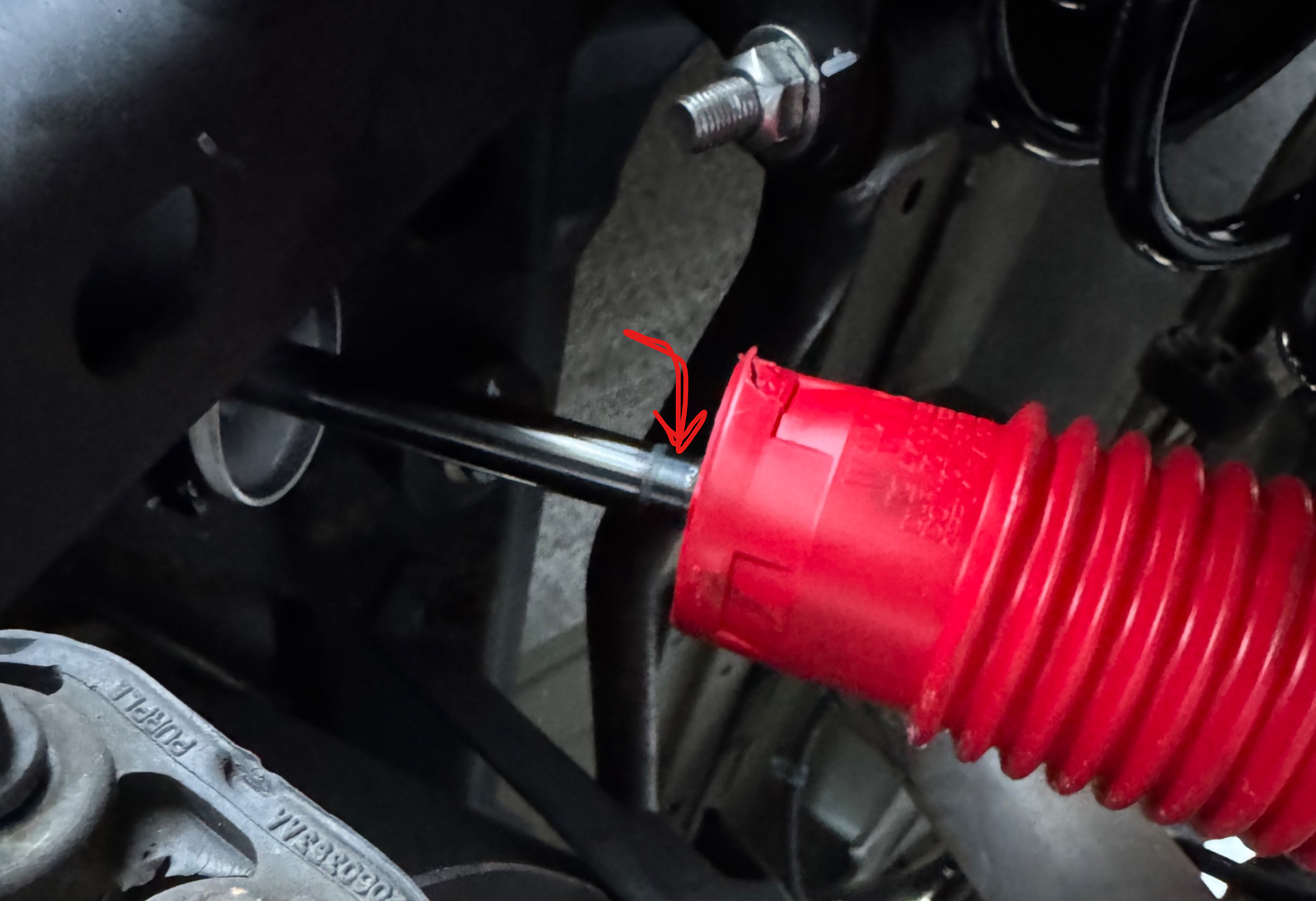

One thing that does look a bit suspect is this spot on the shaft though. It will chew the seals pretty quick if its actually as rough as it looks. should be a polished chrome surface for good sealing and minimal wear on the seal.
Hmm I’ll check that in the daylight tomorrow. Didn’t really notice it, it could just be a lighting thing but I’ll run my finger over it to see if there’s any texture

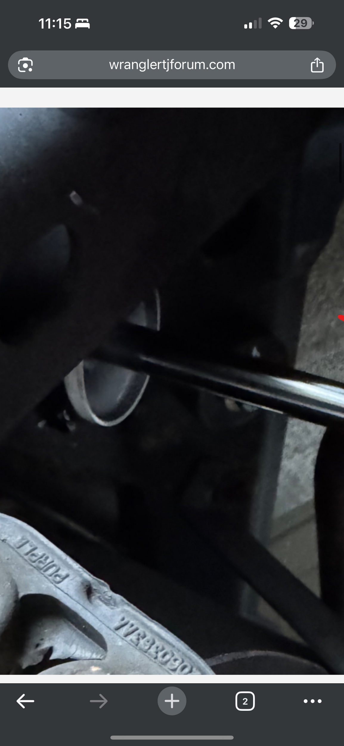

Can we get a close up of this piece. Something doesn’t look right. That should be a bushing with a bar pin going through it. Pull the rubber boot down and let’s take a look at the top of the shock.

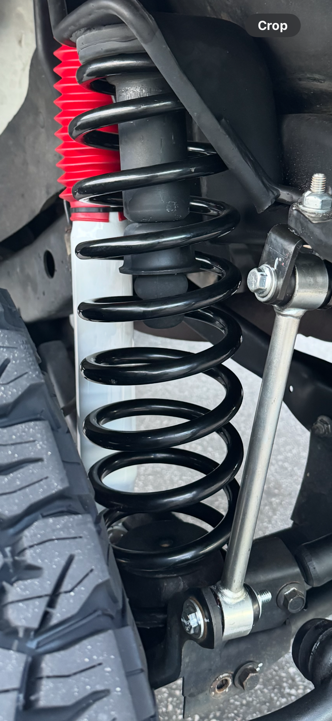

Aren't his LCA's at a awful steep angle? For 2.5" of spring lift that looks abnormal. You only get so much drop before the top of the LCA hits the LCA bracket on the axle also. Id also check the shock number on the body to see if they in fact are the correct ones.
They do look steep. Wrong springs or maybe the shop torqued everything with the jeep on the rack with suspension hanging off the shocks.

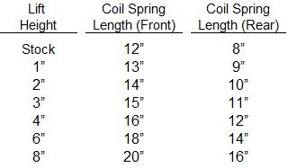

@crazyshot97 measure the lengths of your springs at ride height and let us know what you find.

Hard to tell from the pics, but since the ranchos are can down, on the rear they can interfere with the lower spring perch in the axle. If that is the case it could put force on the shock it shouldn’t be seeing and put it into a bind. It’s odd that the rubber boots both have slid down at the rear and appear torn at the top. Those boots should see about zero force.

Steep LCA would indicate wrong springs? I’ll measure springs top to bottom as soon as I’m home from this trip, Wednesday.
The angle gets steeper with increasing ride height, so they make it look like it's riding too high, as it would if you had 4" lift springs instead of 3".
Your shock zip tie experiment points to something else holding it up so odds of wrong springs are pretty low but the measurement will still be helpful.
