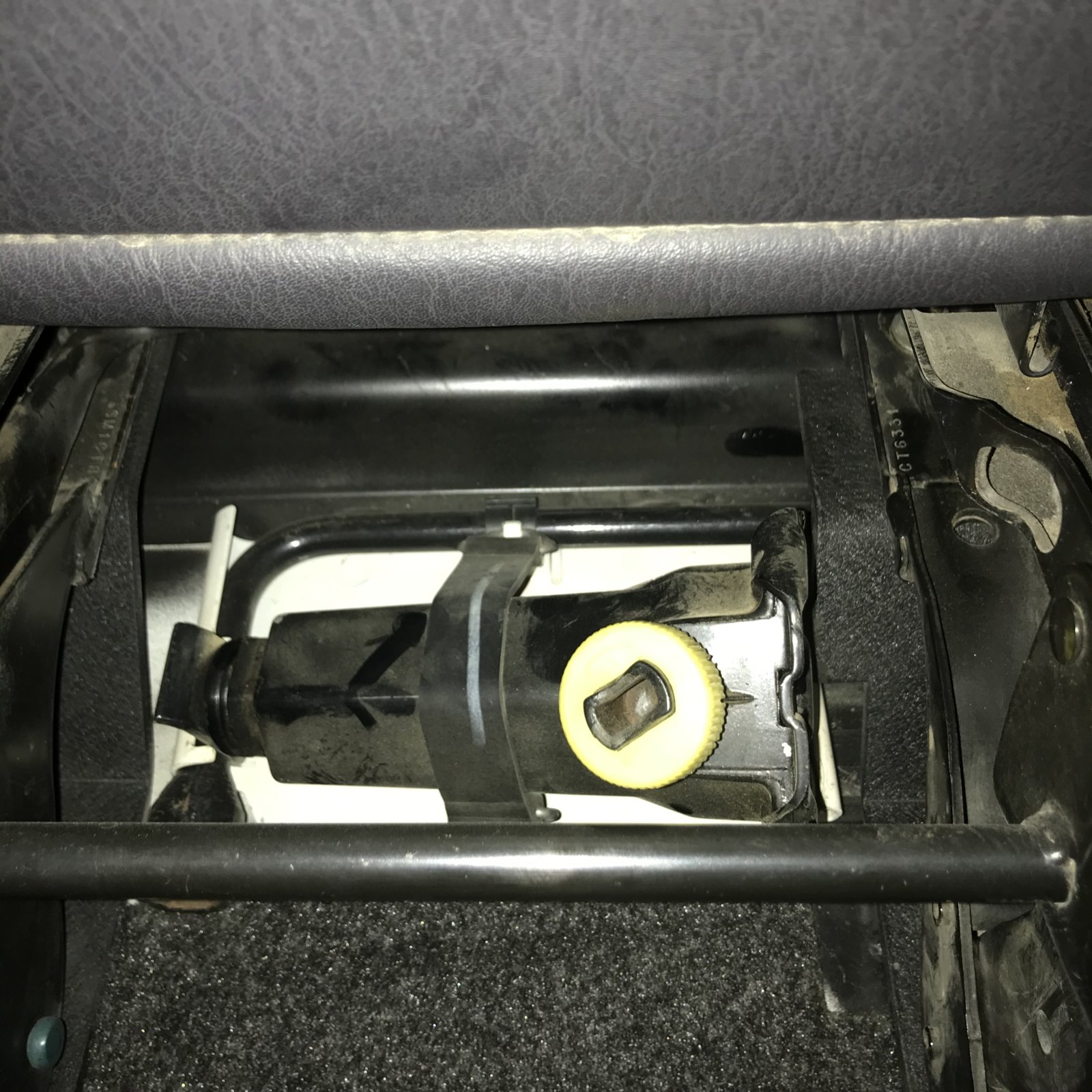

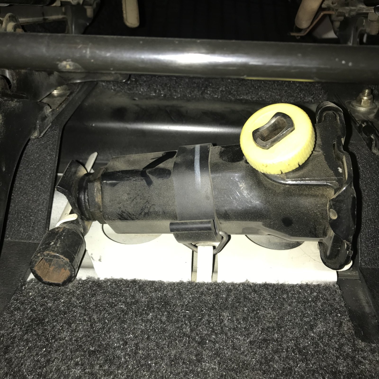

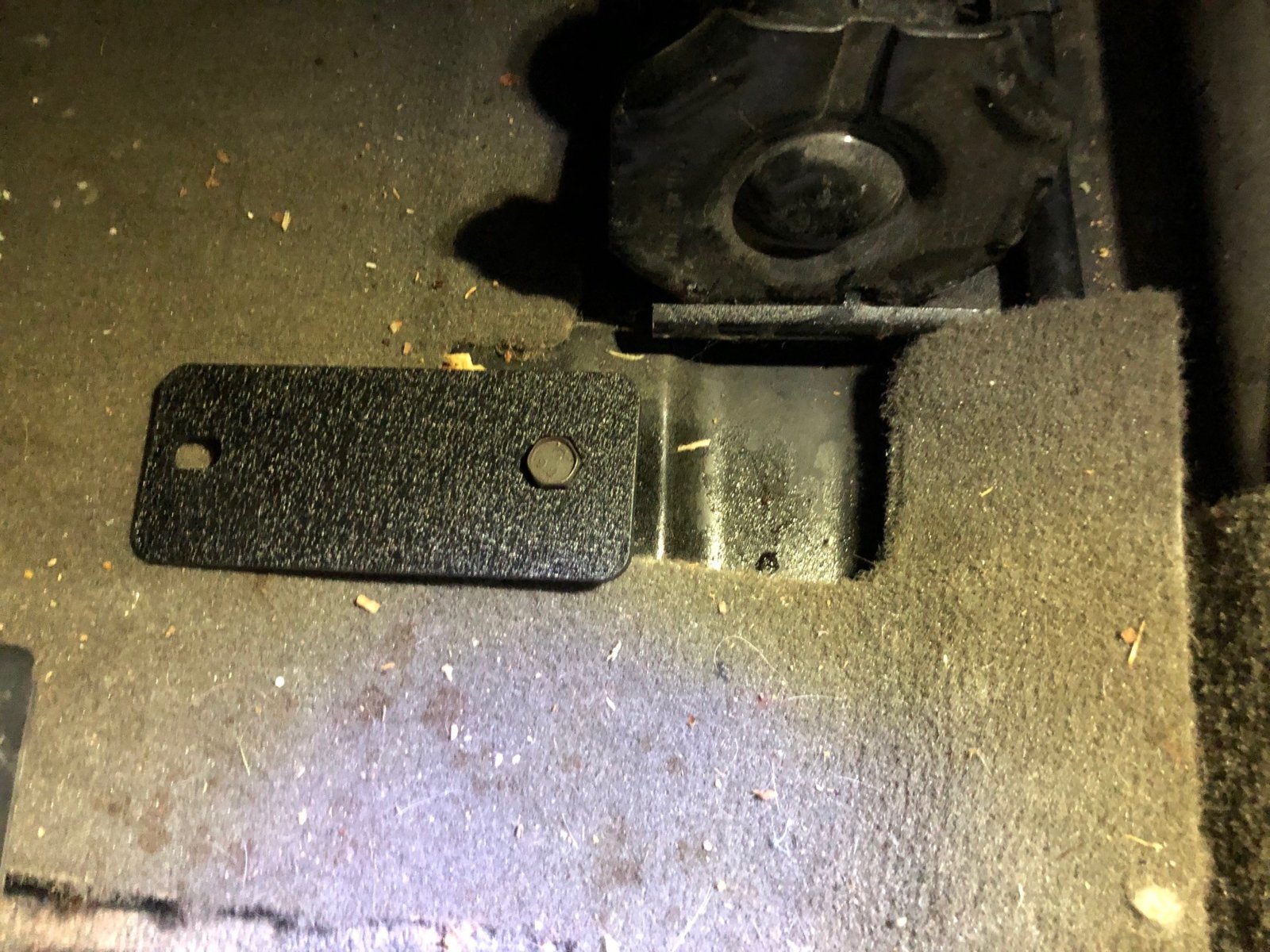

That extra piece of metal is to hold the oem jack in place. HAs anyone figured out how to make it work? I could not get mine to fit properly. It looked like if I ground it down a bit and it wasn't so long - it would work.
The stub on the bracket just goes in the hole on the jack base and the jack head gets tightened against the retaining bracket on the jeep floor pan.
That's how mine came apart. And how I attempted to get the jack back in. But I think my Misch plates may be too close together on the passenger side. There is some play them. I just need to grind off a bit of that metal on the tab. And then it should fit.

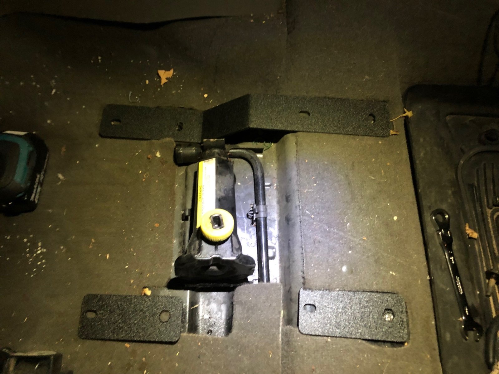

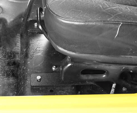

Well, I started installing the passenger seat last night, but after having a bolt break, I decided to wait until the weekend to finish up since the project went beyond what I was willing to deal with for a weeknight project. However, I at least figured out how the kit is designed to work. Each seat uses one of the long brackets, which should go across the section with the torx bolt (the kit uses your existing bolts and supplies additional ones for the extension). The smaller plates with the hex-shaped holes fit by sitting on top of the 13 mm bolts on one side as shown in the second pic.
I'm a bit skeptical at this point as to how sturdy this will be, but I'll post again later once I have time to deal with the broken bolt and get a replacement from the hardware store.

Those two plates can't be all that holds that entire side of the seat on? That does not look safe. Are you sure those extra four plates aren't for both sides and that you need two complete sets to do both seats? Someone in the reviews said you need two sets to do both seats.
It looks like your trying to use one set to do both seats. I can't believe they don't provide instructions. Seems like a liability.

My guess is that those plates sit under the front and rear of the long plates (hex holes pointing towards the rear) to make space and capture the head of the new bolts coming up from the bottom that hold the seat to the bracket. The Misch brackets use carriage bolts in those locations since there is no room for a wrench.
It’s always the little jobs that make you want to scream!
Yeah, I’m thinking that kit is for one seat. I thought the tabs might be for bracing underneath but capturing the hardware might be the intended purpose.
Yup, definitely the case here. I finally got the broken bolt out, thanks to my neighbor with a welder, but the bracket doesn't seem to fit with the passenger seat. The issue is the long brackets either put the rear bolts too far apart, or if you swap them, they won't match up with the original holes in the Jeep.
This kit might work for the driver's seat, but I was primarily looking to adjust the passenger seat. However, even if the brackets will fit for the driver's side, they still don't take into account the larger Torx bolt and will require at least some drilling to work.
Either way, at this point, I can see why you can't buy this from the original seller's website anymore. Guess I'll have to throw some extra cash out and get the get the Misch bracket.
