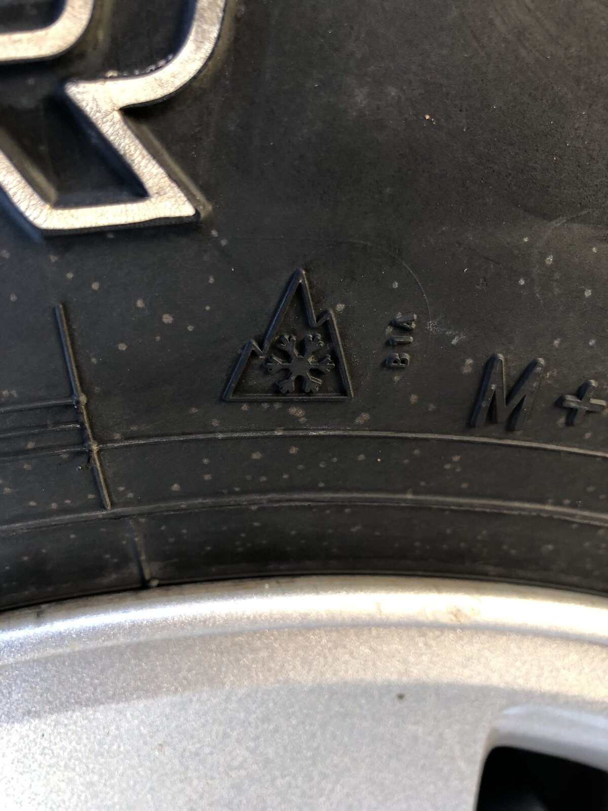

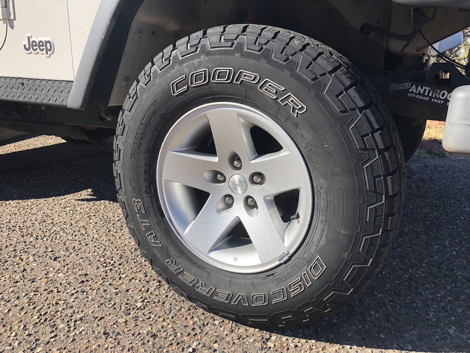

I have the Cooper Discoverer AT3 LTs on my Rubicon in 265/75/16, load range C. They ride fine, have good grip, and snow rated. The best part though? They are silent as death. I don’t hear any noise coming from these tires, even at freeway speess. FYI.
