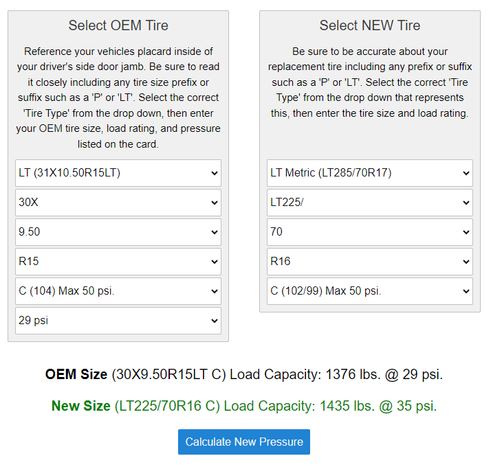

Fellas, I got a crazy update. I used tiresize.com's air pressure calculator and the calculator's math says: With factory door sticker showing 30x9.5x15 at 29psi, run 225x70r16 load range C at 35psi.
Contrary to the advice all over this forum and others, I aired back up to 33 psi cold from 25 psi cold.
I shit you not, it rides significantly smoother on ALL terrain including street, potholes, gravel, and most importantly giant deep muddy puddles at speed. Cannot make this stuff up. No more tooth rattling over seams in the street, and bumps/holes deliver a firm and confident bounce back as I'd expect from a TJ.
It was a great lesson in math beating anecdotes every time. Guessing it is because these tires are smaller than what most people online are running at 25psi or less. Whatever the case, I appreciate you fine folks entertaining this insanity. Anyone interested in a PNW TJ meetup let's do it!
Glad you figured it out, but I'm curious: does your 2000 sticker actually have a 30 size on it? Maybe you have a special edition or Rubicon? If not, it should be P215/75R15 (Sport), P205/75R15 (SE), or P225/70R16 (Sahara).
