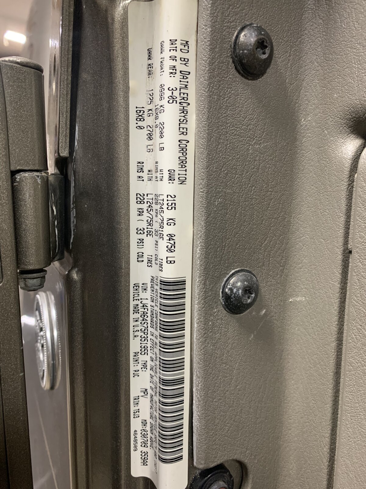

Man am I more confused than ever. I have a 2006 Rubicon Unlimited and I have at least one bad tire. The tires on it now are Toyo MT Open Country (on it when I bought it). I have read and studied what wisdom I could glean from this group. I’ve been looking at the very limited selection of load C tires that I could find and had determined that I would have to go up a size (from 245/75/16 to 265/75/16) to get a load C tire. I completely understand the logic in what I have read on this forum about load E vs load C. Then today I decided to check my door jam (before I ordered 5 tires) to see what was the factory size. I had determined in my mind from everything that I have read that it would be a 245/75/16 C. I didn’t read that anywhere here, I had just determined it in my mind after everything that I have read here. Why in the hell did these vehicles come with E rated tires, if that is not the best tire to run on these vehicles?
