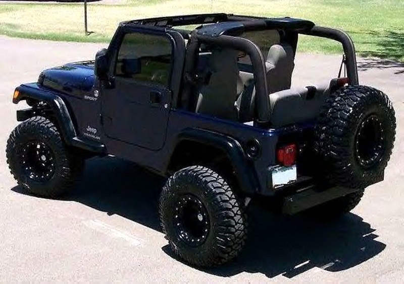

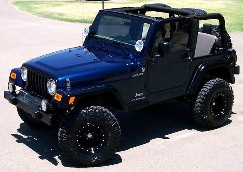

Thanks that was some good info. I plan on going with the Clayton 4ā€ which has 8 arms. I’ll do a SYE. Gears and other modifications if needed and keep it to 33’s.
If you’re going to go with a 4 inch lift and SYE, you might as well add a 1ā€ body lift and target 35s when you regear. Some 3 inch lifts will net you enough to run 33s. With a 4 inch and all that’s involved I would shoot for 35.
Reactions: Moglocker
So your first post you said you didn’t want to spend when you don’t have to.
Folks tried to show how you can split the difference, not spend a ton but get your goals.
If this later post is your position, ā€œI’d like 4ā€ suspension and be ready for 35’sā€. Then ok, you absolutely won’t be saving a few coins…..if you do it right as you suggested.
You’ll need all 8 Arms at 4ā€ lift, if doing it right.
You’ll need a SYE or SSSYE,
You’ll need Axle upgrades and gearing upgrade
You’ll need a new driveshaft rear, possibly front but doubt it.
You’ll need extended brake lines and most likely brake upgrades
You’ll need track bar upgrades to adjustable
