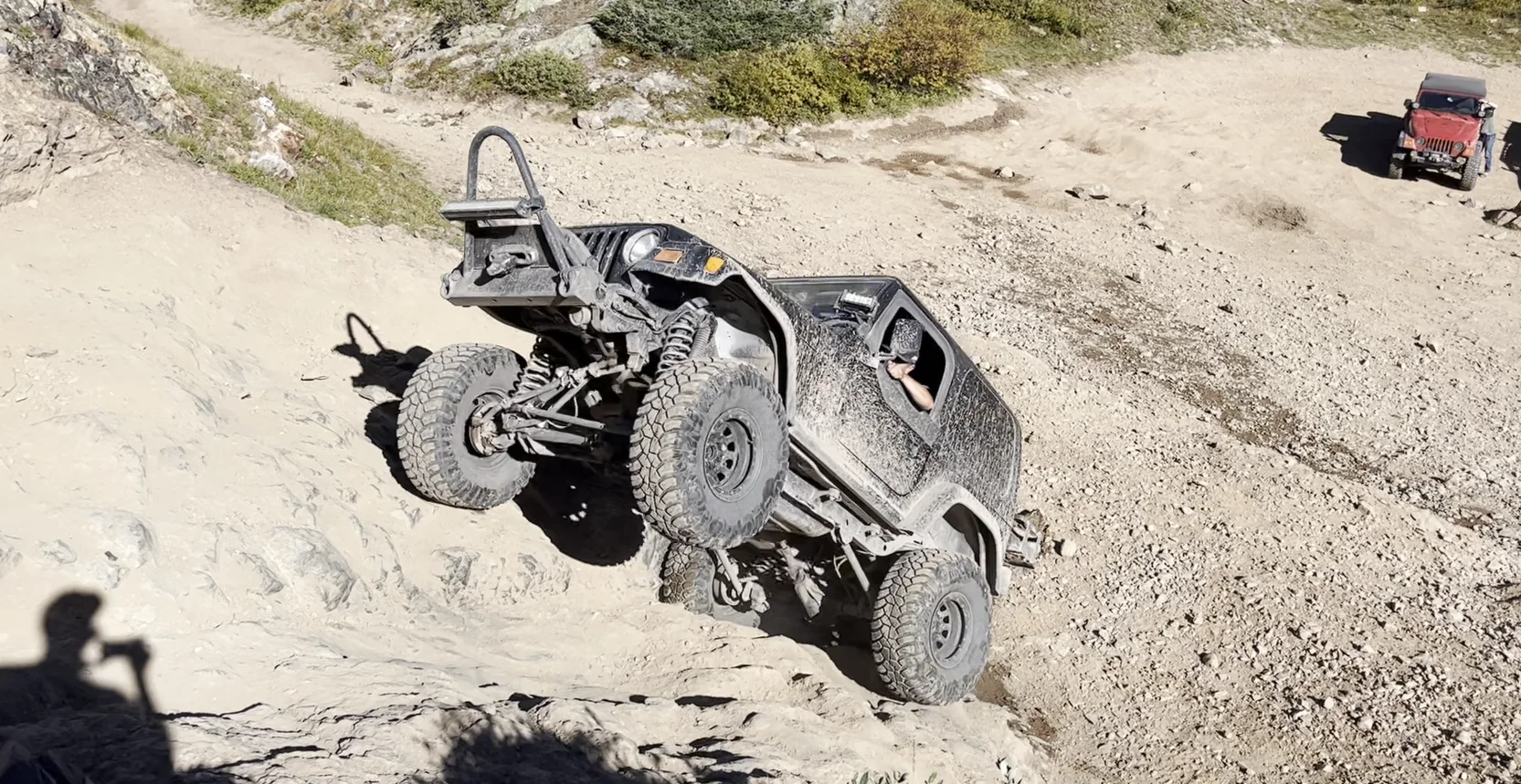

The very easy way to work through the problem is just turn right a small amount to let the left side drop and then quickly turn left and get back into it.
Does one drive forward in between turns or not?
I haven’t tried this, but it seems like turning the wheel back left without moving forward, would just put you back where you were.

I struggle to grasp why turning the wheel makes the front come down, but it’s apparent in the video.

What's going on that's making that front driver tire go up so much that would be eliminated if he straightened up?
Rear right (passenger) is sinking into a hole. Getting the front right up a bit will start to push the front left down and help lift the rear right up and out.

What's going on that's making that front driver tire go up so much that would be eliminated if he straightened up? I can't see enough of the driver front tire to see how much his uptravel is limited.
Nothing to do with uptravel. The lift is caused by too much resistance at the right front tire. It can be climbing something pretty steep or what we run into more often is the side of the tire against a flat face of a rock or similar. It is torque transfer to the chassis from the drivetrain that cause the left side to lift. If you can reduce the resistance at the right front, the left will come right down as you can see in the video.

Watch the video and the correlation between the left lift and steering angle. You can clearly define that turning right lowers the left side, turning left raises it.

Torque and resistance, nothing more. Also why there is a pretty cool way to combat the overall effect by using a reversed rotation rear output on a special transfer case.

Yes, no, maybe, depends on what the other tires are doing. But no, you aren't really turning, you are just turning the steering wheel. You can see that the right front only has to turn a couple of inches to have a dramatic effect on how much the left lifts.
We have obstacles that are basically a vertical face that the side of the tire winds up against that it really needs to climb. With the auto, you can ease into the throttle, lift the left front, repeat that to see how high you can get it and how fast it will drop if you get off the throttle quickly. After a few tests, then you can ease it way up high, give it a tiny bit of right turn to drop it and while it is on the way down, use the chassis's downward momentum to bump into the throttle and get the right front to climb. As soon as it does, get back left and continue on.

Little bits of momentum, a feel for what it is doing, and the awareness that just a tiny bit of right or just lowering the force on the right front by easing the steering wheel to the right a small bit all helps to learn what the rig can do and how to stay out of trouble. Myself and a fair number of the folks I wheel with wouldn't even slow down much through that spot in the video. As soon as the left started up, we'd ease back right until it dropped, back left and drive right through it.

Not always, but it is also very common to lift the left front just going straight up a climb when the right front meets resistance. A way to visualize the forces is to contemplate a Jeep hanging straight up and down fully suspended by a winch cable from the front bumper. You could walk up to it and rotate it around the cable easily with one hand. Same rig sitting flat on level ground on the tires and you'd be hard pressed to dislocate one side more than an inch or so lifting with one hand in the middle of it.
As the chassis moves further from flat in the front, the less force it takes to rotate it.

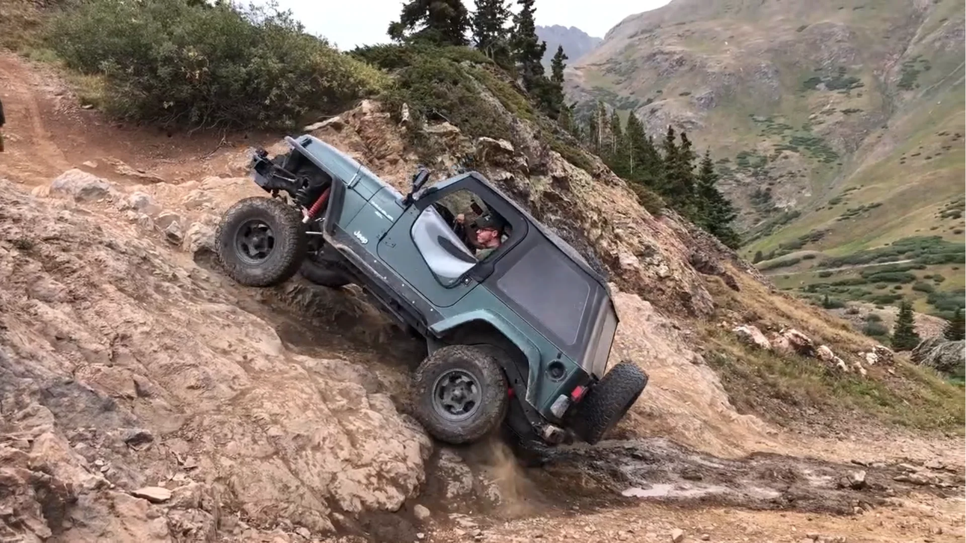

Went back and watched the video of the first time I encountered this in July 2019...I had the wheels turned a little bit passenger and all four on the ground, left tire didn't lift until I turned left. I just hit the dump button (clutch) and backed out of it and took another line, carried a little momentum and walked right up it.
What's really interesting is what I wrote in the description when I posted it...apparently I was at least somewhat aware of the right vs left thing but hadn't processed it enough to remember it when you started this thread.

Here's me doing it again in 2020, this time with a rear E-Locker engaged but still open front. Wheels look pretty much straight but I never tried turning right since making passenger climb even more seemed counterintuitive in the moment.
and here's my buddy Alex doing it on the same obstacle in 2022. He actually bounced it high enough that the right tire came off the ground as well, as we all collectively skipped a heartbeat and he soiled his pants. He has a detroit locker in the rear and a truetrac in the front, also longarms.
All three of my examples were with the right rear tire in a hole with an abundance of grip.

in my specific examples, bad line selection as I had figured out getting my front axle to follow my chosen line but not so good with the rear. When follow-up attempts were successful, they involved staying out of the hole. I haven't had this happen in a while because I intentionally avoid putting specifically my right rear tire in a hole, moreso than any of the others. I'm certain at some point I'll find a scenario where it's unavoidable though, and before this thread I'd probably have ended up winching through after a couple of failed attempts, but now I have a new tool in my belt.
