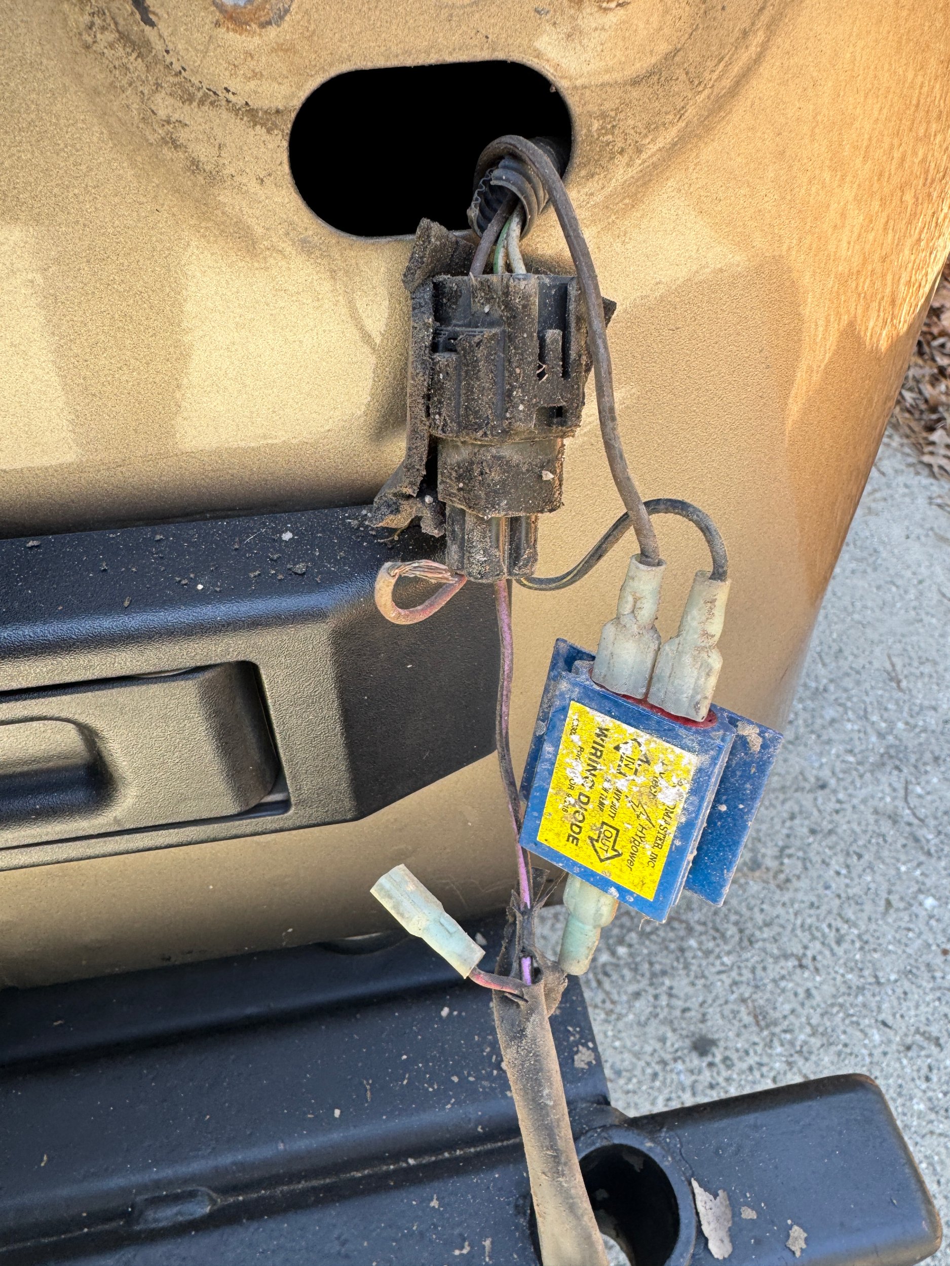

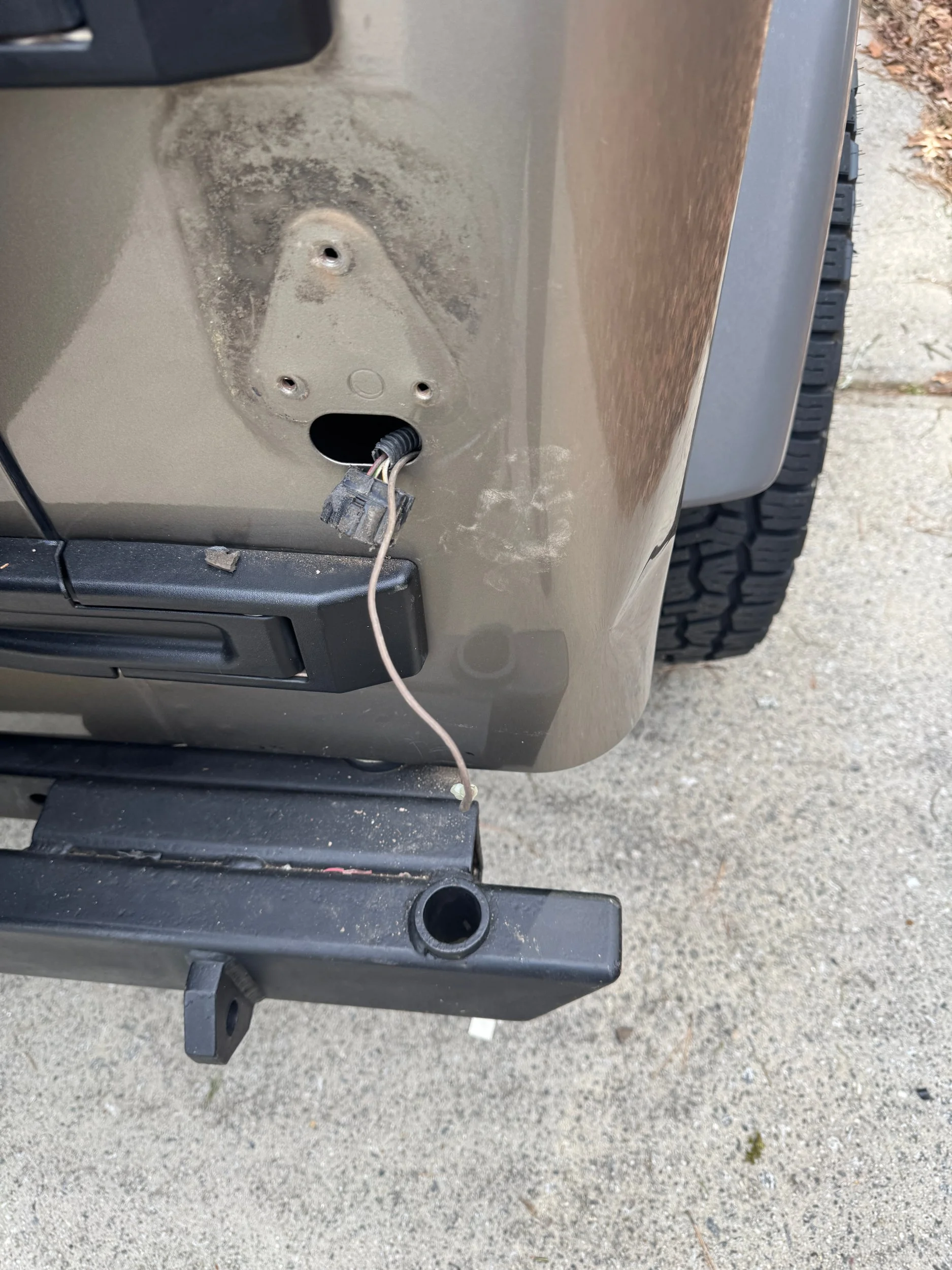

Another though, if you have a trailer light connector follow it to where they connected it and inspect the wiring. The tail light wiring can be accessed by removing the plastic push nails and pulling down the plastic fender liner under the tail light.
I do and I will, thanks!
@B1Toad

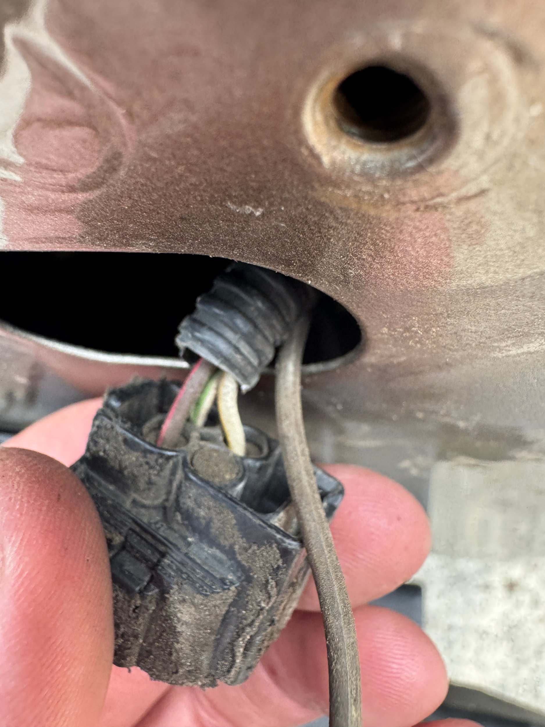

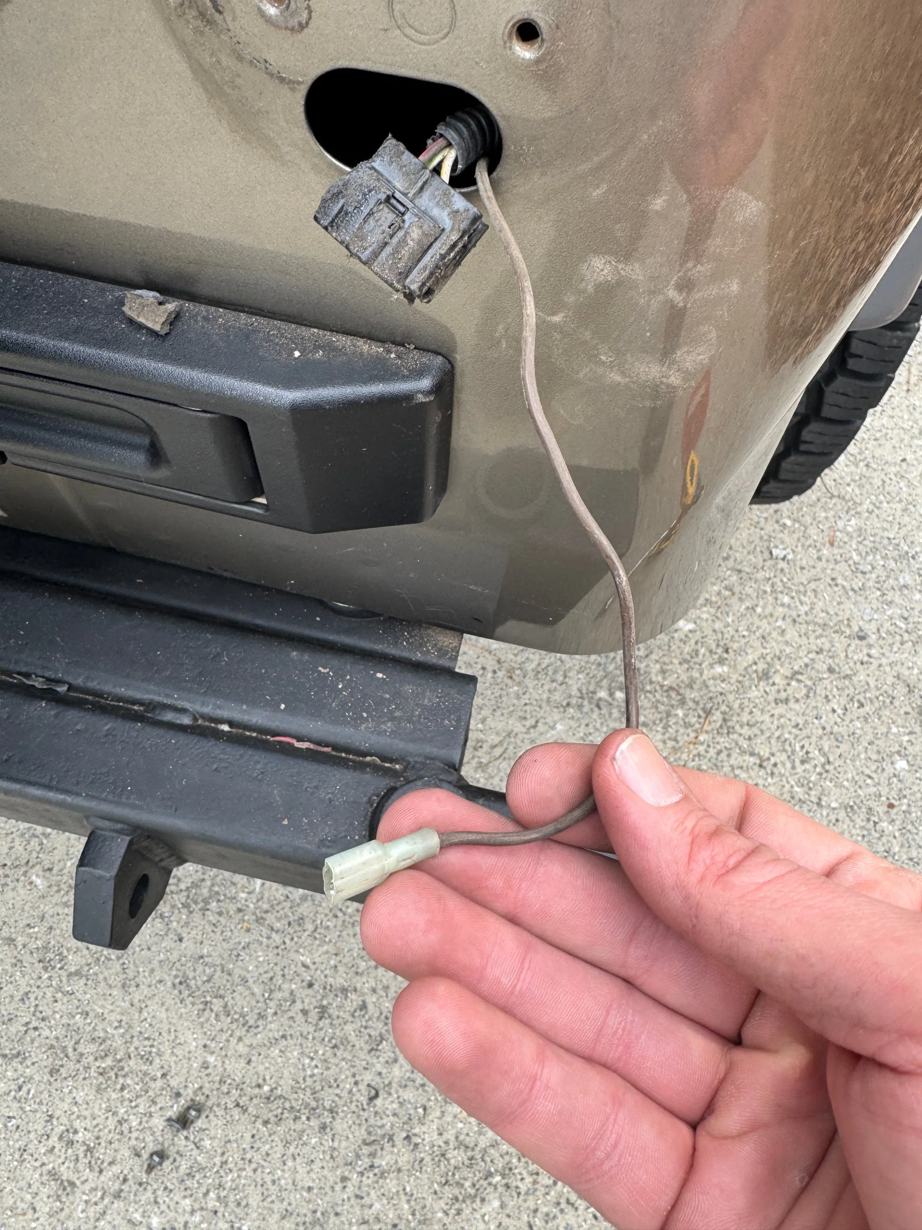

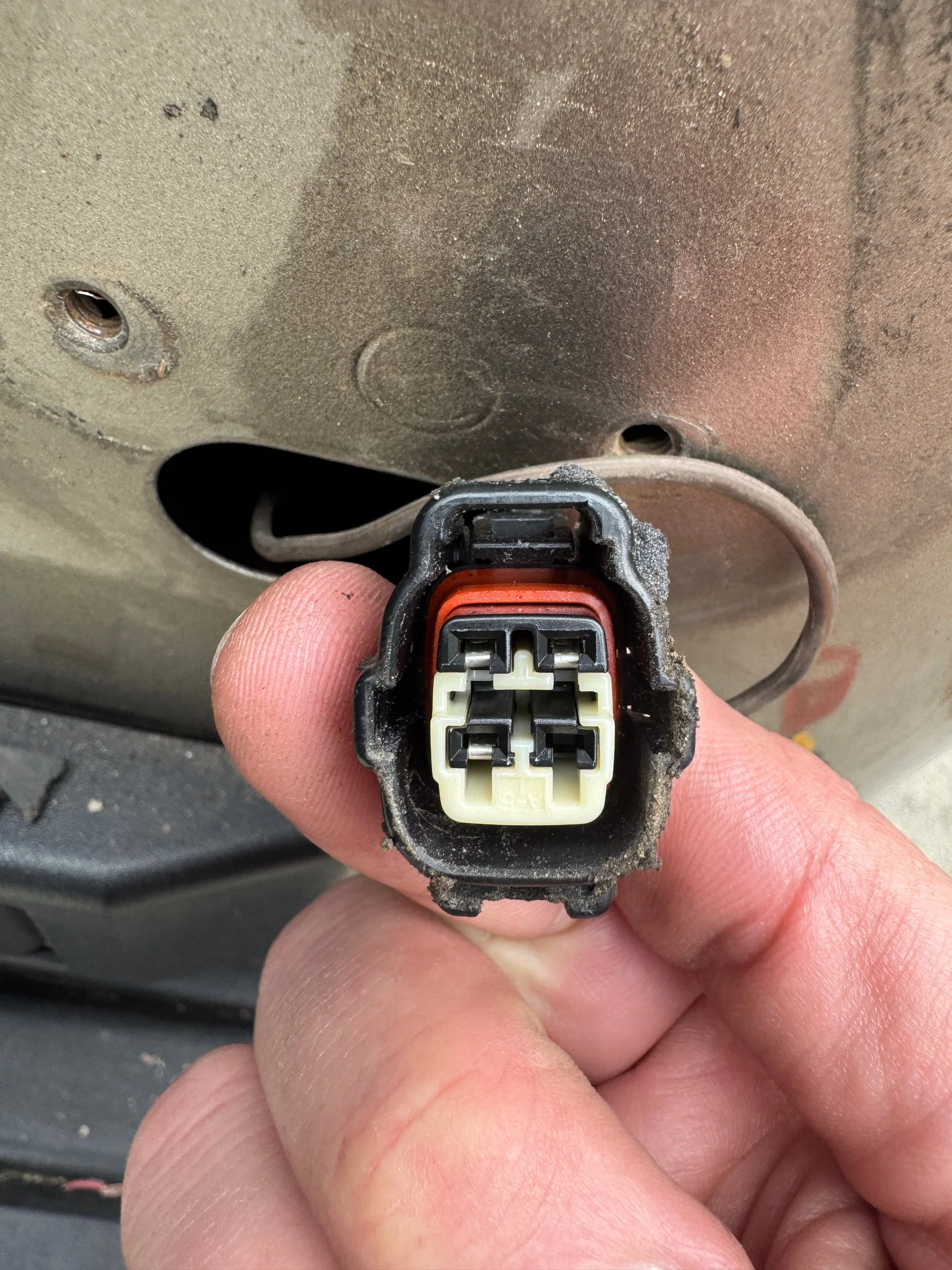

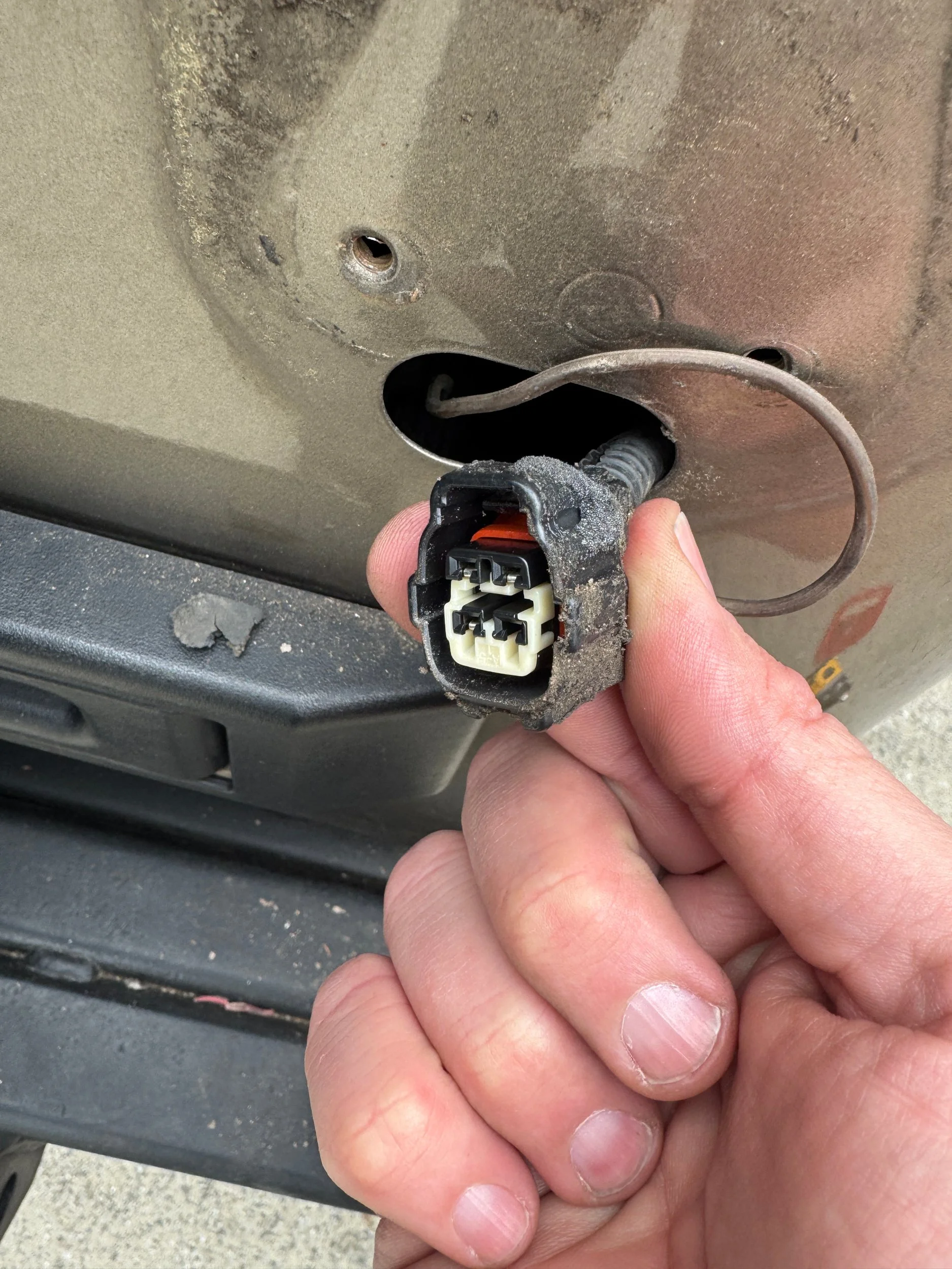

The fuses checked out, cleaned the bulb connectors, bought all new LED bulbs with a LM470 Flasher Relay and installed those--which corrected the super fast blinking when the Right turn signal was engaged. The things that still didn't work were the Right brake light, Right Turn Signal, and the Right Flasher. I took the assembly off of the body and what you see attached is what I saw. I'm far from an expert here but I don't think whatever is going on is "normal"...but maybe it is? The one exposed cut and frayed Red cable probably needs to go somewhere....but I have no idea where to start.
Seriously considering just taking it to a shop and getting LED assemblies and be done with it. Any thoughts?

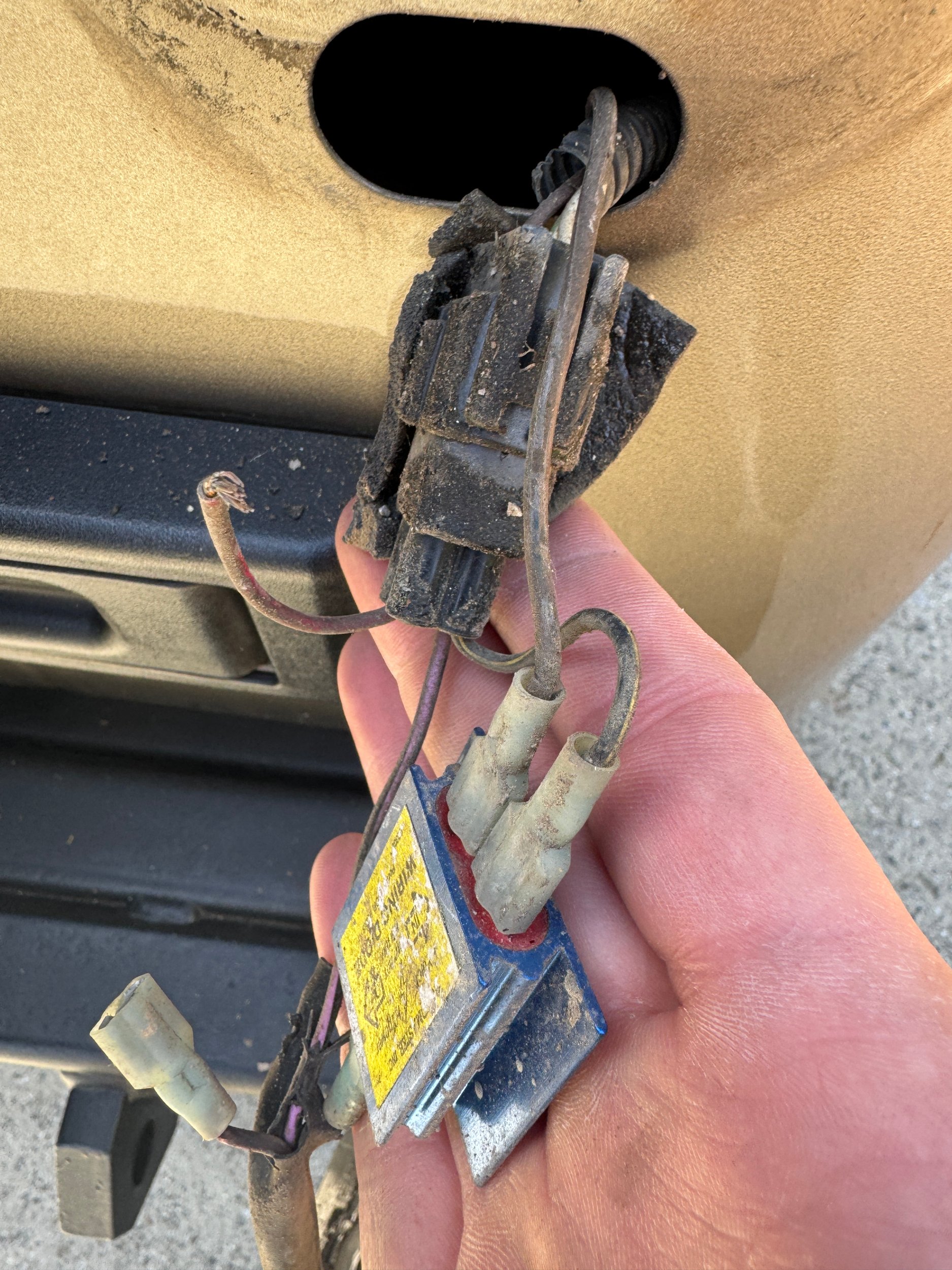

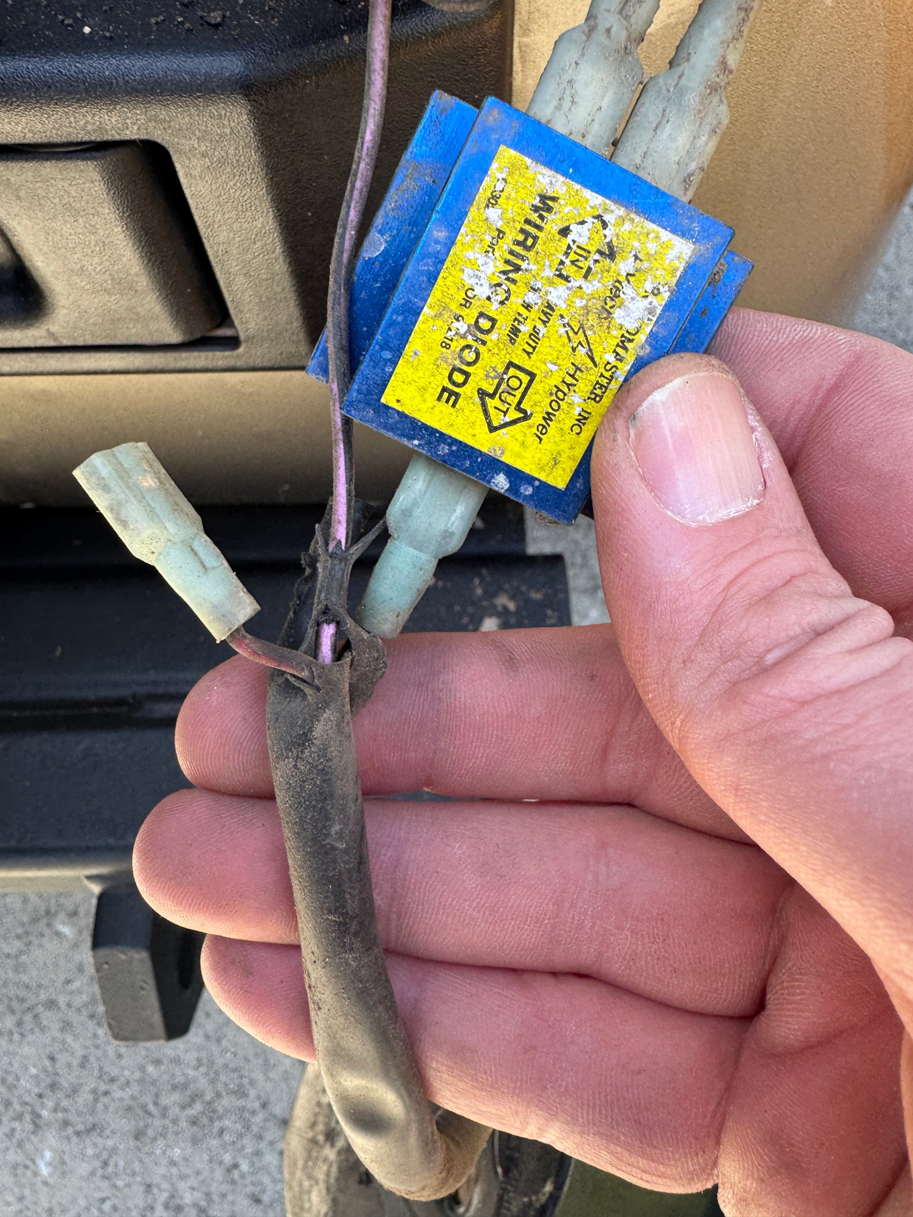

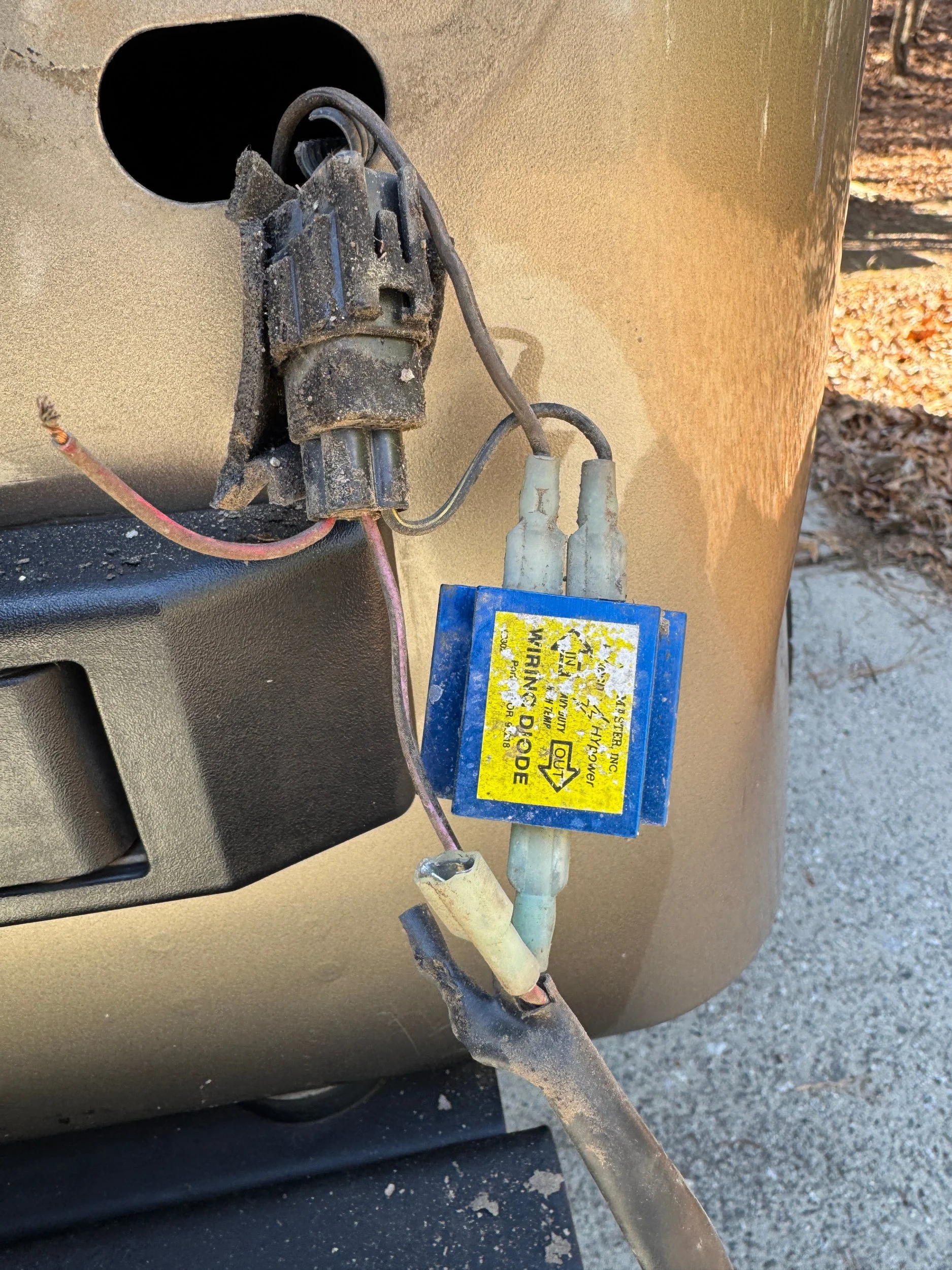

That's a diode kit that was installed for towing the Jeep behind a motorhome. I think your choices are to re-connect the wire that came undone or eliminate the diode kit completely.
I'm assuming that red wire that is cut connects to the one with the white plastic connector?
BINGO! We are in business. Everything is working as it should after I removed that contraption and connected the wires with its mate. There was one wire that didnt have a home...and its still homeless, but once I put the three mounting bolts of the assembly back in to the body and grounded it they all fired up nicely. Lets just hope my twist nut connectors stay fastened as I didnt have much wire to play with. Thank you @B1Toad!!
I wouldn't consider twist on wire nuts as a permanent fix on a vehicle that is subject to movement/vibration/weather. There are butt connectors and heat shrink or even solder seal butt connectors that work with a heat gun that will be better than wire nuts.

Not sure, maybe the floating white connector is suppose to plug into the diode. You did say everything works now though? Do both reverse lights work?
There are probably 3 more diode modules on your Jeep. I believe this is the one you have: https://www.etrailer.com/Flat-Tow-W...M-154.html?hhyear=2005&hhmake=Jeep&hhmodel=TJ
