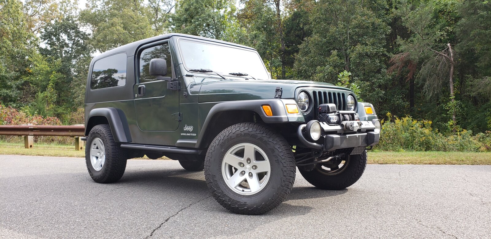

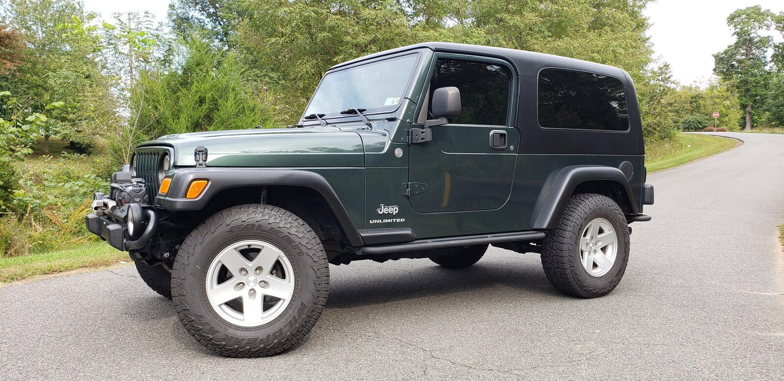

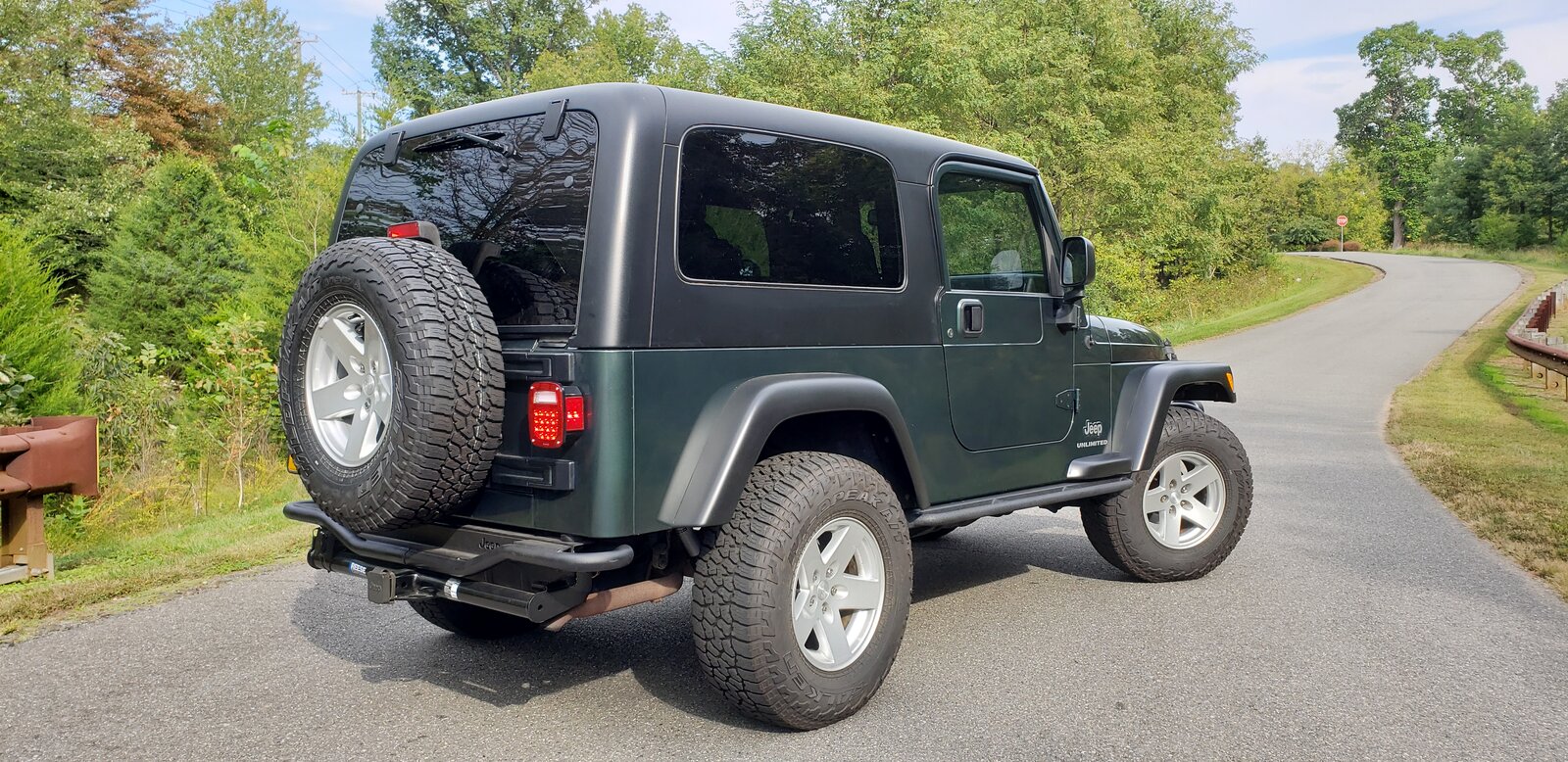

This one is like an unplanned child, it just happened, and I'm going to love it anyway! That said, let's get started with the details! This Shale Green 2004 LJ, one of 309, was most recently owned by another forum member
@jwilson2899 (Jeff). Before that, by a Nurse in Winchester, VA. Under Jeff's ownership he made some tasteful additions that were focused on creating a comfortable daily driver. Since this was a fairly stripped down model, with a single note horn, soft top, full doors, and A/C, Jeff added the following under his ownership:
- Color matched 1/2 doors, with mirrors
- Tinted full door windows
- Hard top, headlined and wired in for the wiper and defroster controls

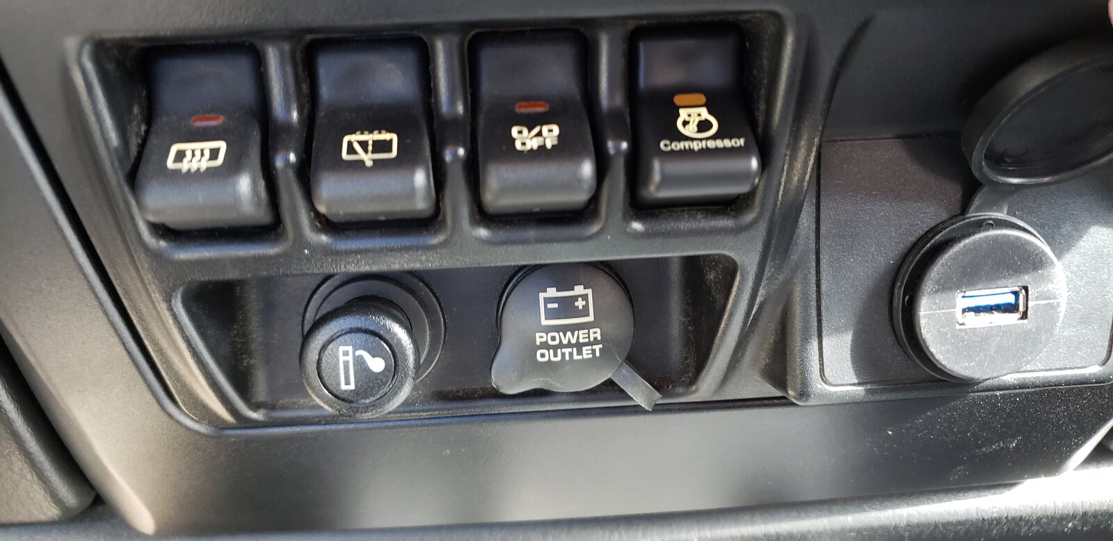

- Factory Cruise Control
- Rubicon flares

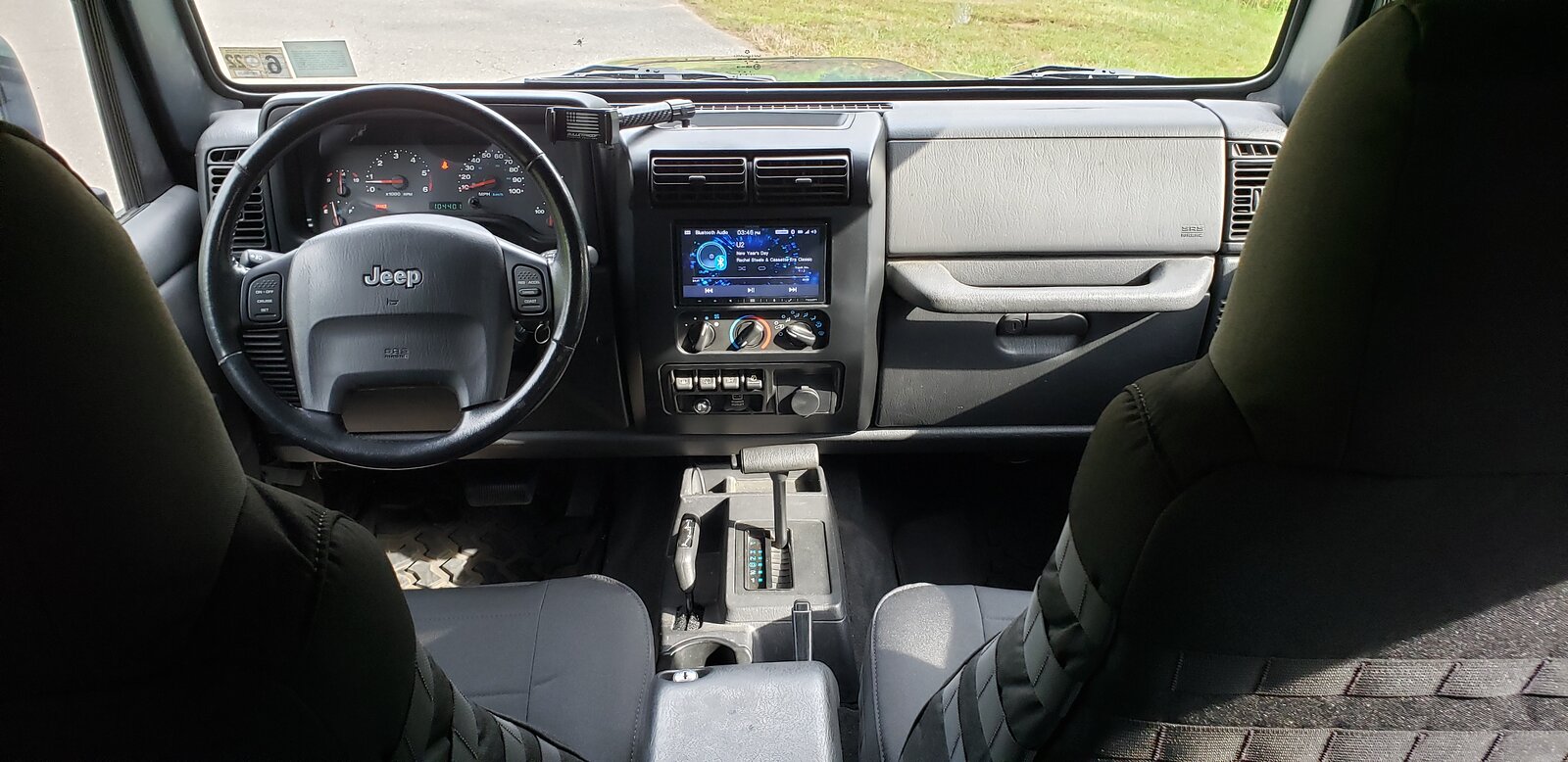

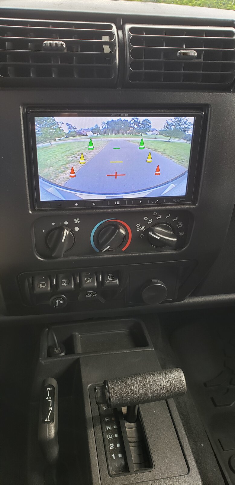

- Alpine Double DIN Stereo and backup camera
- Subwoofer
- LED headlights and tail lights
- LED dash and interior lights
- JK-based (I think?) back seat, with built-in headrests

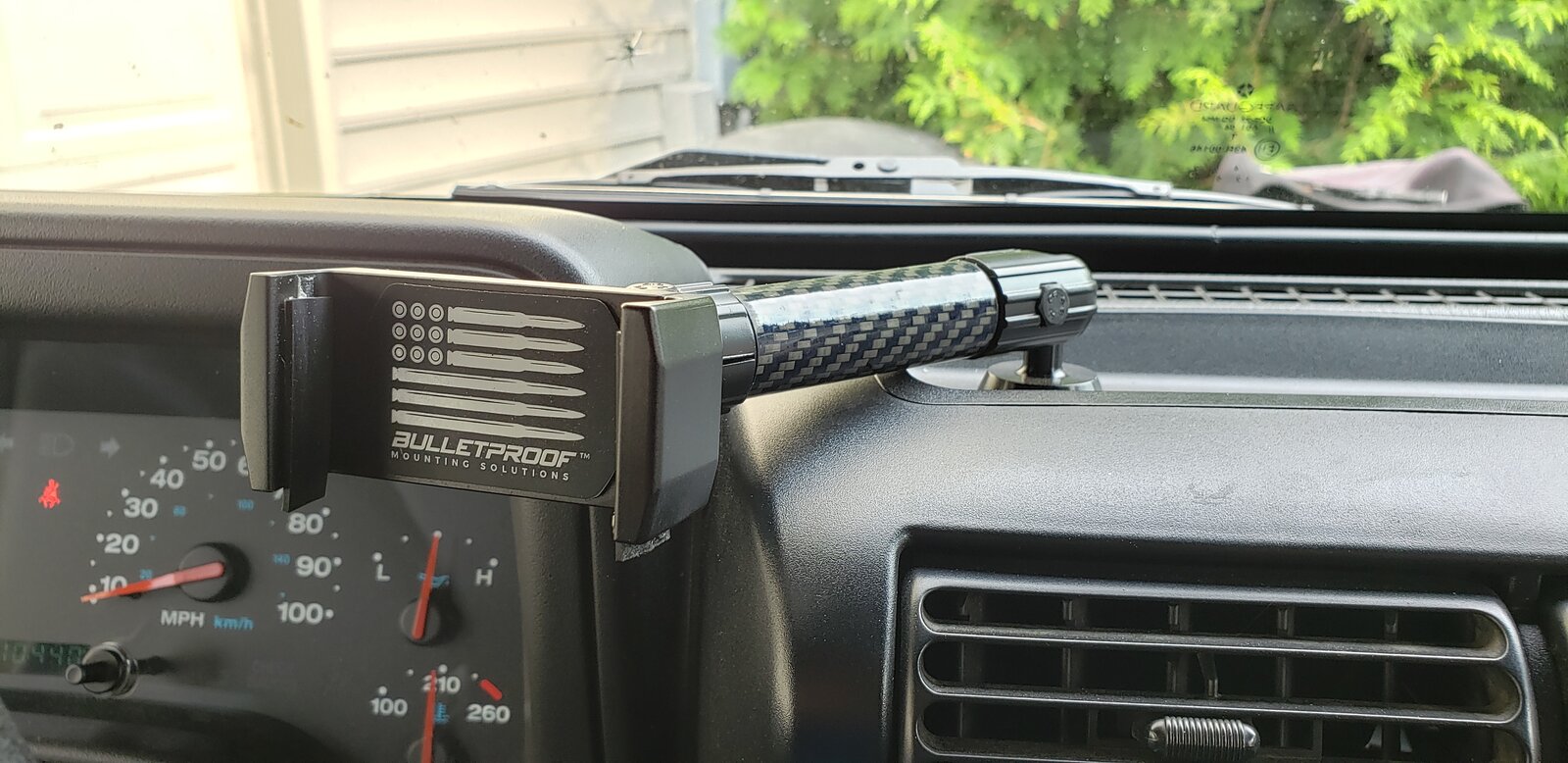

- BulletPoint cell phone mount
- Bartact front and rear set covers
- Quadratech floor and cargo mats
- Rocker rails/steps

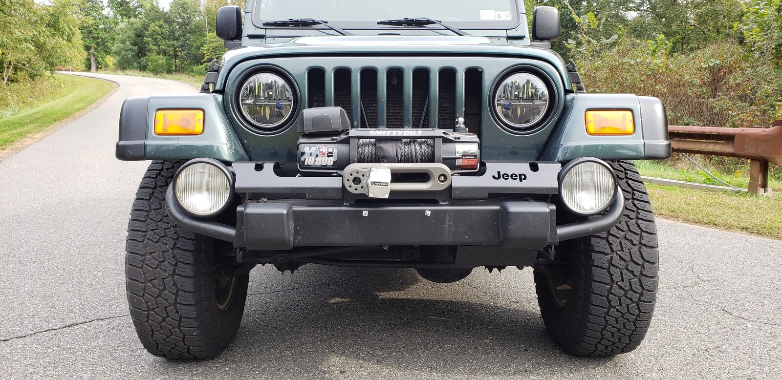

- Mopar AEV RockCrawler Front and Rear bumpers
- Smittybuilt 10k Winch with Factor 55 Fairlead and Flatlink
- 2" lift
- Sock Moab wheels
- Falken Wildpeak AT3 tires 265/75R16 (SL)
- ZJ steering upgrade

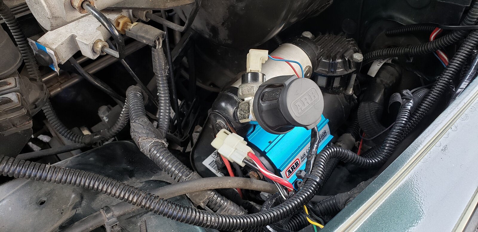

- Single ARB compressor (under the hood)

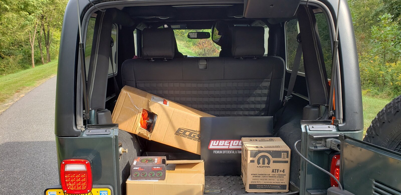

At sale time, Jeff also included a few uninstalled parts, including:
- Parts for adding a transmission cooler and temperature gauge
- East Coast Gear Supply 4340 rear Dana 44 axles
