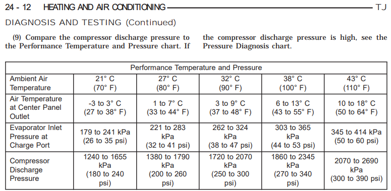

I did do the math a while back for the TJ, and in order to approach the LEL with the system running (high fan speed) and windows closed, the entire contents of the system have to leak out of the evaporator in less than 8 minutes. (Note an evaporator leak of that rate is exceptionally unlikely, especially given the evaporator is on the low pressure side.) With the vehicle stopped and no fan, it would actually exceed the UEL, but you would know something was wrong as soon as you opened the door and smelled the mercaptan.
