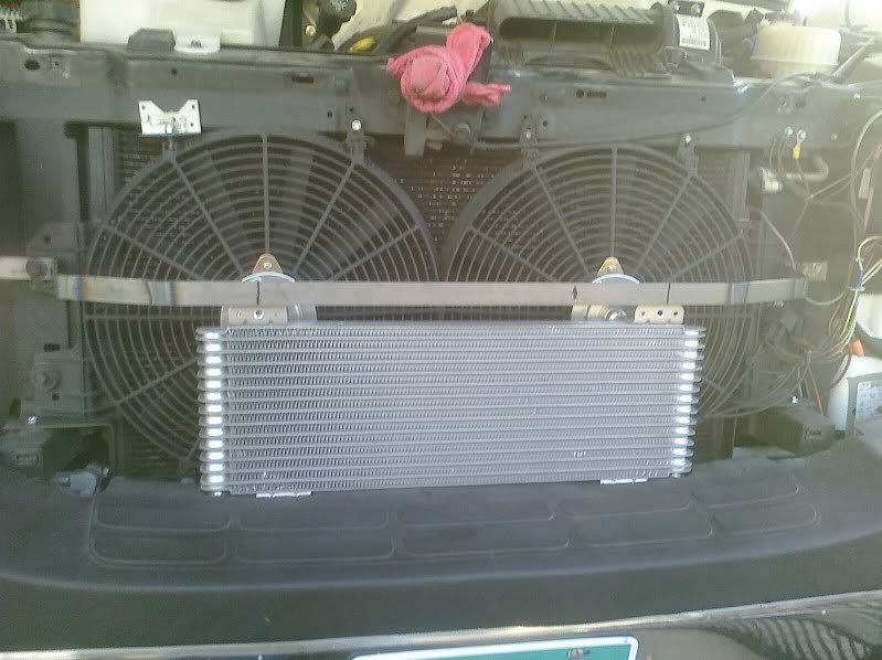

Mercedes does that on some of their models. I had a Chevy Express 3500 that I installed two 15" Permacool (pusher) condenser fans on. They were not thermostatically or pressure switch controlled, I just connected them to come on when the AC was on with an aux kill switch for winter defrost mode. I could sit at idle for unlimited periods with ice cold air blasting on me. This is important for a work van because the cab is your office and your lunch room. With both running it sounded like angry bees outside the van.
I also added the big transmission cooler which saved my transmission from early failure as is common on those vans.
Too bad we don't have room for condenser fans on a TJ.

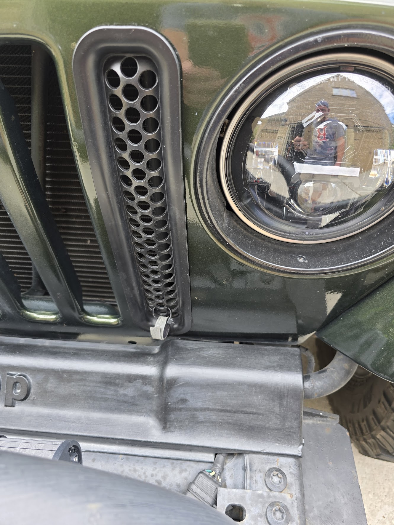

For anyone with these on their Jeep, I wanted to share this information. My AC is now at least 30% colder after removing these from the grill. View attachment 644215View attachment 644216
I took those off and my cooling and AC went from marginal to excellent. This is after all the reading I did where people said if those inserts affect your cooling, you have something else wrong which is why it took me so long to remove them as my entire system was fresh with factory parts including a new Mopar radiator, Mopar water pump, fan clutch and Flowkooler 190 thermostat but cooling was still struggling on really hot days and I'd have to shut the AC off at long red lights and drive up windows to keep it from hitting 225F. Even my block was clean only having under 20,000 miles on a total rebuild. I had chalked it up to poor design and was considering an upgrade like the Explorer setup.
Then I happened to remove only one insert to see about installing a hood lock and noticed later that day at the drive up window the temp didn't rise like usual with just one insert removed. I went straight home and removed all of them and never looked back. I now find myself reducing the AC temp and blower speed after a bit, it gets downright chilly in that little cabin. It also now stays cool when sitting and never boils into the overflow anymore after shut down. Temps are now normal at idle and at speed, and I like the look better with that junk removed. I've been testing it all Summer in Arizona desert temps, never once has it got hot enough to concern me, and I can leave the AC on as long as I like. I only wish I had done it sooner.
