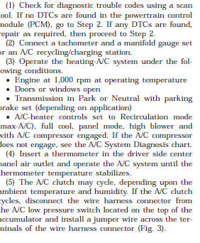

The jumper test is real simple cause they’re 2 wire switches. Paper clip or scrap wire will make it easy to test.
Mine was cycling on and off every 2-3 minutes so the compressor never ran long enough to keep the air properly cold. It was hitting the pressure shutoff before it could do any good.
Now, I freeze. I can get it cold enough to turn the air down to the first speed on a 95 degree southeast Texas day if I drive it long enough. Huge win!

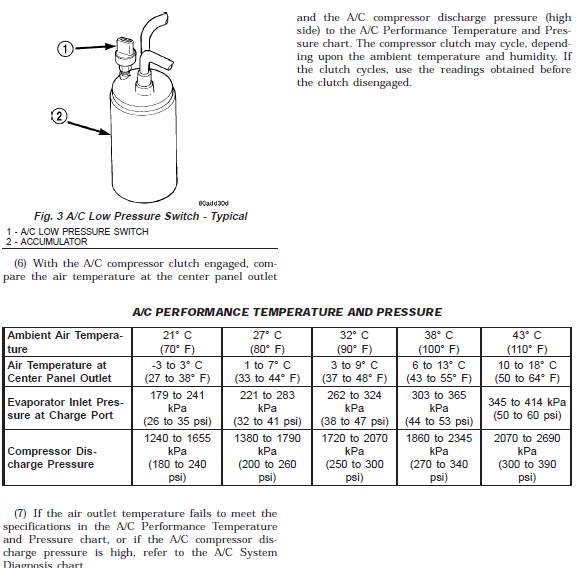

So I used the vacuum pump on the A/C system and It held vacuum and I ran the pump for an hour and it sat for another hour for leaks but it was solid. I then proceeded to fill the system and it seems to blow cold but this is with the temp gauge in the center vents. It seems like it could get better than this...
When you say "fill the system" how did you determine the system was full? Is it possible it just needs a bit more refrigerant?
Also, what was the outside temperature when you had that center vent thermometer reading? If the ambient temperature was much over 90, it's possible that was within spec for the ambient temperature per the chart in the factory manual.
https://wranglertjforum.com/attachments/1999-tj-service-manual-pdf.14034/
I have gauges that I use with the vacuum system and outside temp was 75 while taking the reading from the vent
