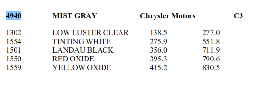

The paint trim code (C3) for my '98 TJ prescribed Mist Gray so check that first. The matching SEM custom color is SEM #4940 (Chrysler) using SEM's color chart linked below & clipped for easy reference. Vinyl Pro used SEM's #15993 (universal) spray can color coat to mix the color. I purchased two cans totaling about $85 including shipping which I thought to be pricey back in Feb '22.
Results: I found the paint color to be a tinge darker than other areas of the interior and original door panels. Keep in mind that we are talking about 25-year-old paint which I am comparing it to. Still, it appeared very slightly darker than the original so not sure if it's because of the aforementioned aging or the Vinyl Pro mix/formula was slightly off/different. The SEM paint was VERY high quality when compared to the others I had tested. The custom color #4940 was actually a more appealing tone and, at some point, I plan to refresh the entire interior in that shade.
Alternatively, you can likely have a local SEM retailer perform the same mix (if one is nearby you) and/or color match a panel if you take it into them. I'll try to post some pics of a #4940 spray card alongside the original gray mist interior so folks can see the difference if it is discernible. Take care.
