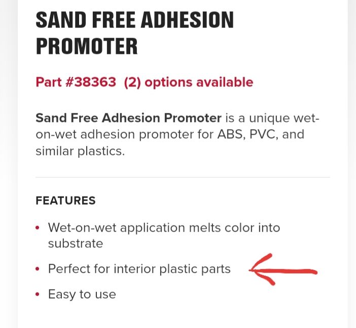

  • Sand Free, on the other hand, "softens ABS, PVC and similar plastics to promote adhesion" and "works on ABS, PVC and similar plastics" via a "wet-on-wet application [that] melts color into substrate". Says it is "perfect for interior plastic parts".
  • HOWEVER, I ordered some XXX and the front of the can says "Improves adhesion to plastics, aluminum, steel, glass, chrome, and painted surfaces." So apparently it is indeed intended for more general application than the Plastic Adhesion.
ANSWER: See here for SEM's answer, "Step 3".
