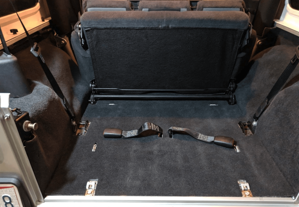

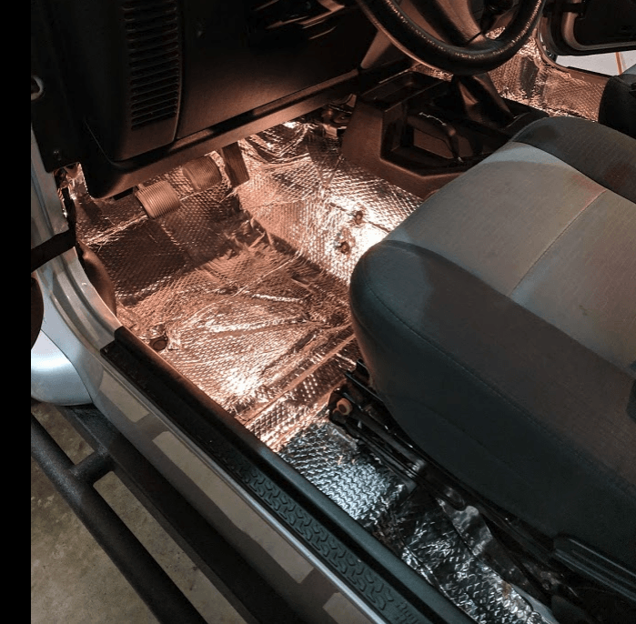

I didn't take many pics of the in-progress, but I did take a couple.
All done!

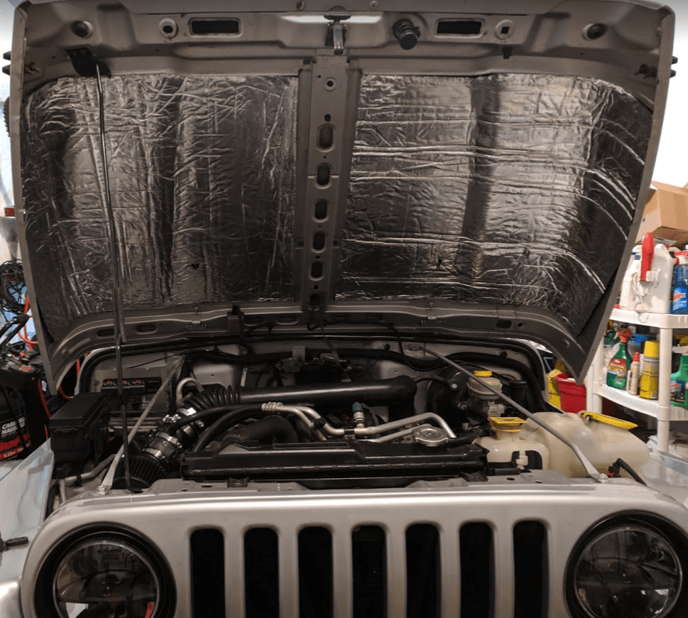

Stage 2 - Hoodliner
Since the factory didn’t install a hoodliner on most TJ’s (and the Mopar part is expense and hard to find), I wanted to install something to cut down on engine and fan noise that was bouncing around the engine bay and getting into the cabin. I found this step to be more effective (synergistic) after stage 1 was completed, thus I call it stage 2. Regardless of what some say, the Noico 80 product used in Stage 1 isn’t rated for under hood temps per the manufacturer. It is rated nicely for inside the tub with a temperature range of -49F to +212F.
Instead, I sourced the following 394 mil Car Auto Firewall Heat Sound Deadener Insulation Mat from Amazon:
https://www.amazon.com/dp/B072WKT78M/?tag=wranglerorg-20
The seller on Amazon is uxcell and the product also is listed as uxcell. But, when it arrives, the product is actually labeled as XCELL (shown on a glossy paper including instructions). The product is made in China. The quality was decent and it was easy to work with. We’ll see how it holds up over time. They don’t provide temperature ratings, but the outer cloth material is made of fiberglass. This, and the fact that others were using it for this purpose, made me feel more comfortable giving it a try.
Stage 2 Cost: $48.99 (I still have quite a bit of the 21.5 sq ft left over)
Stage 2 Notes:
  • Cut out two 28” x 28” inch pieces from the large sheet.
  • Clean the inside of the hood metal very well. I used rubbing alcohol as the last step since it evaporates quickly and does a good job lifting oily residue.
  • Don’t install over the channel/holes in the center seam of the hood. This channel appears to carry heated air to the window solvent sprayer to keep it thawed out, and may have other purposes.
  • Carefully position and trim. Tuck all ends into the edges of the hood around the perimeter. You’ll see what I mean once you see the pics and look at your hood. It takes time, but wedge it under the metal edge for a clean look.
  • Spread and roll the material flat over the contours of the hood so you don’t leave any air gaps. This will make sure the product works as well as it can and ensures that the adhesive is set as best as is possible.
  • Consider using metal clips in addition to the adhesive. I’m currently investigating clips for the long haul as I keep an eye on the adhesive over time.

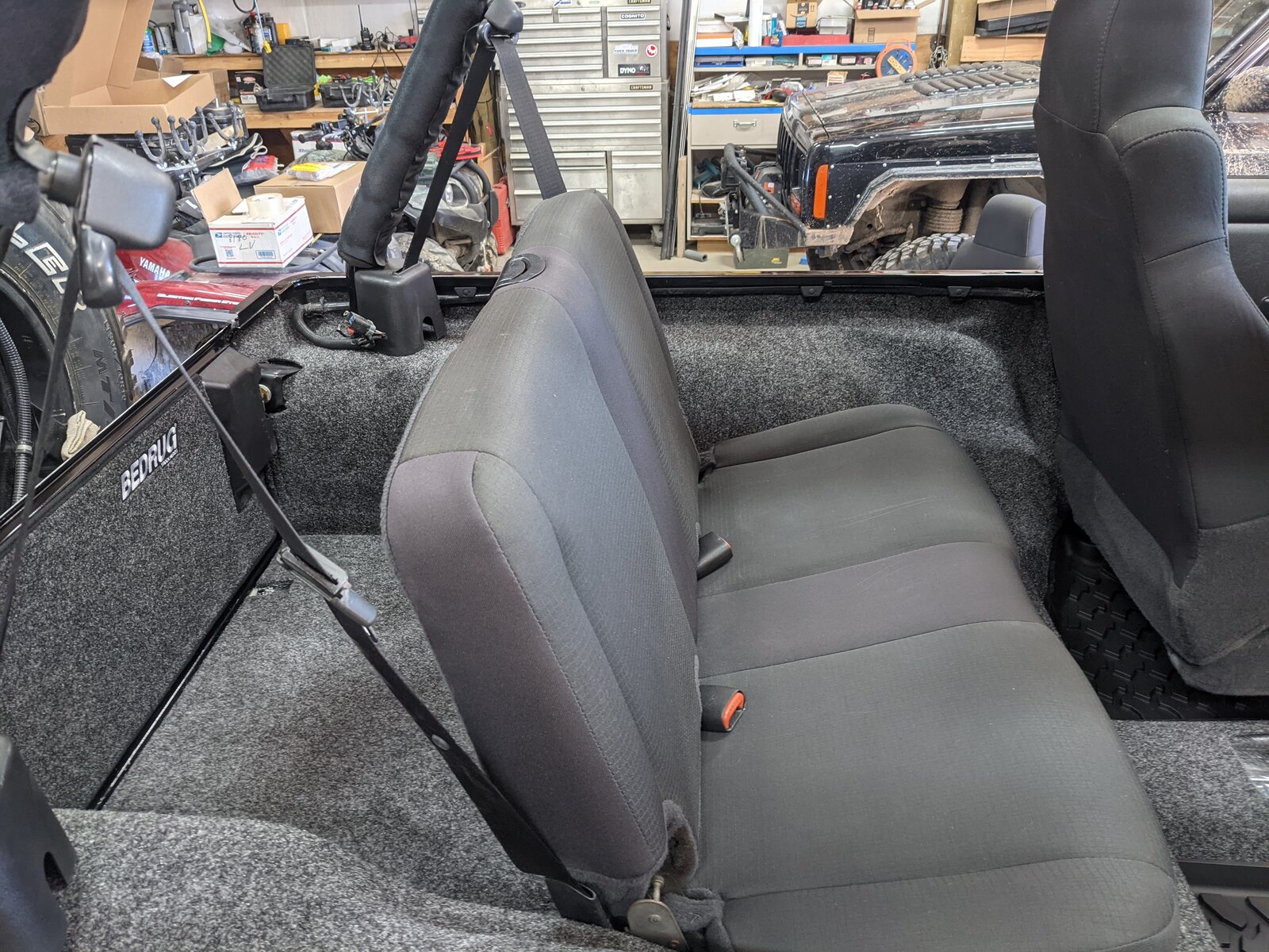

Hotheads Sound Assassin (also a heatshield) + BedRug. Took 3 days. The tub was spotless with the exception of some duct tape glue residue. There are some blanks showing in the SA but I filled them in. Very little material left for scrap if you cover everything (maybe an 8" square). As stated above, I found it easiest to use complete sheets where practical then jigsaw it together for bends and impressions, etc. The seams can be made very minimal with the pliability of the SA. Get the HD Roller and use glue remover to clean it if you get butyl on it as well as glue in tub, if any. Isoprophyl alcohol prep on all surfaces.
I've had this LJ less than a month and driven it less than 50 miles so will have no before/after impressions to report, but it has to be better with both heat and noise. And the BedRug has additional heat shield for both front driver and passenger footwells.
does the BedRug simply rest on top of the sound dampener or do you put adhesive down to attach the hook-n-loop?

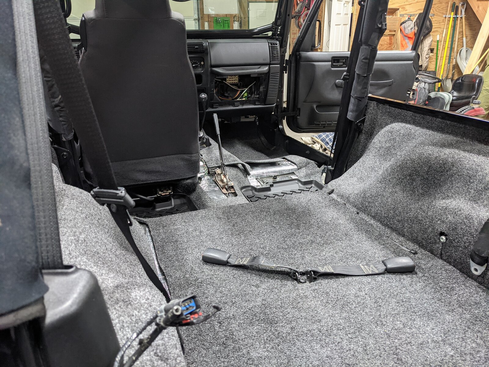

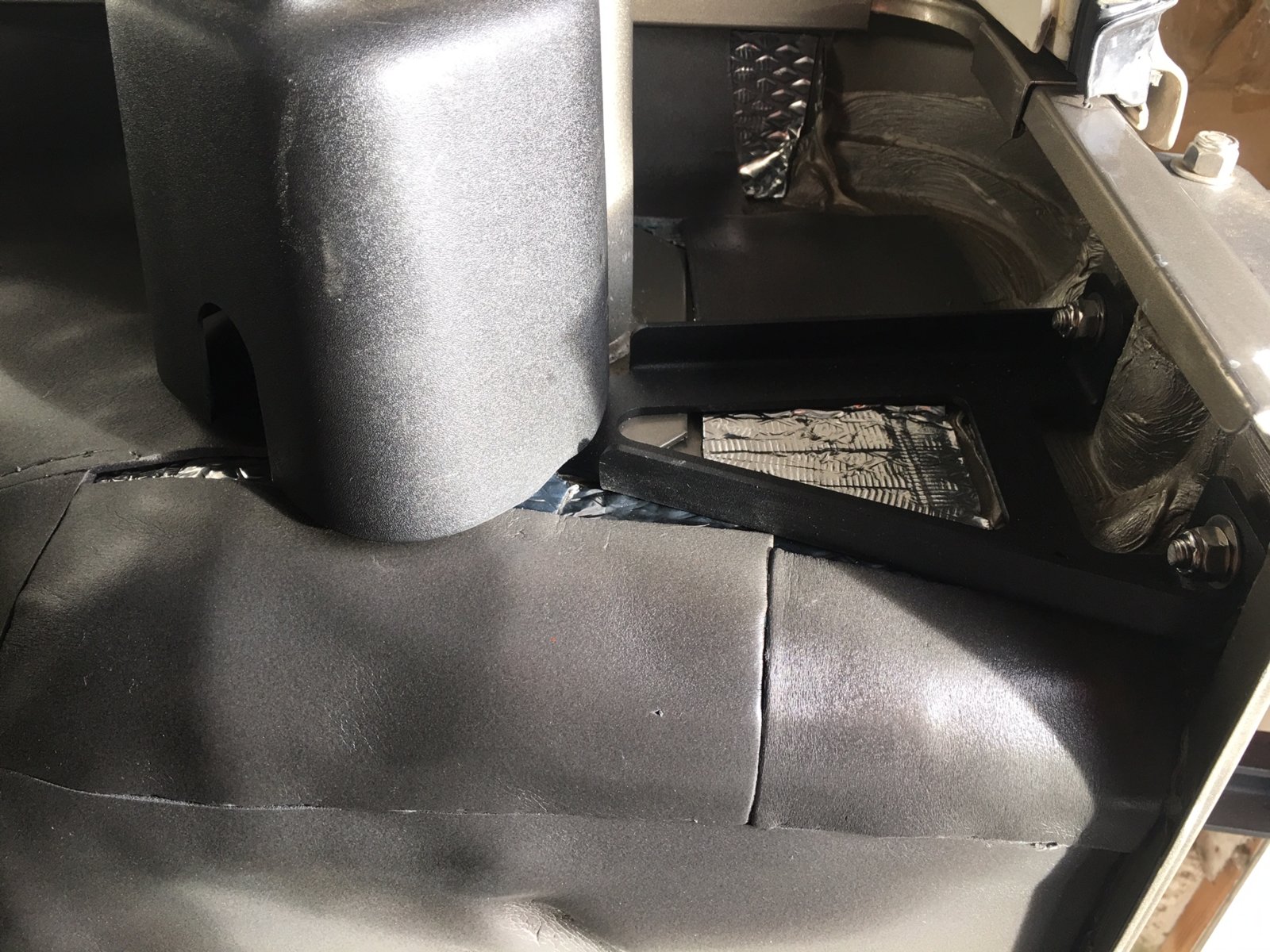

Following @mots lead, I finished insulating the rear of my TJ today.
I used the Noico 80 mil sound deadening material as the base. I went a step further than most of these other guys though and used the Noico 170 mil insulation on top of it.
Here's some photos of the finished product:
View attachment 69100View attachment 69101View attachment 69102
Tomorrow I'm going to do the front, which should hopefully be easier than the back. I'll tell you, even with as pliable as this stuff is, doing the rear was time consuming, and a pain in the butt due to the curvature of the wheel wells. I had to do a number of smaller pieces to fill in the areas that the material wouldn't easily conform to.
It looks excellent though, and with 250 mil of material, this should make the inside much, much quieter.
Chris - Sorry if this has been answered already, but what carpet/liner did you put down over this? BedRugs? If so, wondering how the fit was and if you simply laid on top (freely, without adhesion) or affixed the velcro sctrips to the second skin?
I put BedRug down over the top. I used the Velcro strips to keep it in place.
