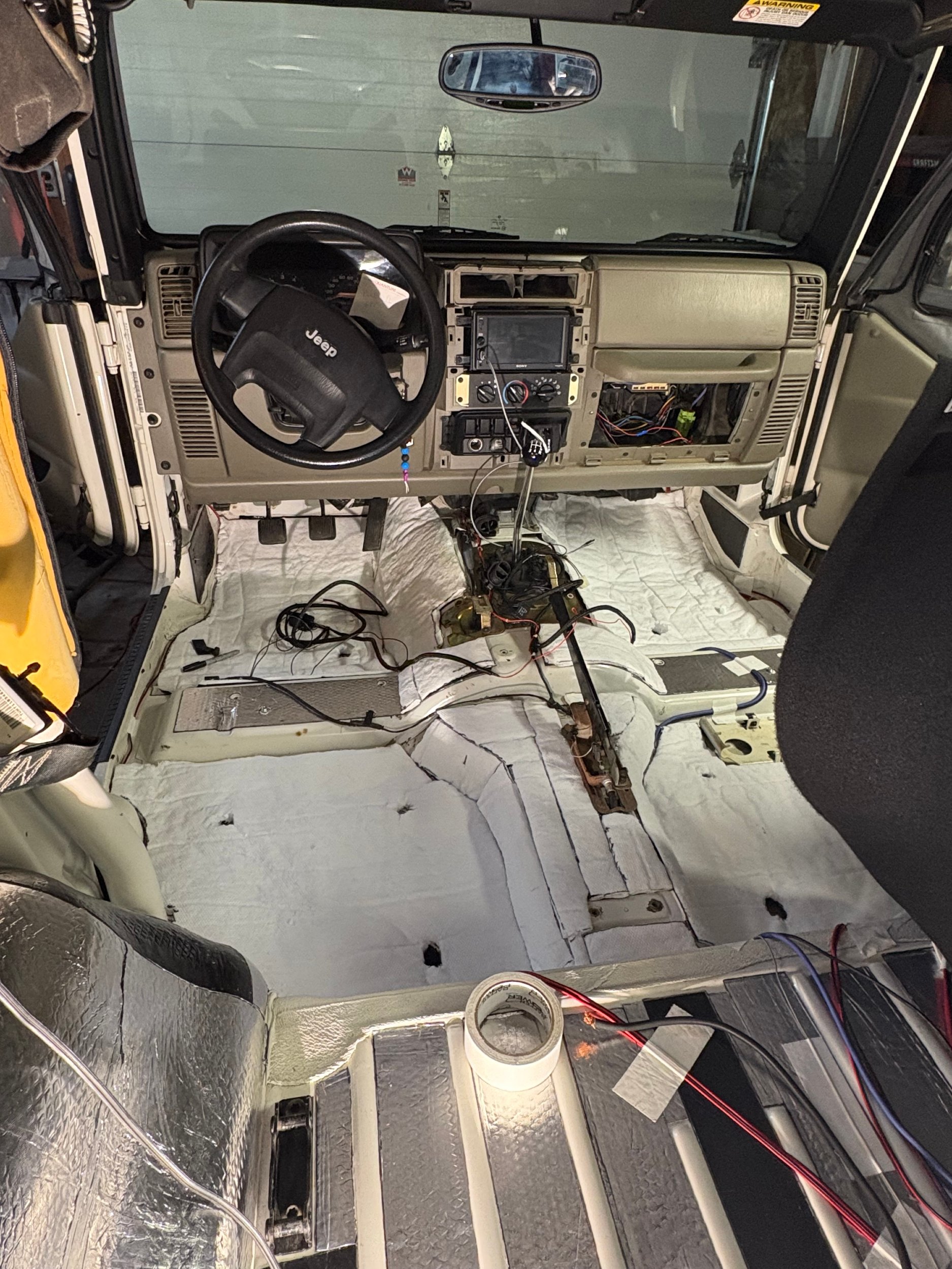

After reading all 20 pages of this thread a couple of times, I was like, I gotta do this too so I found some Noico on Ebay and went at it. After now finishing, I can't say I ever want to do it again but then decided to torture myself a little more and added OEM grade 3M Thinsulate (I had leftover from previous build that never happened) sound absorbing layer on top. It was A LOT of hours and I hope I will be able to tell a difference....

Will do. haven't driven it yet as I am still in project mode but sitting in it in the garage and just shutting the door I can tell a difference. No hard top.
