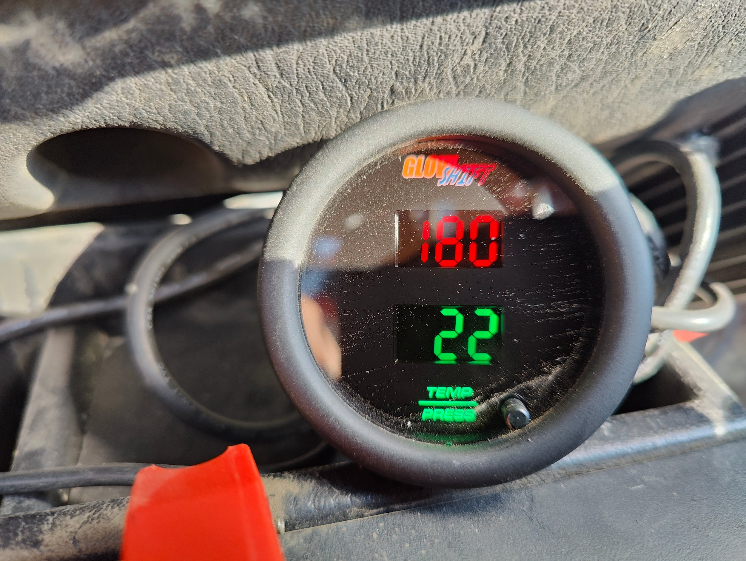

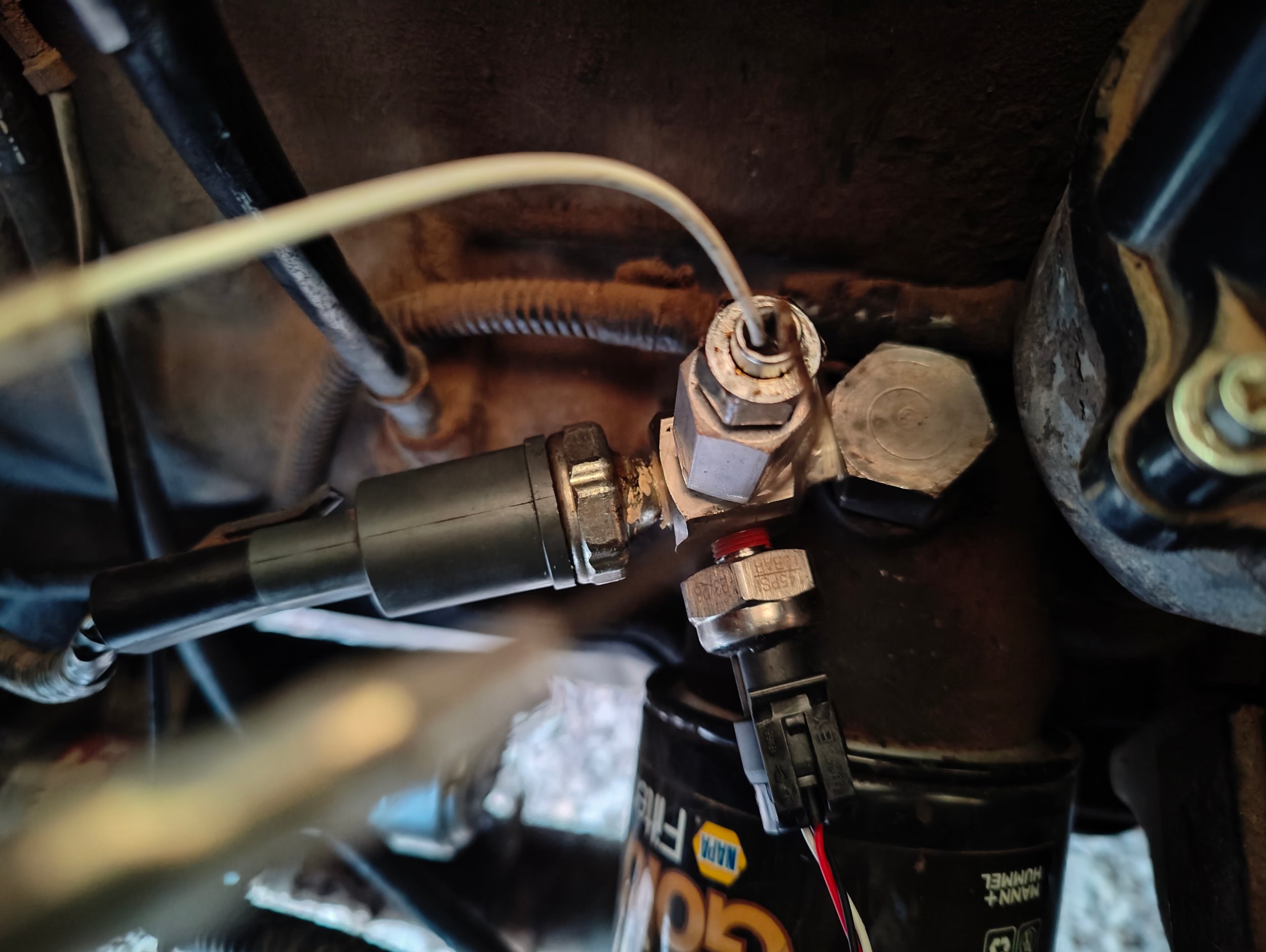

I'm monitoring the temperature of the oil out of the pan but we really have no idea how hot the oil is immediately after making through the engine. And I'm not sure there's an easy way to monitor that, nor a necessity to do so...still curious.

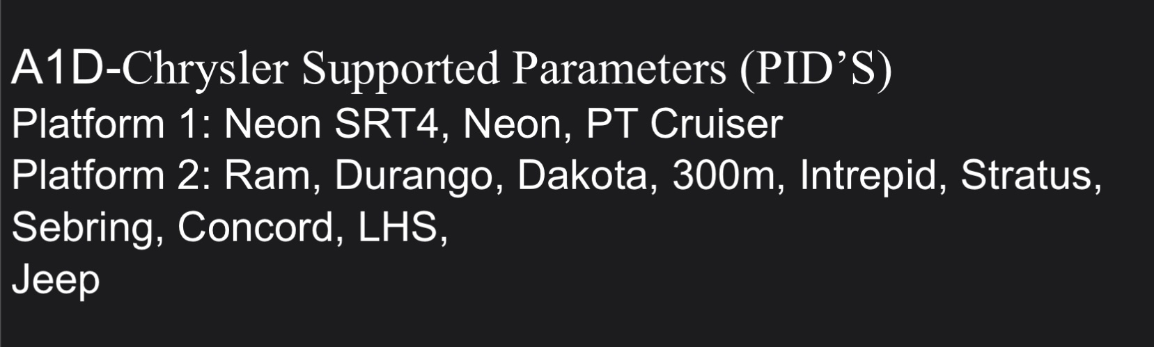

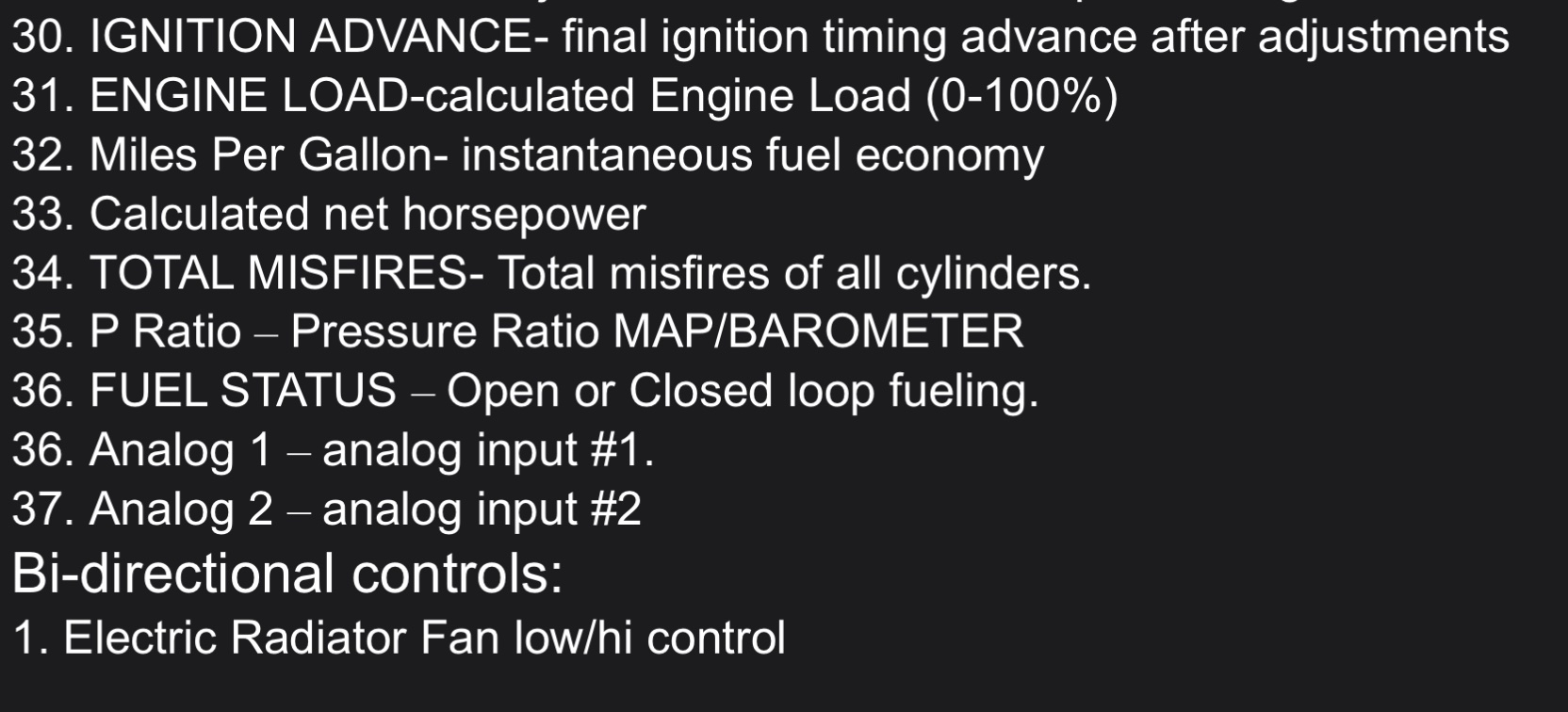

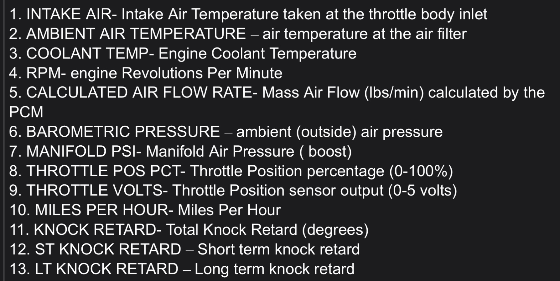

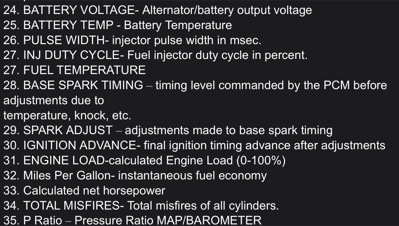

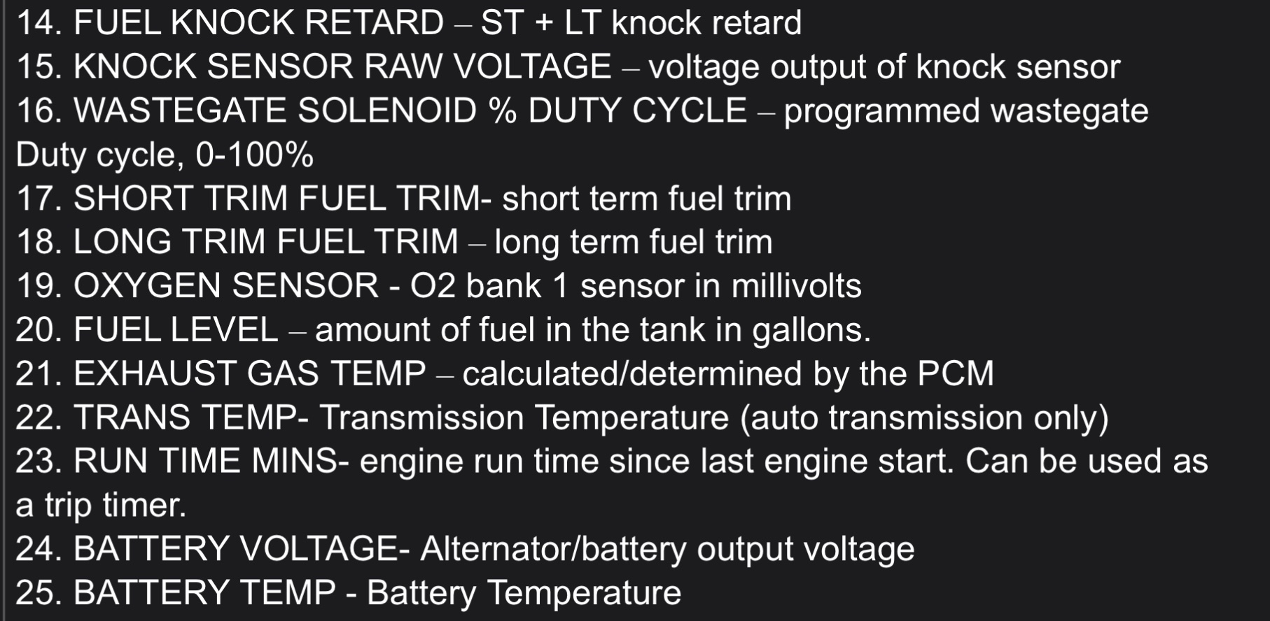

It sure would be nice to program the PCM to add more PIDs and do this internally. I'd rather do that then manage a seperate Arduino. That and once it's in the PCM it can be used for tuning and data logging. Heck you could even trigger the check engine light. I'm sure the newer PCMs in the 04-06 range can do it... probably less so with a 97.

As for its function as a cooler, I don't have data to back this up. I did previously run an air to oil cooler with a 180 degree thermostat, and it was almost always flowing heavily after 20-30 minutes or so. I have however noticed my oil seems way cleaner after 3,000 miles than it used to. Not sure if that's more from the moisture reduction or from limiting the peak temperature of the oil.
The biggest thing I've noticed is less drag on the engine a few minutes after starting driving, more like what you'd expect after driving for 30+ minutes. My guess is that this is due to the lower oil viscosity at the higher temperature allowing for better lubrication of the hydrodynamic bearings, and also taking less energy to pump.
