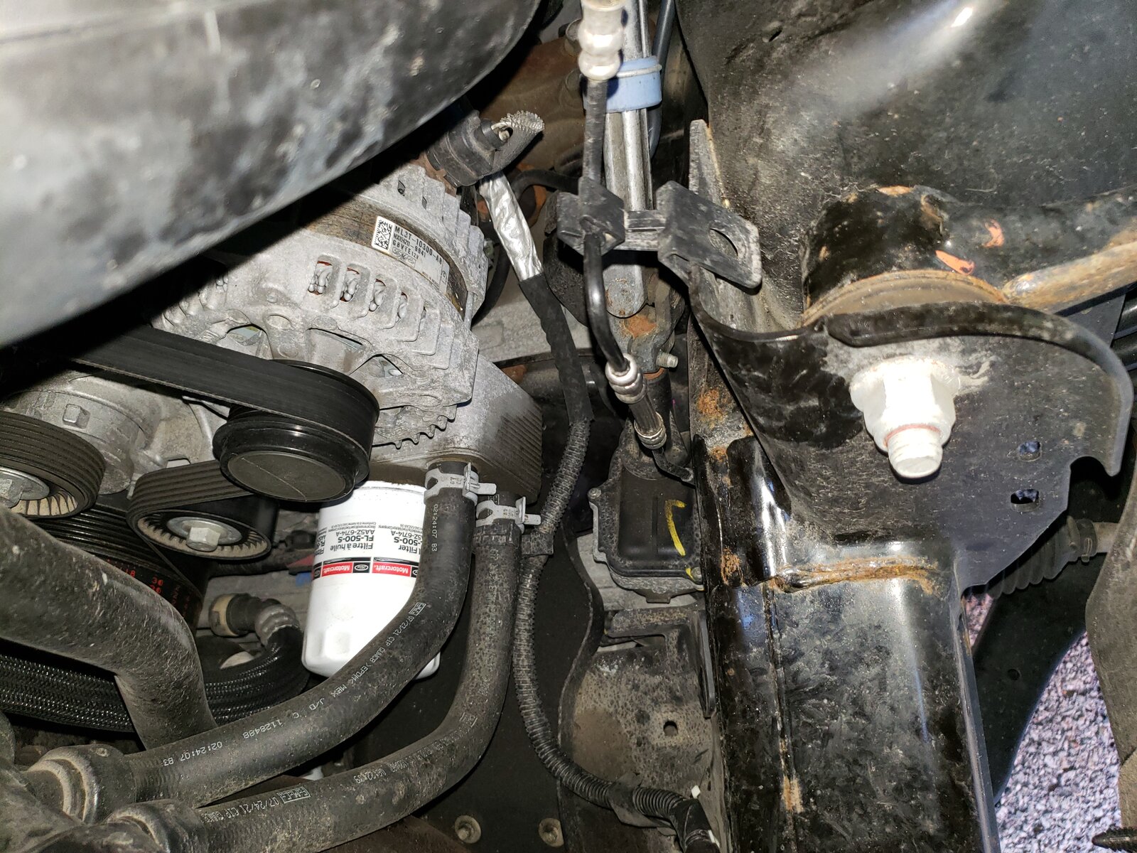

How to install a Ecoboost oil cooler / heater in a 4.0 and why
The Mopar part needs 5/8" hose so I bought a small roll of 5/8" heater hose and just used that
Most heater hose is not suitable for oil transfer. I would be concerned that it might deteriorate and fail. Which of course would be pretty catastrophic.
The hose is only for coolant. The oil is 100% contained in the metal part of the cooler.
The only hoses should be water pump to exchanger and exchanger to heater core.
