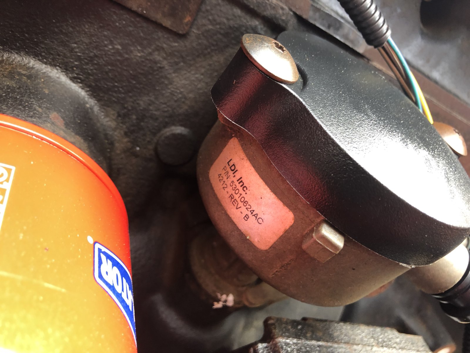

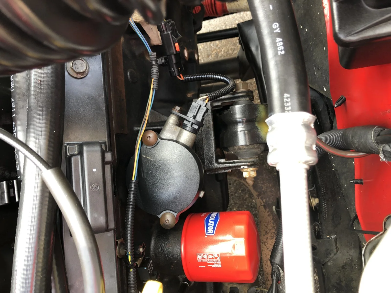

Went for a small drive today in my new to me Jeep, and had the CEL on (kind of pissed considering I literally just got it a week ago, but whatever). The code was P 0016, and when I looked it up it said it could be the OPDA, but I don’t have any screeching monkeys or anything like that. Should I still go ahead and replace it?
Now I get P 0344 as well. Could it be due to the cold?
Can you snap a picture of the OPDA to see if it’s stock or a replacement? If it’s a replacement and the PO didn’t use the mopar sensor that’s a common issue, as the aftermarket sensors are known to be rubbish.

@Carter6 that definitely appears to be the original OPDA, but I can't tell on the sensor itself. Mine threw a code and went into limp mode when it was outside in the crazy cold (5F-15F) for a few days, but it's been better since temps got up a little. I am not sure if my sensor is OEM or not with POs and some issues I had last fall that I foolishly took to a shop. Though I have one in my garage to put in. I think if you search the forum a few other people found that code with strange fixes (like O2 sensors and such).

It hasn’t been terribly terribly cold, but it has been below freezing. I’ll switch out the OPDA some time next week and see what happens.

It’s defintiely a good thing to do sooner than later to at least check the gear wear, it gave me a lot of peace of mind.

Interesting, so it may be the cold after all? I’m not sure if the sensor I have is OEM or not. Is there a way to tell?
