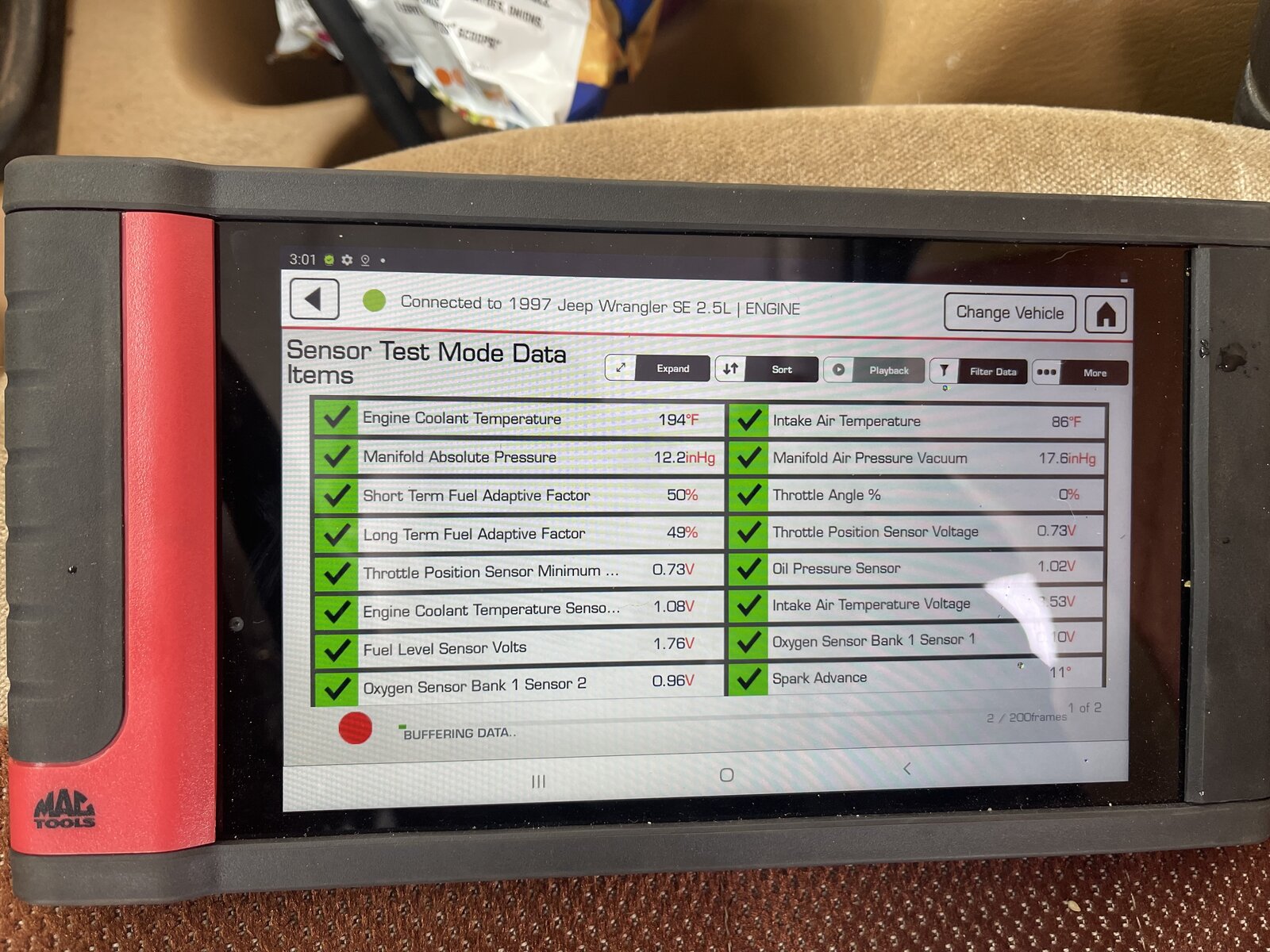

I’m having the same issue. Replaced both o2 sensors and still have it. I have live stream data if anyone knows what to get next by looking at it. Thank you
