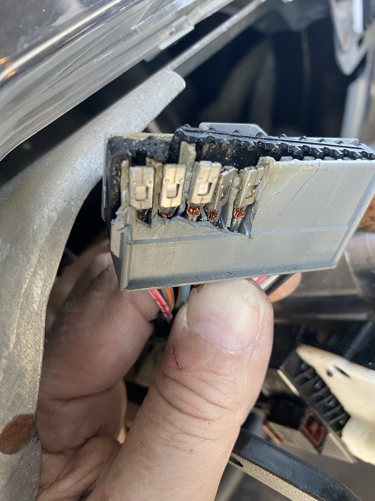

I’m looking to see if anybody has a headlight switch pigtail. Mine in melted and fell apart when I unplugged it. 20 pin plug. Hopefully someone has one they can spare or knows where I can get one. Thanks
This is not an uncommon issue. I’ve had the connector melt similarly twice in my ‘05. The first time, I replaced with Mopar. The second time (5 years later) I used Dorman. In this case, the Dorman connector actually seemed to be of higher quality.
https://www.amazon.com/dp/B06XPPQZ6Y/?tag=wranglerorg-20
Also: I would recommend de-pinning rather than cutting and splicing. Any wires that are still good can simply be plugged into the new connector. I’ve used the below kit to de-pin several connectors.
https://www.amazon.com/dp/B007WQQHA2/?tag=wranglerorg-20
