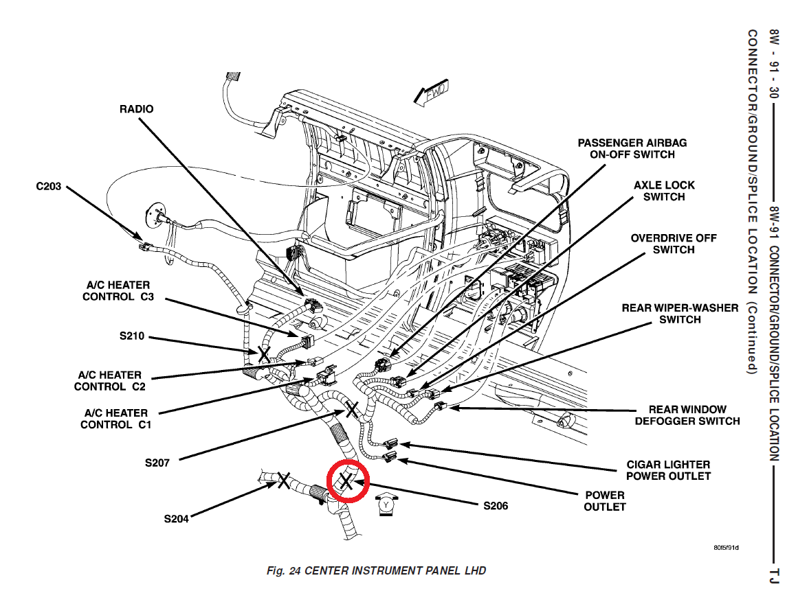

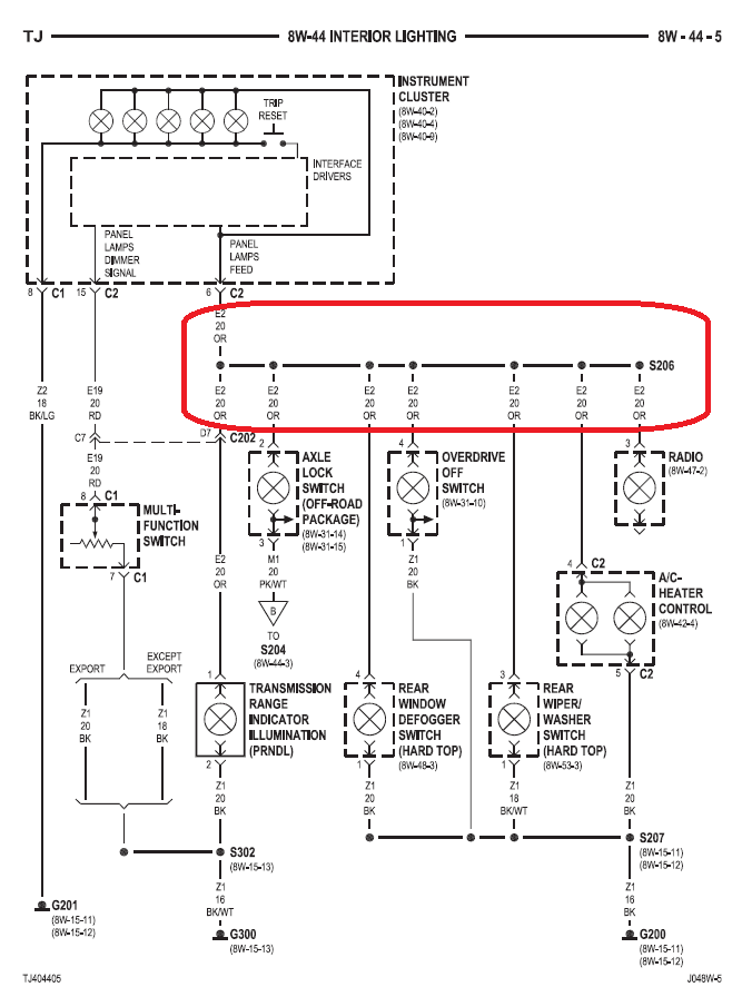

Hi Everyone,
I have an '04 Rubicon soft top with a manual trans and have a dummy switch plug with a harness pigtail connected to it and wanted to ask if anyone has an insight on what the wire pinout is? I have read this connector could be for either the hard top wiper or automatic O/D on/off. I am looking to find the illumination wire to splice into for adding an extra switch and would like to light it similar to the factory setup.
Thank you
The orange panel lamps feed gets distributed at splice S206:
Which is located in the main harness here:
That would be the overdrive switch connector for an automatic transmission. From Section 8W (page 8W-80-37) of the 2004 Factory Service Manual:
Also, note that orange is consistently used for panel lamps throughout the harness.
