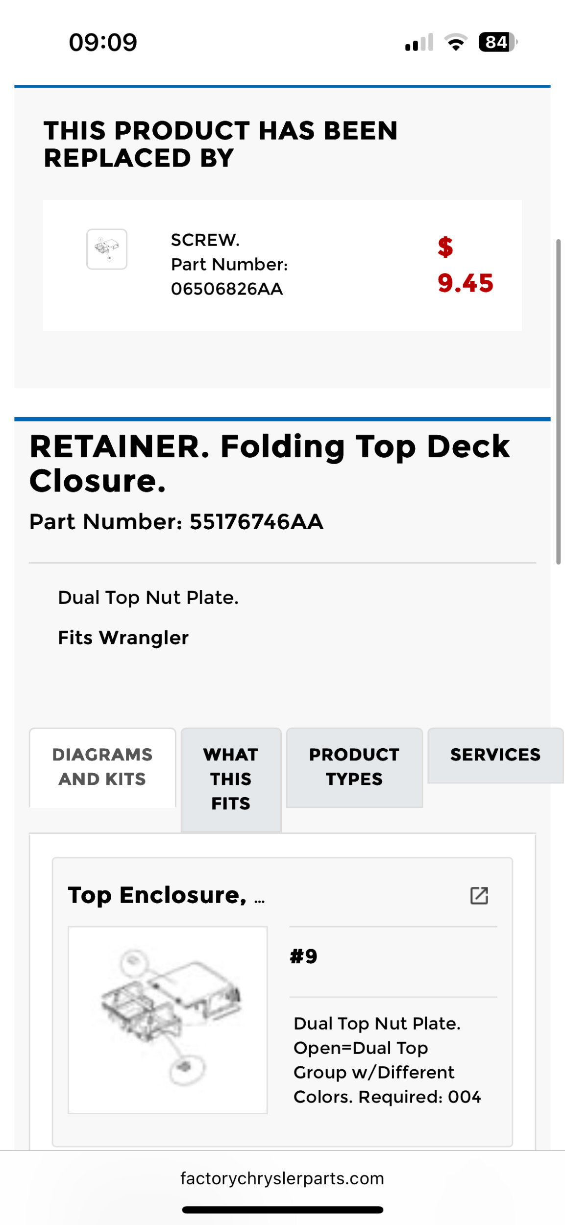

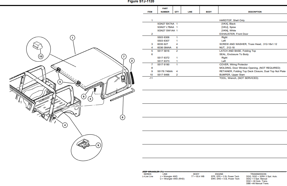

Does any know what parts 9 and 10 are in this diagram?

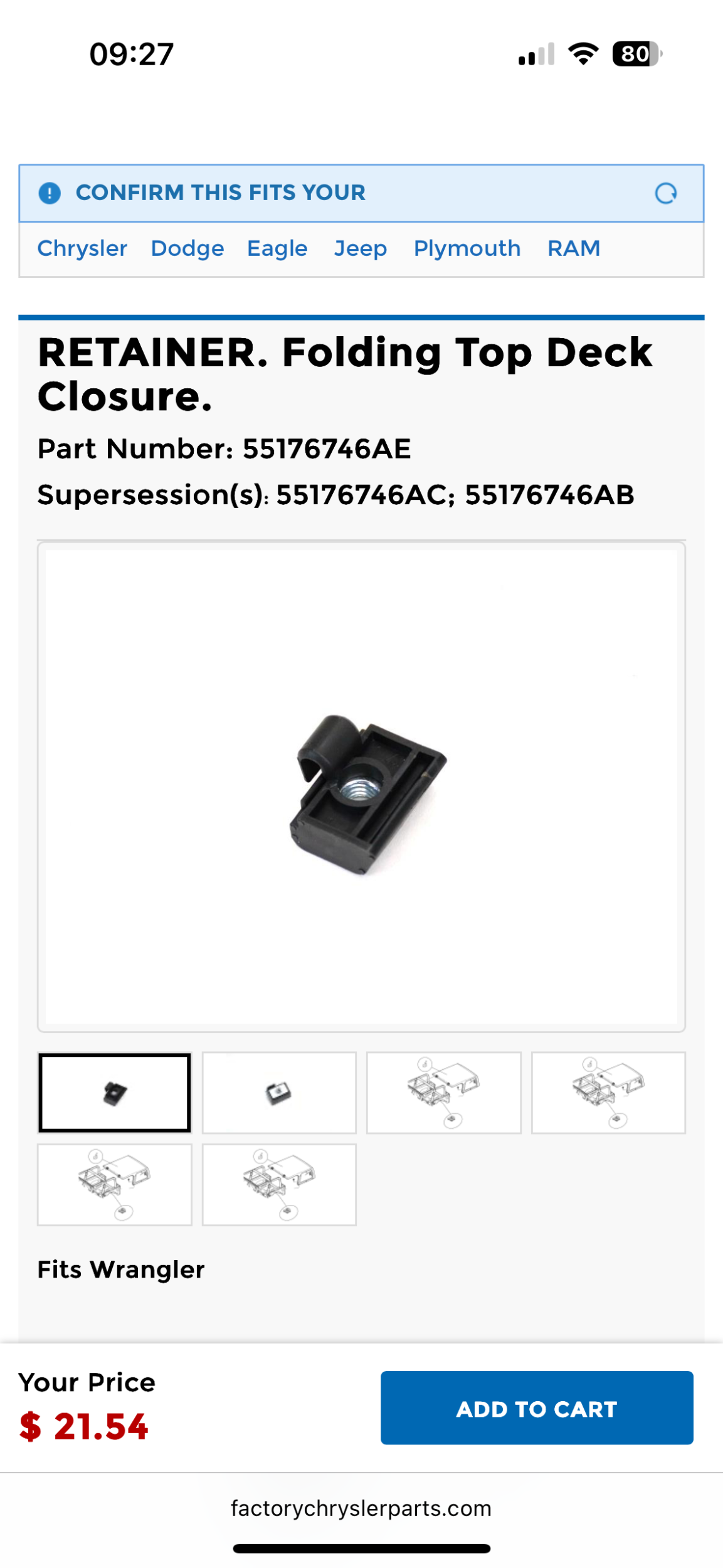

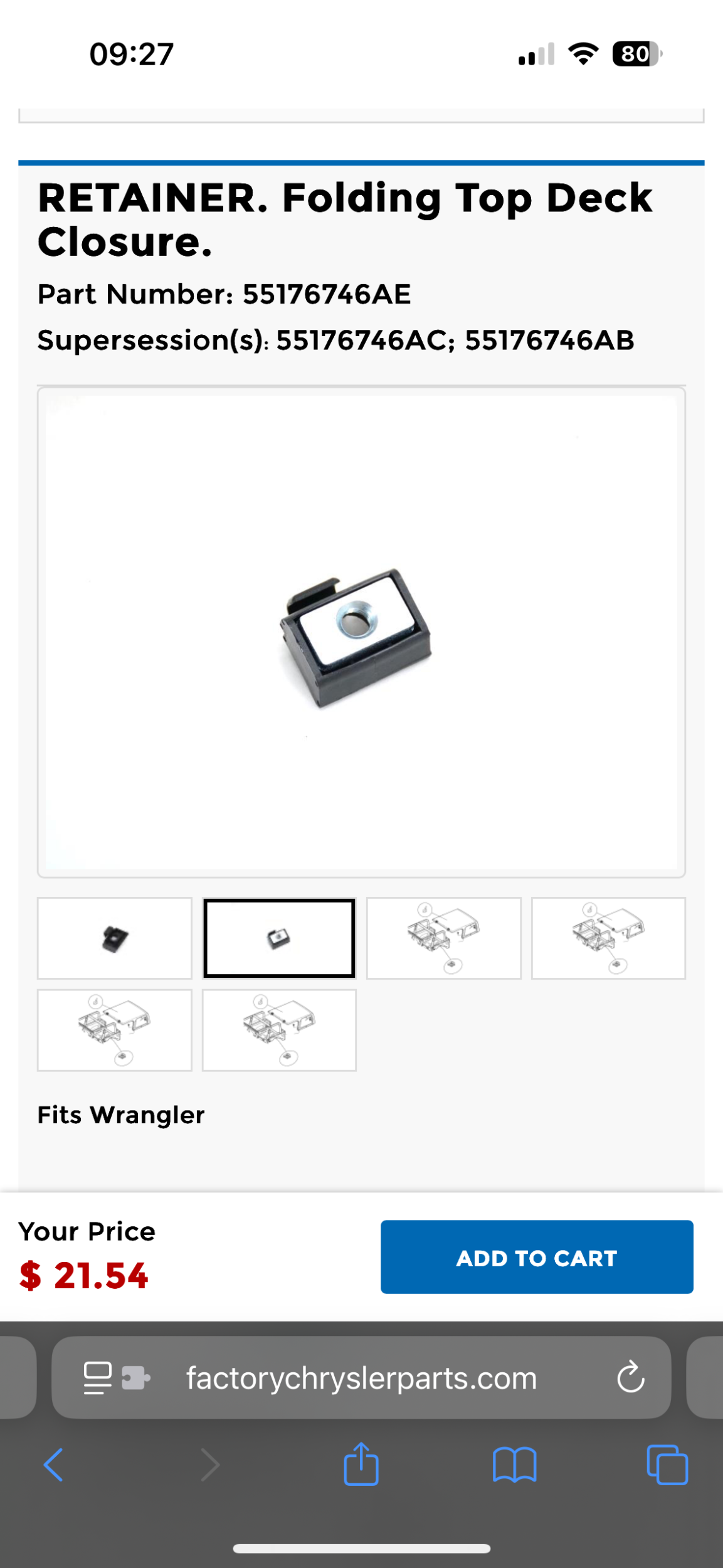

#9 Pictures and Part # are attached. It’s for screwing your hardtop into the tub. It’s supposed to help with getting a nice uniform seal that’s tight all the way around.
#10 appears to be a bumper that’s placed between the roll bar or sound bar and the top of the hard top. My guess it helps to prevent rattling between the hard top and the tub
These parts aren’t needed at all and your hardtop functions perfectly fine without them. They are more there to help with sealing and noises
Thanks for the pictures. That helps. I guess I can stuff some socks between the soundbar and hardtop if it rattles. :)

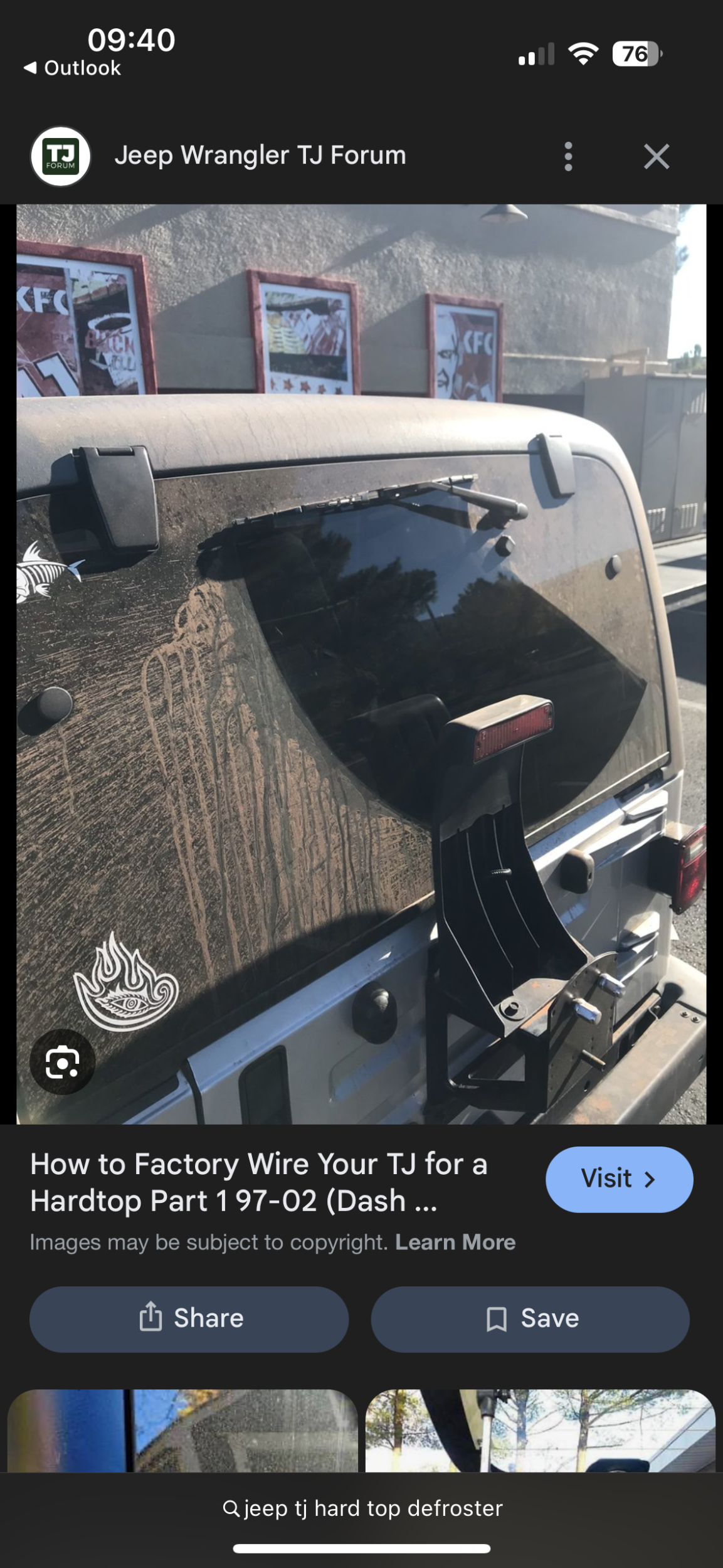

One more question for anyone that knows. I have not bought a rear window yet but I noticed all the pictures have two holes which look like they have something to do with the defrost. I currently do not have anything that would go in those holes nor do I know what I would even look for. Does anyone know what that is called? Nothing shows up in the jeep parts manual.
