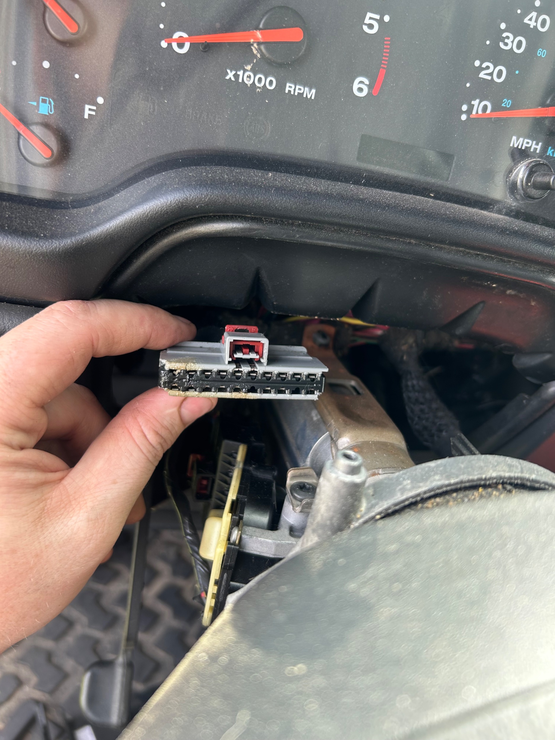

Does anyone know if Mouser or some other company sells just the connector housing for the 01-06 combo switch (headlight, fogs, etc)? I am aware of the various offerings for the pigtails for $50-75 but I was hoping to just find the connector housing for a lot less and I will just pin them in my self.
Like many others, my multi-function switch had begun to act up. My fog lights were not turning on by themselves, but if I was driving with the lights on and hit a good bump, I would get a long series of warning beeps. No engine light or anything else, just 10+ beeps. The first time it happened was a little wild looking for the reason for the noise, but I researched here and found how this is a problem with our turn switch, its connector, or both.
I recently figured out I could cancel the beeping if I lifted the turn signal like I was about to make a right turn. However, not wanting to...
