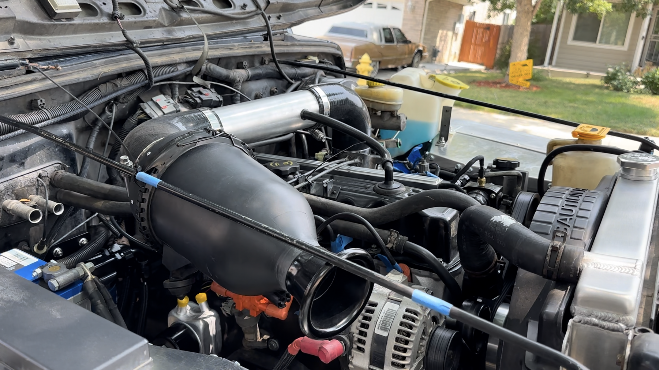

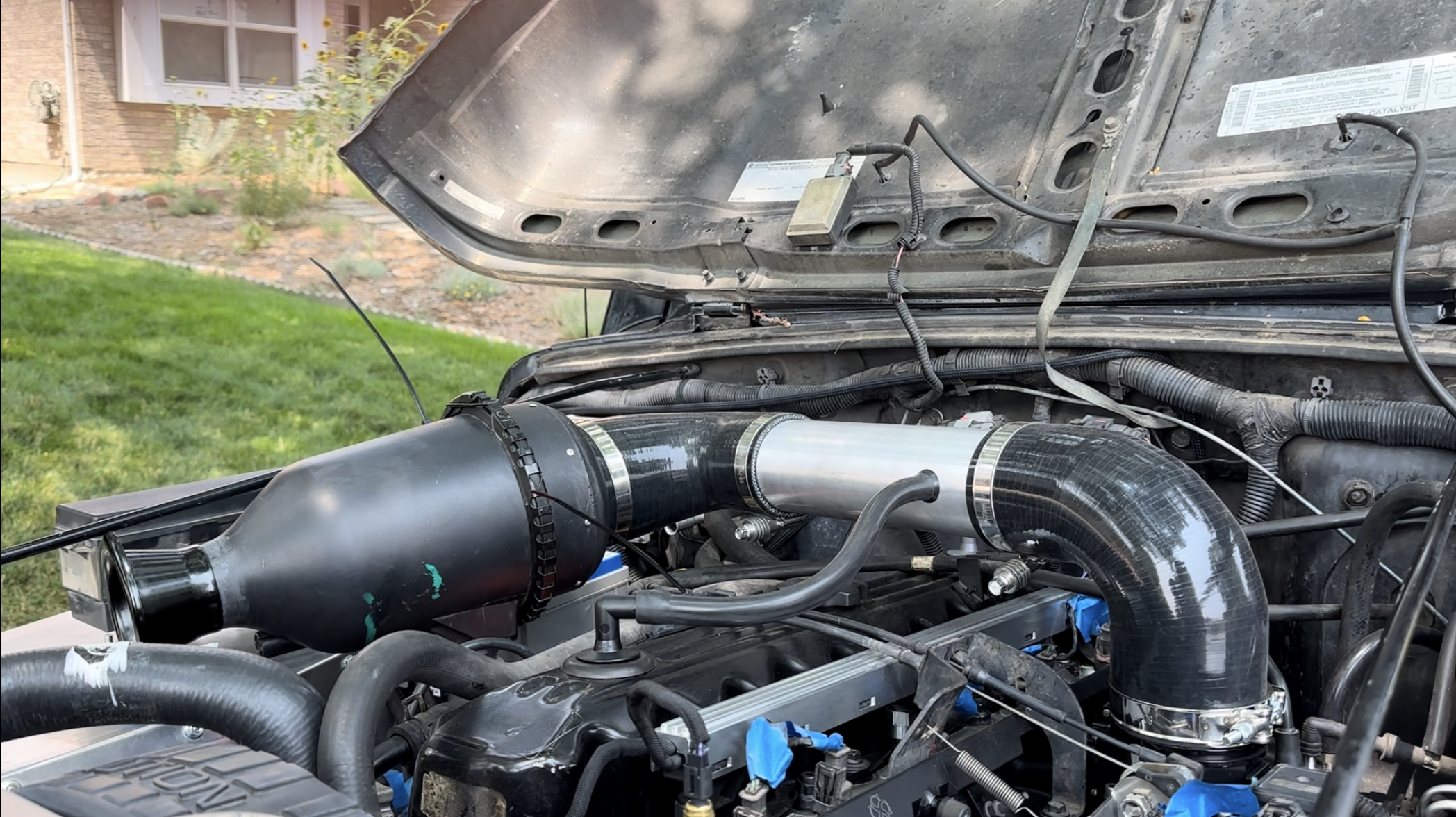

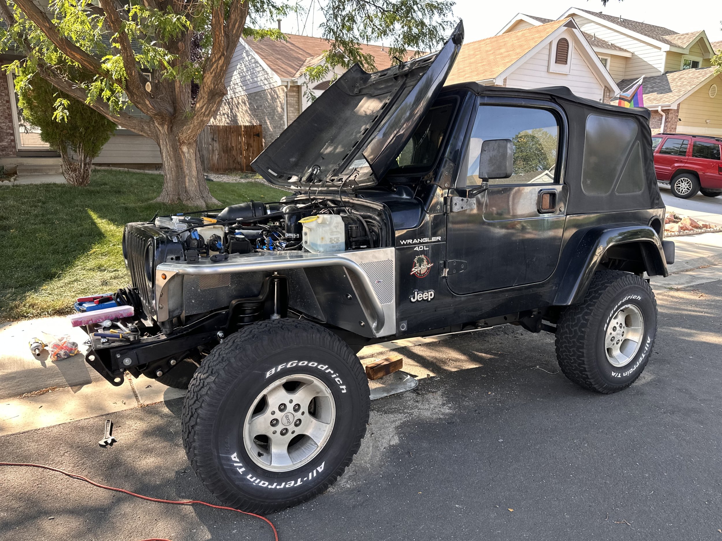

I have the windstar intake but not running through the cowl, at least for now. I just have it zip-tied in place, I won't do anything permanent until other projects are done that might change where things go. I don't want to go cutting holes and then not use them. If you don't have the emissions crap in the way you can tuck the stock washer bottle back by the master cylinder. I did have the emissions crap but I relocated it under the battery tray that's not a battery tray on the driver's side. These are the best pics I could find and the hood is probably frozen shut today.
View attachment 658906View attachment 658907View attachment 658913
That’s interesting, and from this pic @Irun it doesn’t look like the washer bottle would work in the stock location so I recant my prior post. Sorry about that. Back by the auxiliary battery tray would likely be best bet for the stock washer fluid reservoir, but I’m sure you already thought of that. I switched to the smaller aftermarket Kemimoto reservoir for the HiLines that I’m sure would also work for non-HiLines. You’d just have to drill another hole for the stock rear pump.
