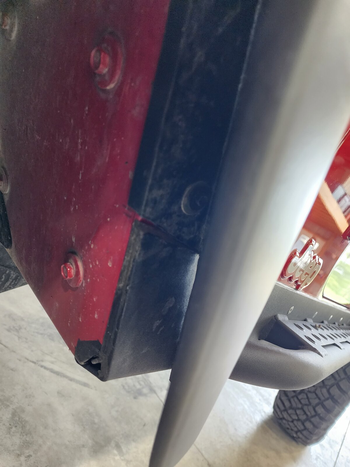

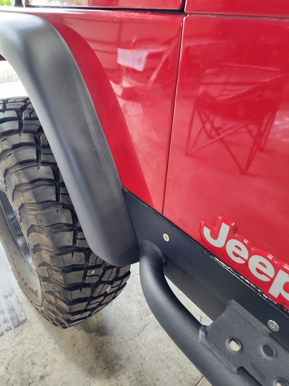

It’s still not perfect, I have small gaps in other areas, and some nutserts didn’t collapse straight on. Doesn’t hurt anything but my OCD. I’m sure a more experienced installer would have managed.

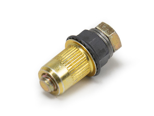

What are you using to install nutserts? The wrench, nut and bolt method, or the tool?
I didn’t even notice my gap. I assumed it was normal. I guess I’m not as OCD as you. 🙂

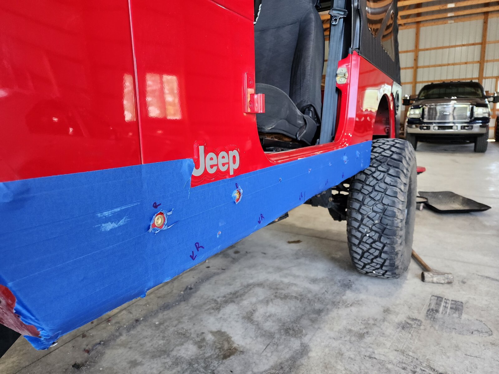

So after weighting all my options for a functioning slider I decided on the Genright mini boats, as they did the best job at checking off the most boxes on my list.

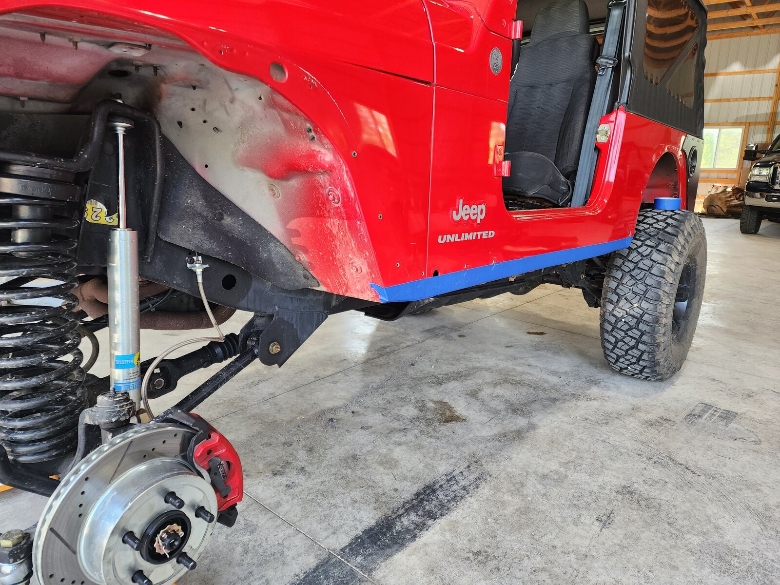

To start with strip off those fender flares

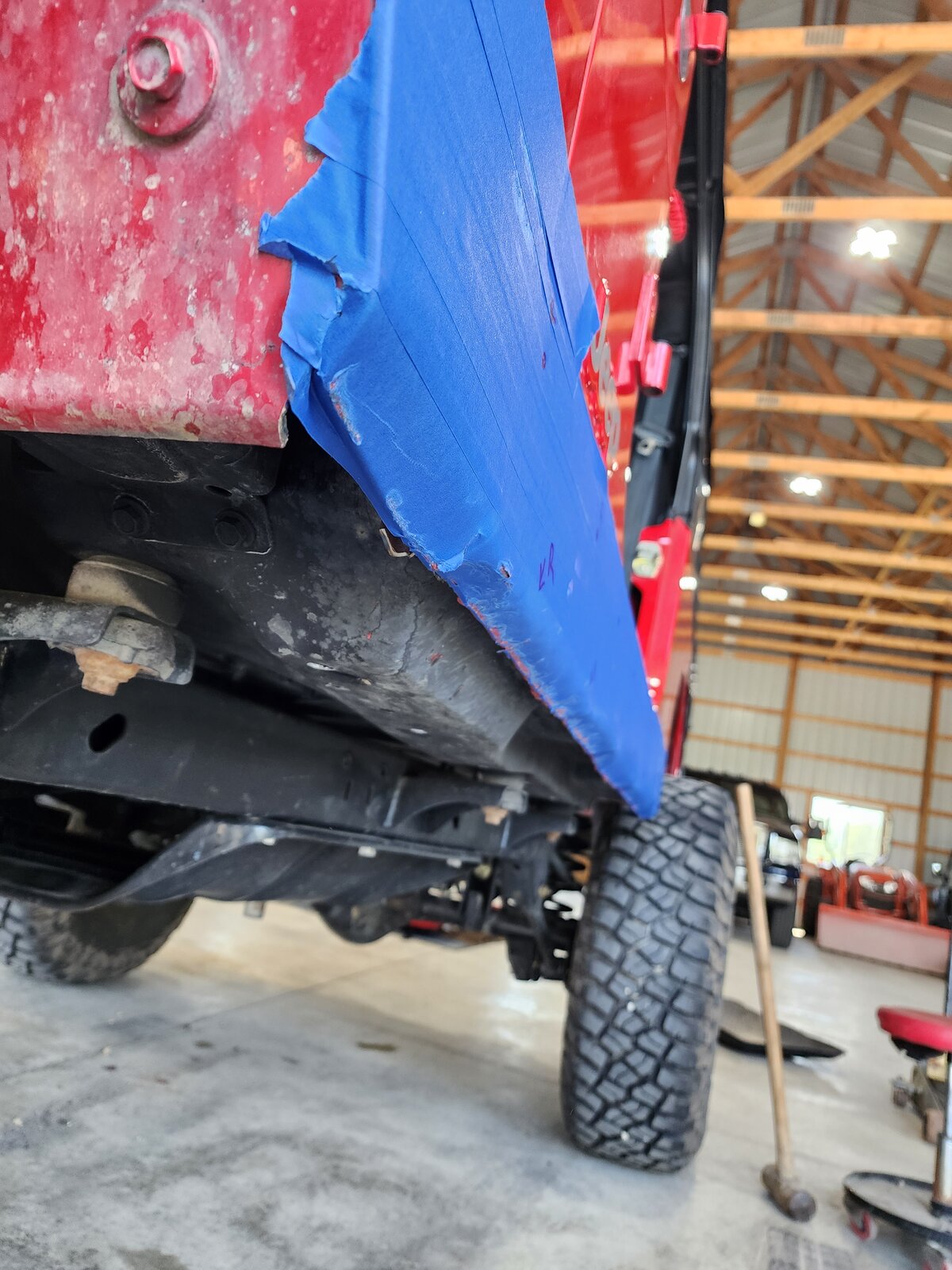

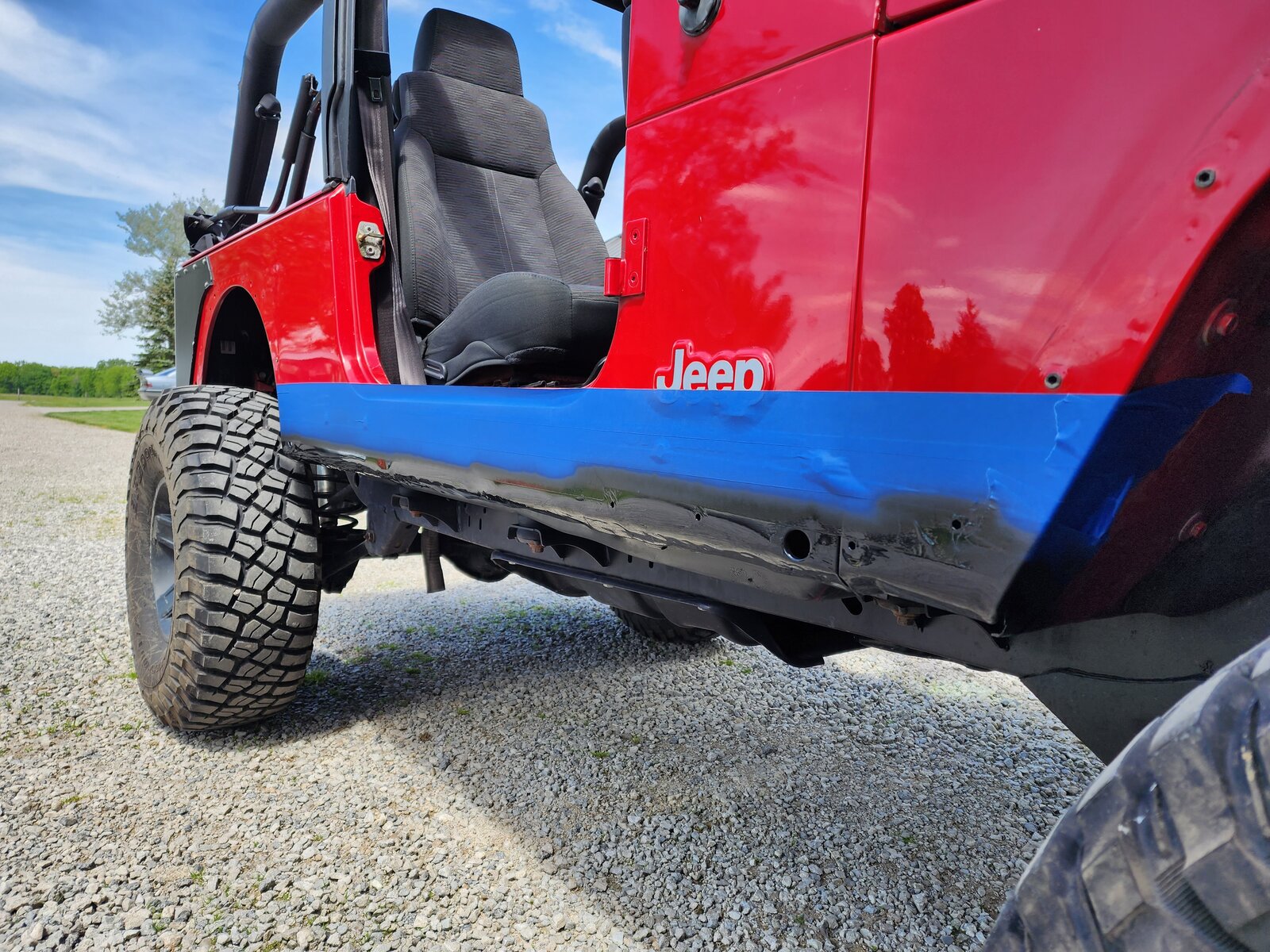

For me I taped off the side up to the door to aid in marking as well as a little protection.

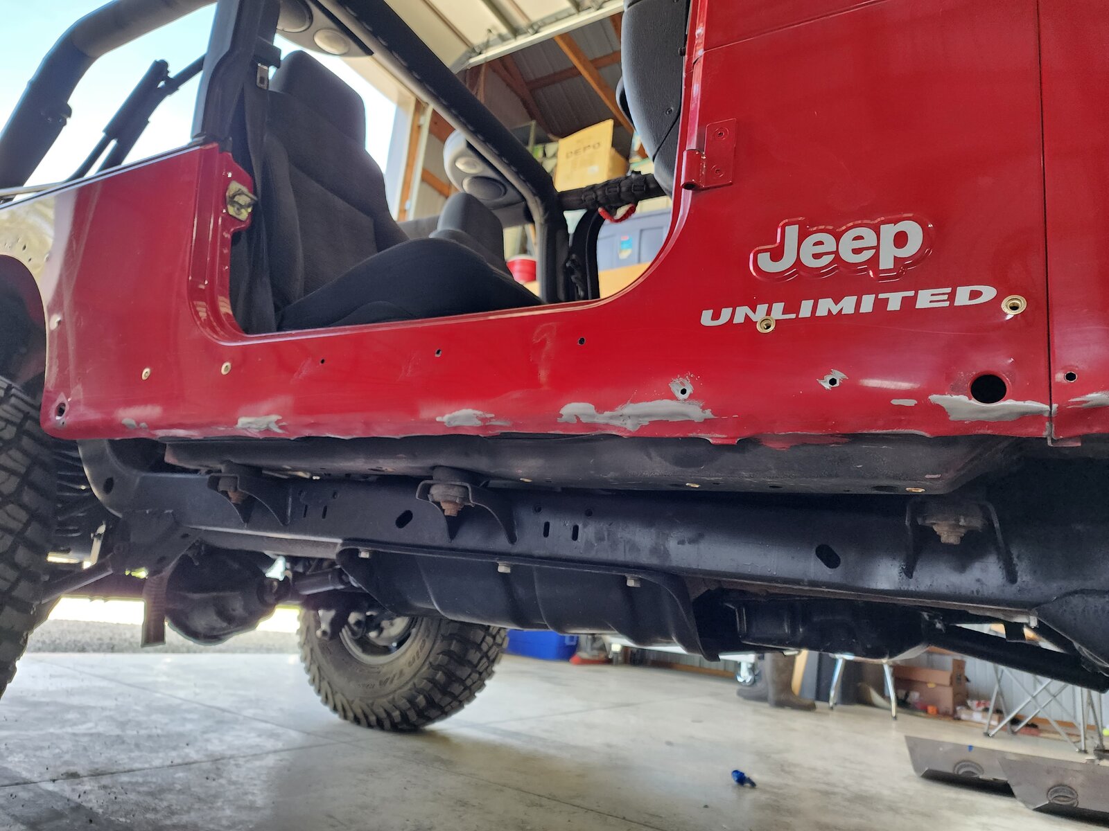

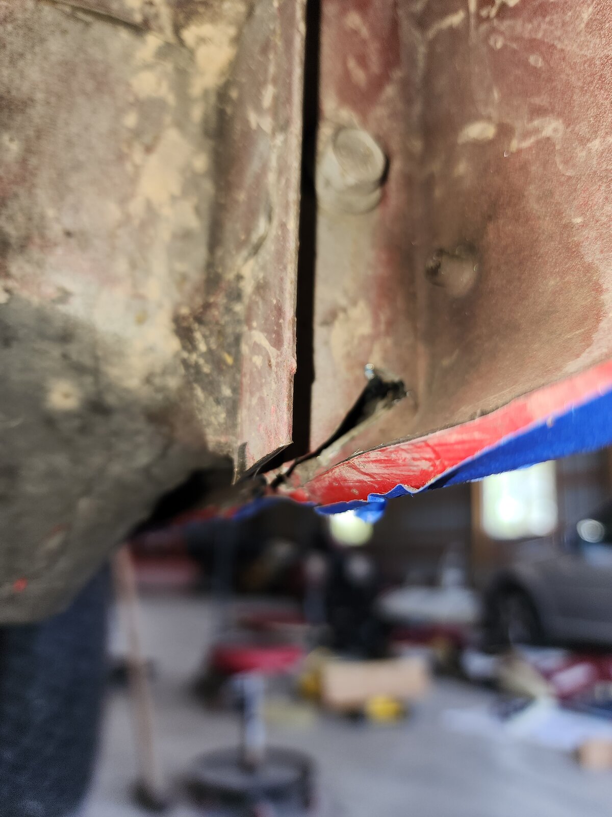

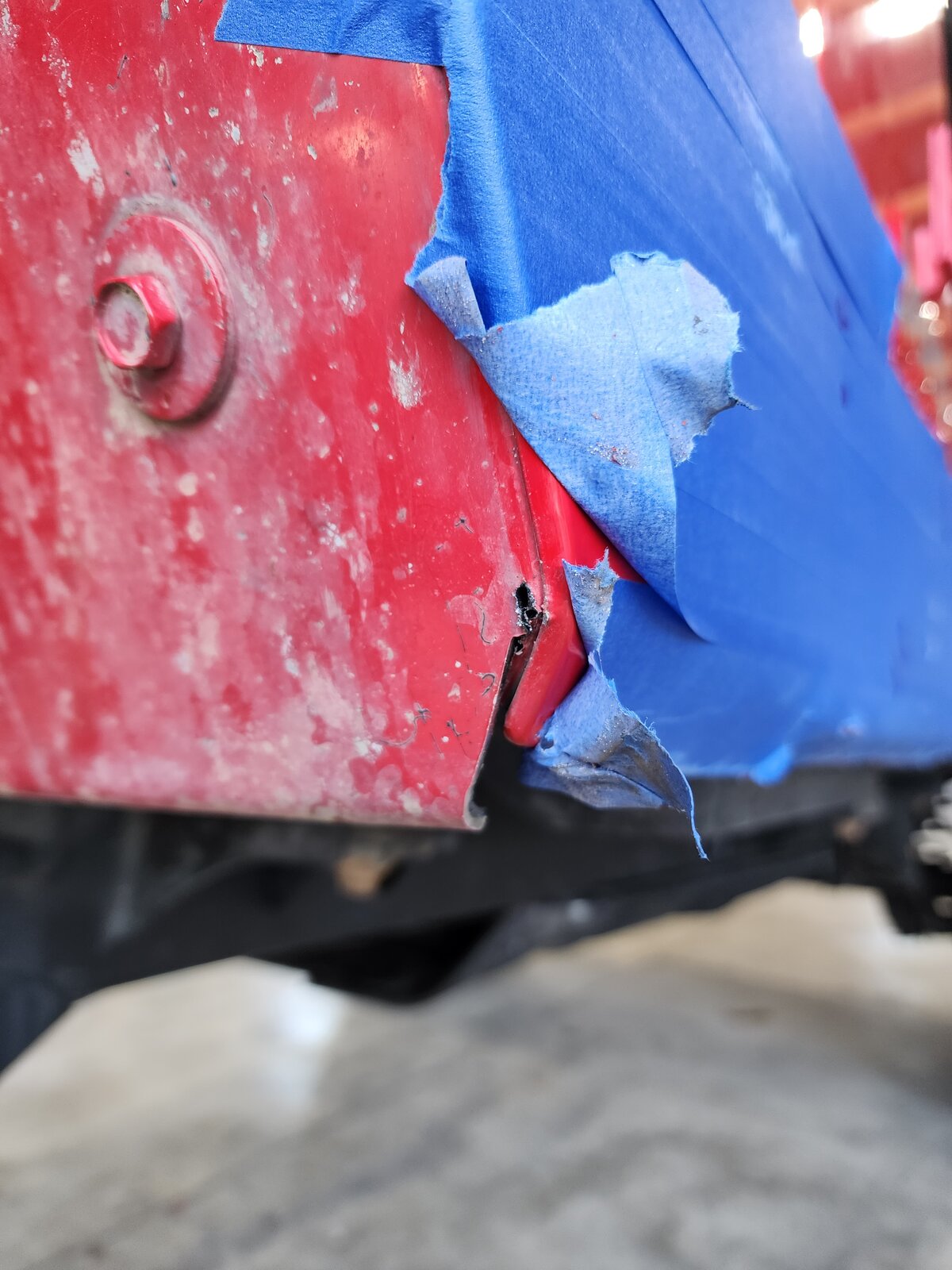

The next part is the scariest part....grab the hammer and bash that bottom seam. Also for me I cut a small wedge out of the bottom of the fender, you also need to do this for the tub to fender seam.

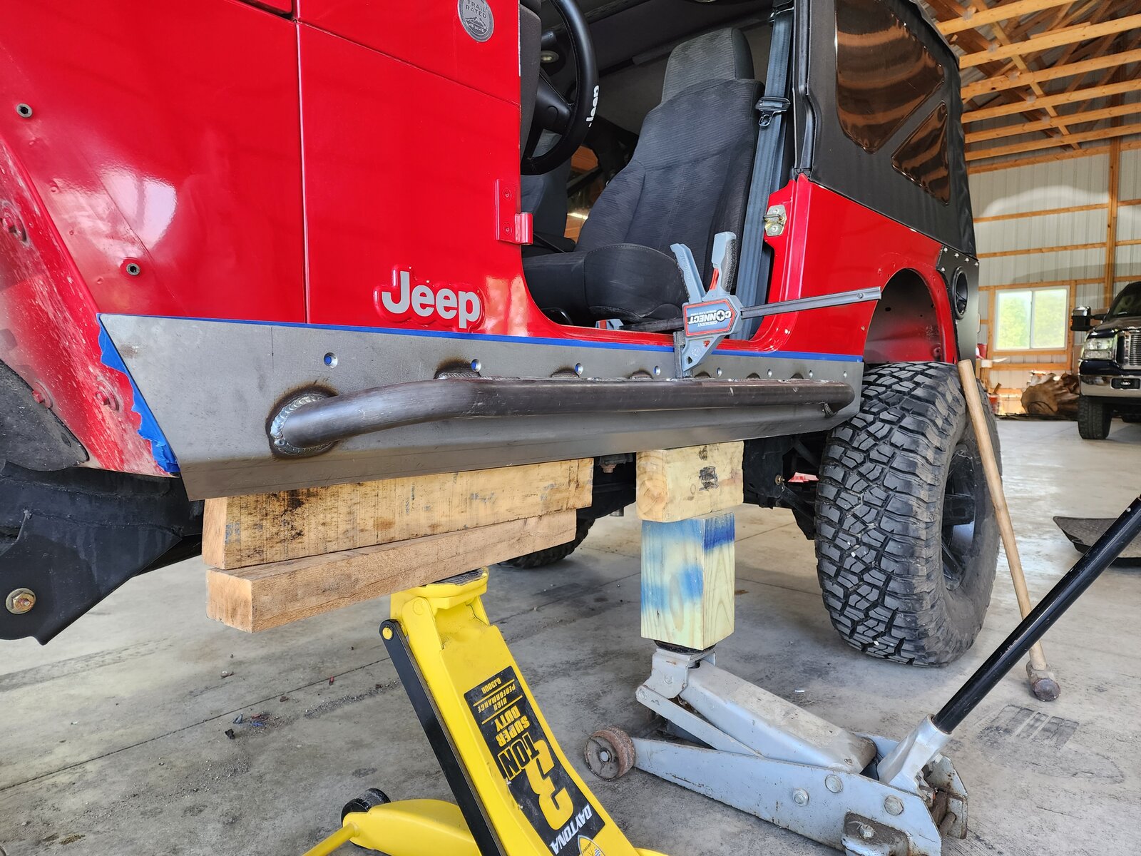

Next was to get the slider in place and centered. Get it nice and tight to the bottom,I used some clamps as well to get it tight to the tub. The first time I placed it up there it wasn't as tight as I wanted so I had to take it down and do a touch more hammering.
Get your holes marked, take down the slider and center punch the holes. Than drill your holes and install your hardware

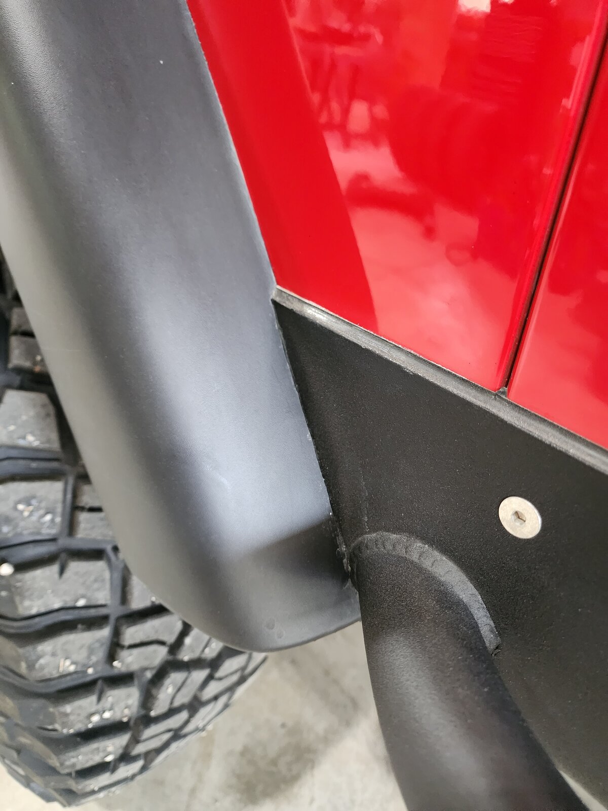

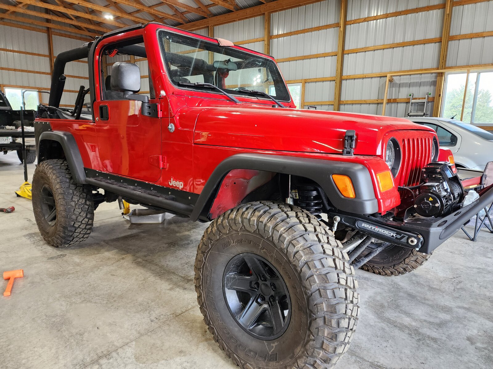

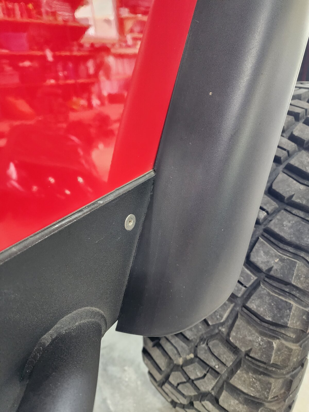

I trimmed my factory fender flares and reinstalled them
Final results

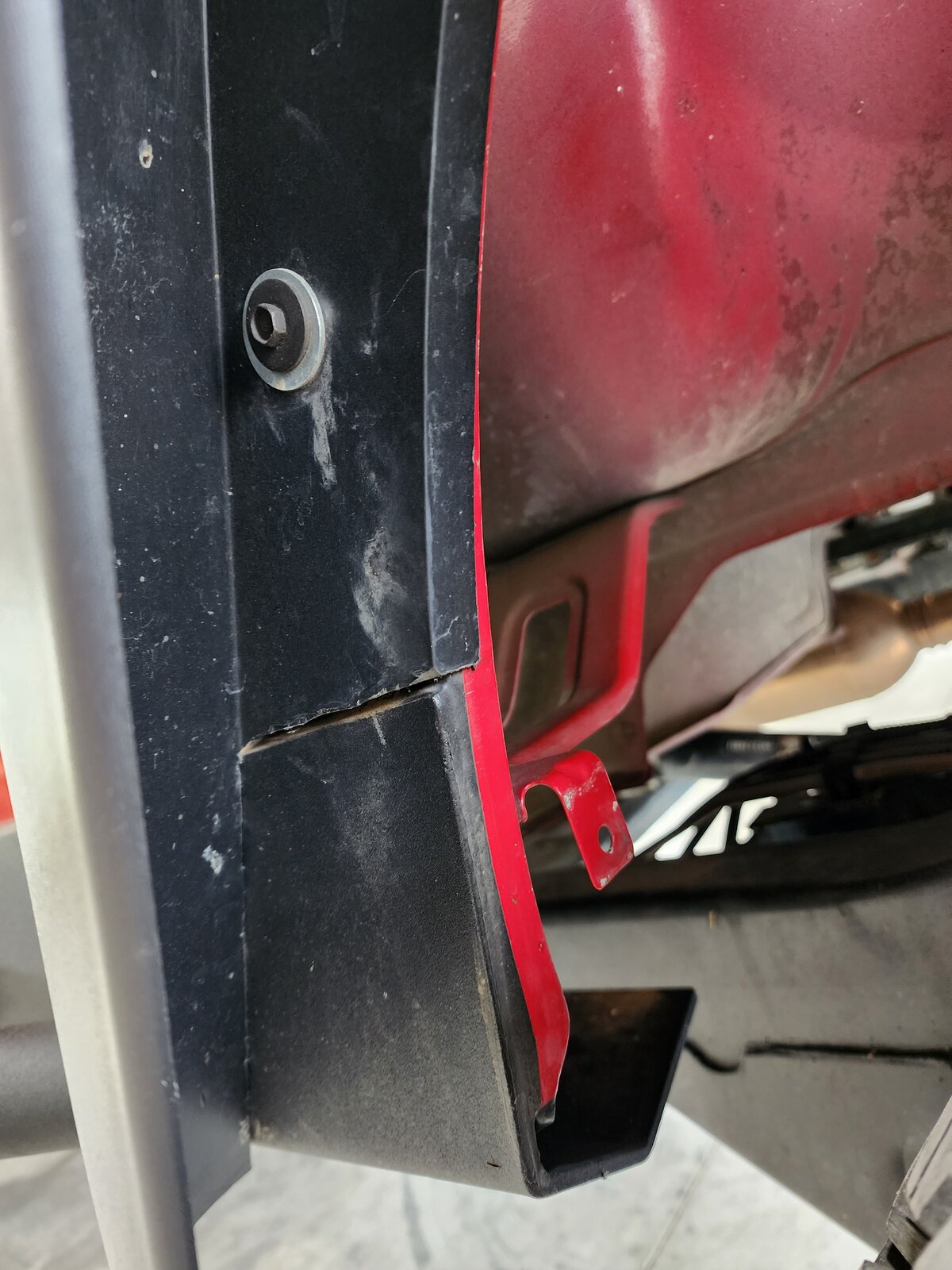

Do you mind elaborating on the notches at the flares and what modifications were needed to keep the flare secured?
Thanks, it pertains to one I’d like to fix.

For me I decide to line them up and decide where I want to cut them, I didn't want to cut any more than I had to. I end up taking off Just enough to cut the whole backer off it's a good ⅛". Then when I reinstalled the factory hardware I put just a little bit larger washer behind them just to help support it a little more. Is it needed? probably not.

Thank you so much. Your LJ looks really good.
This is the tool they provided and it’s what I used.
5/16 Rivnut Installation Tool
Not sure what it’s called. I would probably try a different method if I did it again.

@Steelyace do you think there would be any benefit to cutting 4-5 vertical lines into the body seam while folding it in? I'm wondering if bending it over shorter distances will provide a better bend.

I'm sure that would work. If you're using a hacksaw you could always just cut a little wedge out of there. Mostly you need to be able to get that edge to about a 45° angle and you'll see how far up you have to go. It's not as bad as you think, and if you think you screw it up...... it's covered up anyway.
Thank you for the link @JMT ! $38 is the cheapest I've seen that tool go for.
Just use a heavy rubber mallet or dead blow. Cutting reliefs is a waste of time. You are covering everything up. And a reason you aren't cutting up or cutting off the seam is because you are retaining the welded structure of where those two body panels meet.
On stock front fenders, there is one vertical rib that needs a small pie slice to allow for enough fold.
