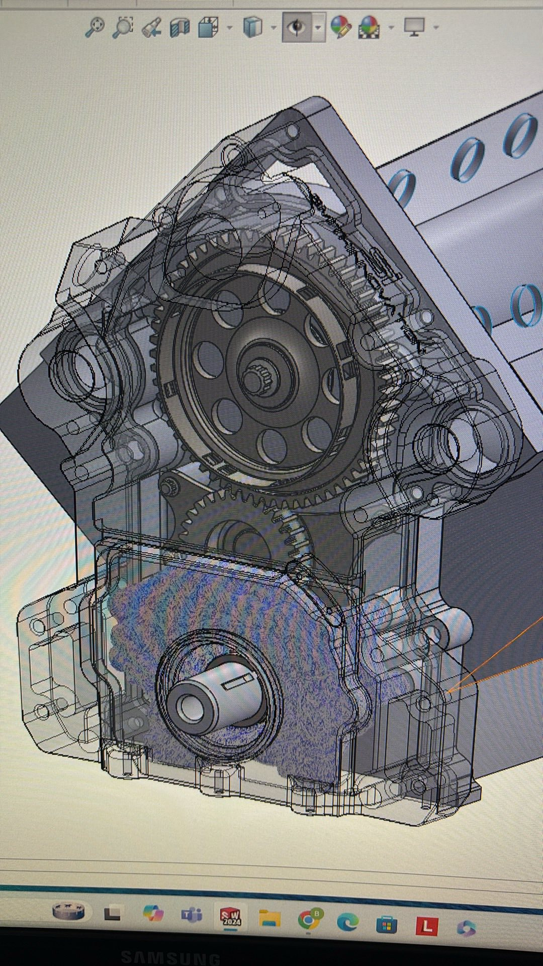

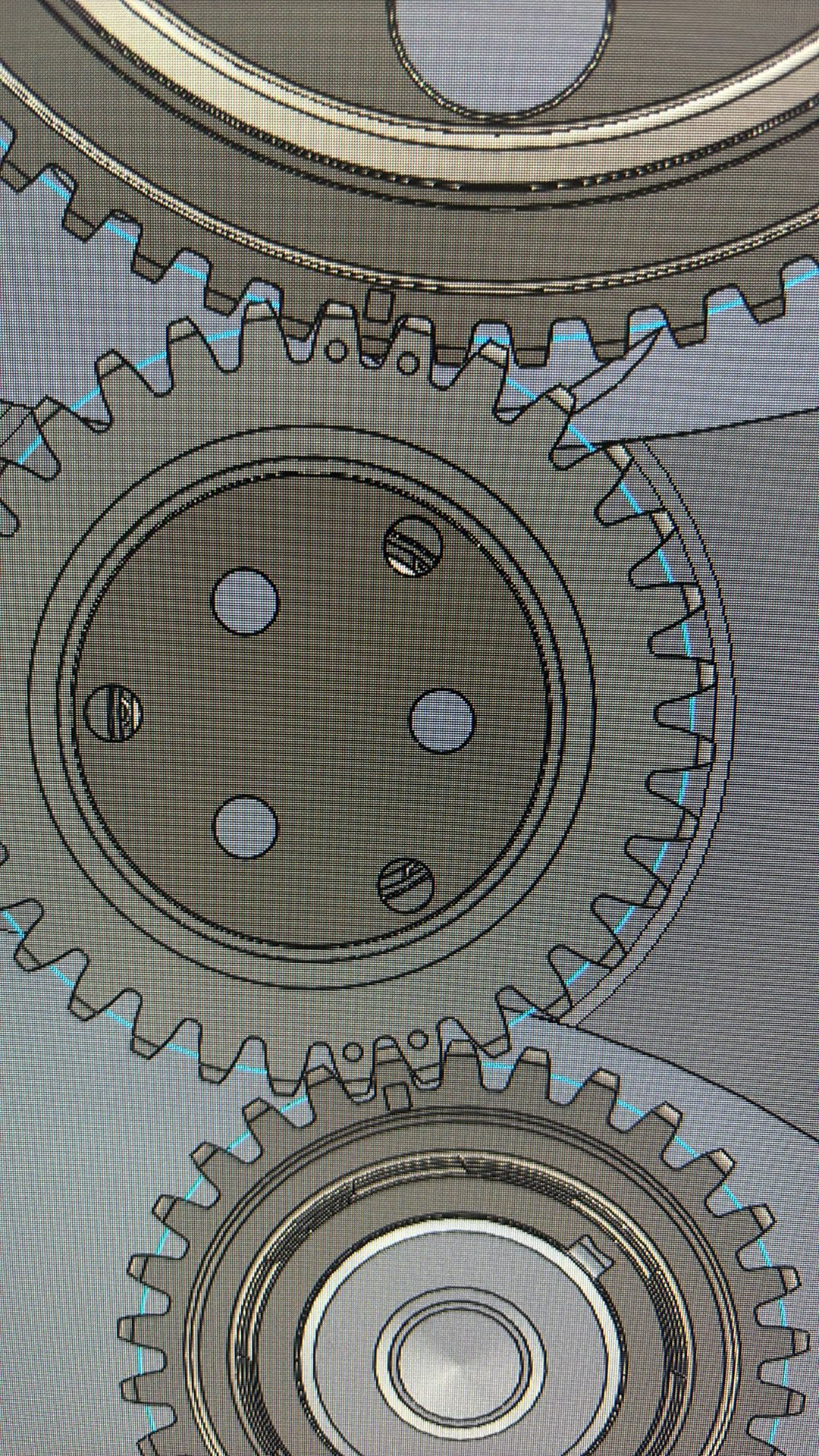

Smith Innovation is proud to bring to market the first gear drive for the Gen3 hemi platform. This system is a single idler style spur gear setup and shares the same DNA as our billet timing chain upper pulley as the sensor cage is all one piece and we are again utilizing a roller thrust bearing.
These sets remove the chain that is great, but will stretch over time and also removes the tensioner and plastic guide. You have never experienced rock steady timing like a never wear gear drive provides. Sets will ship with improved hardware and a lower gear that allows for +\-6 degrees of cam advance or retard. Now for the best part, this drive fits under all timing covers and all OEM style oil pumps and requires no modifications to the block. It’s a bolt on system that will be extremely easy to install and set cam timing.

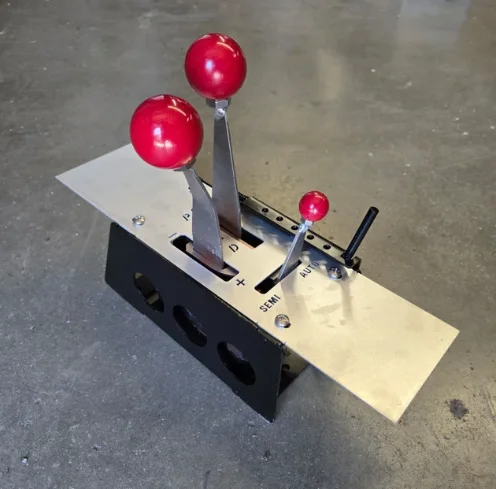

From some feed back from another FB member who had the stock shifter mounted on his GR center console and them his frustration with it not working well I've got this shifter coming for mine. He'd also swapped to one and said it works well for our application. That Black lever on the right is a Park lockout so you can slam it from Drive to Reverse and not hit Park instead.

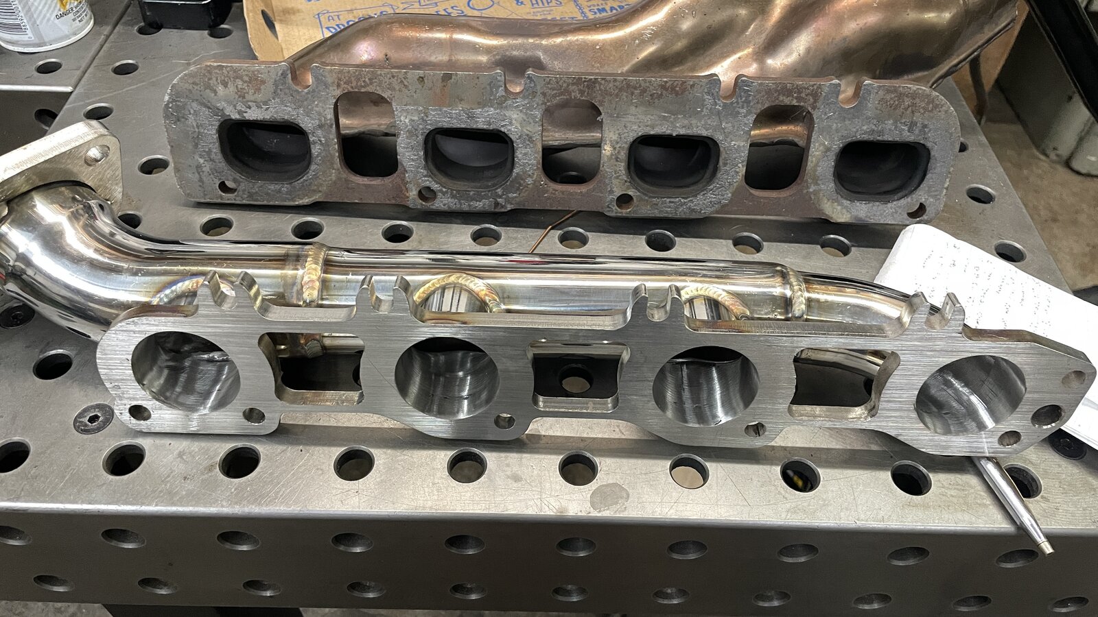

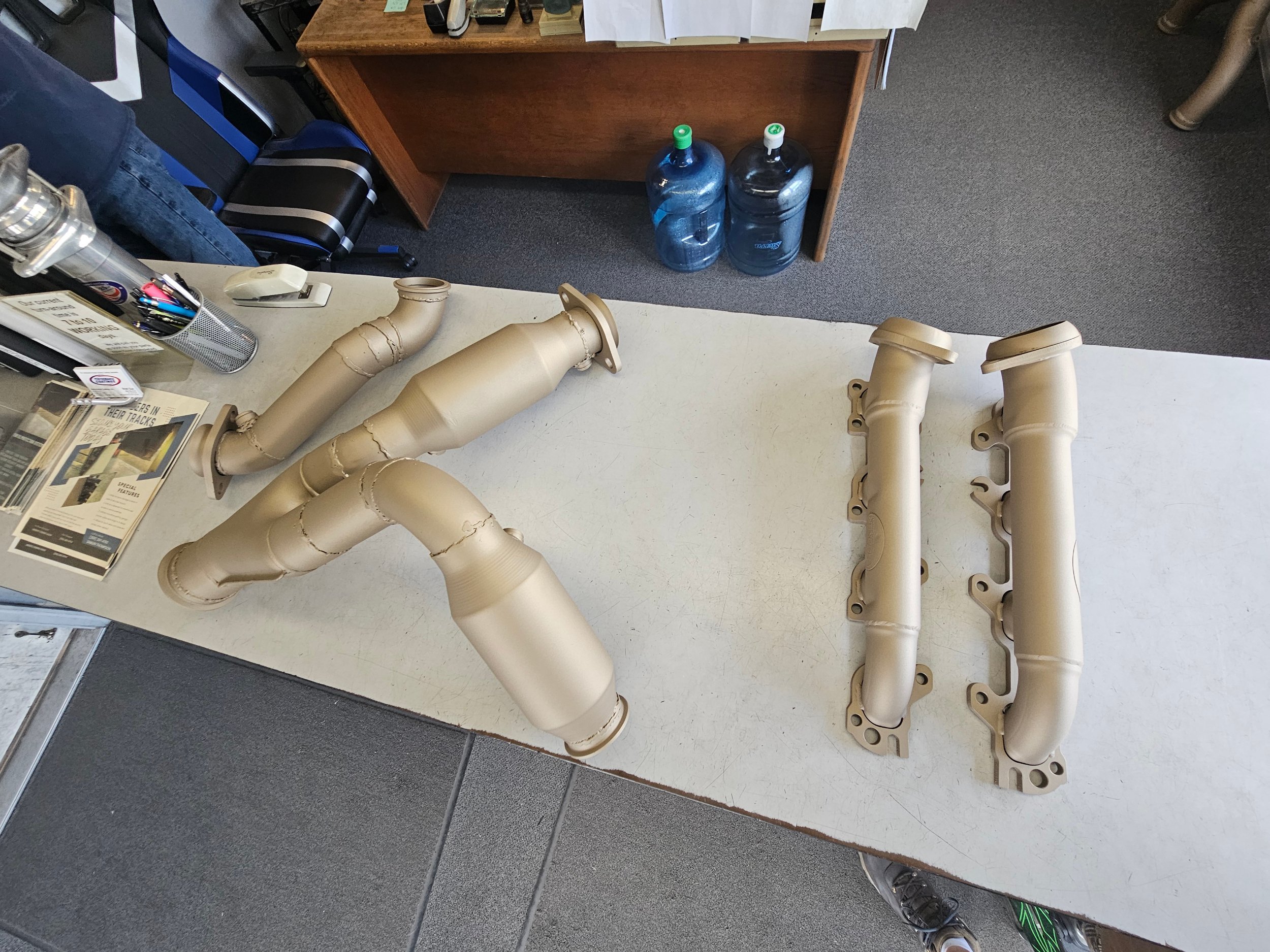

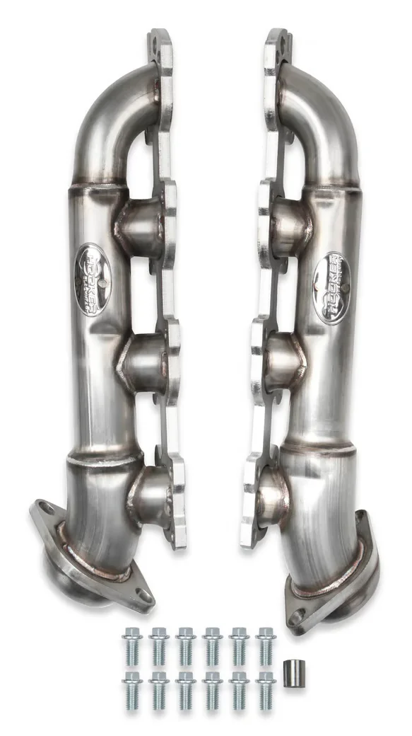

Large circle ports on the shorties. The circle ports are larger than the d-ports so they won’t restrict flow and they still use the factory SRT gasket. They seal up nice and I haven't had any issues with leaks or flow.

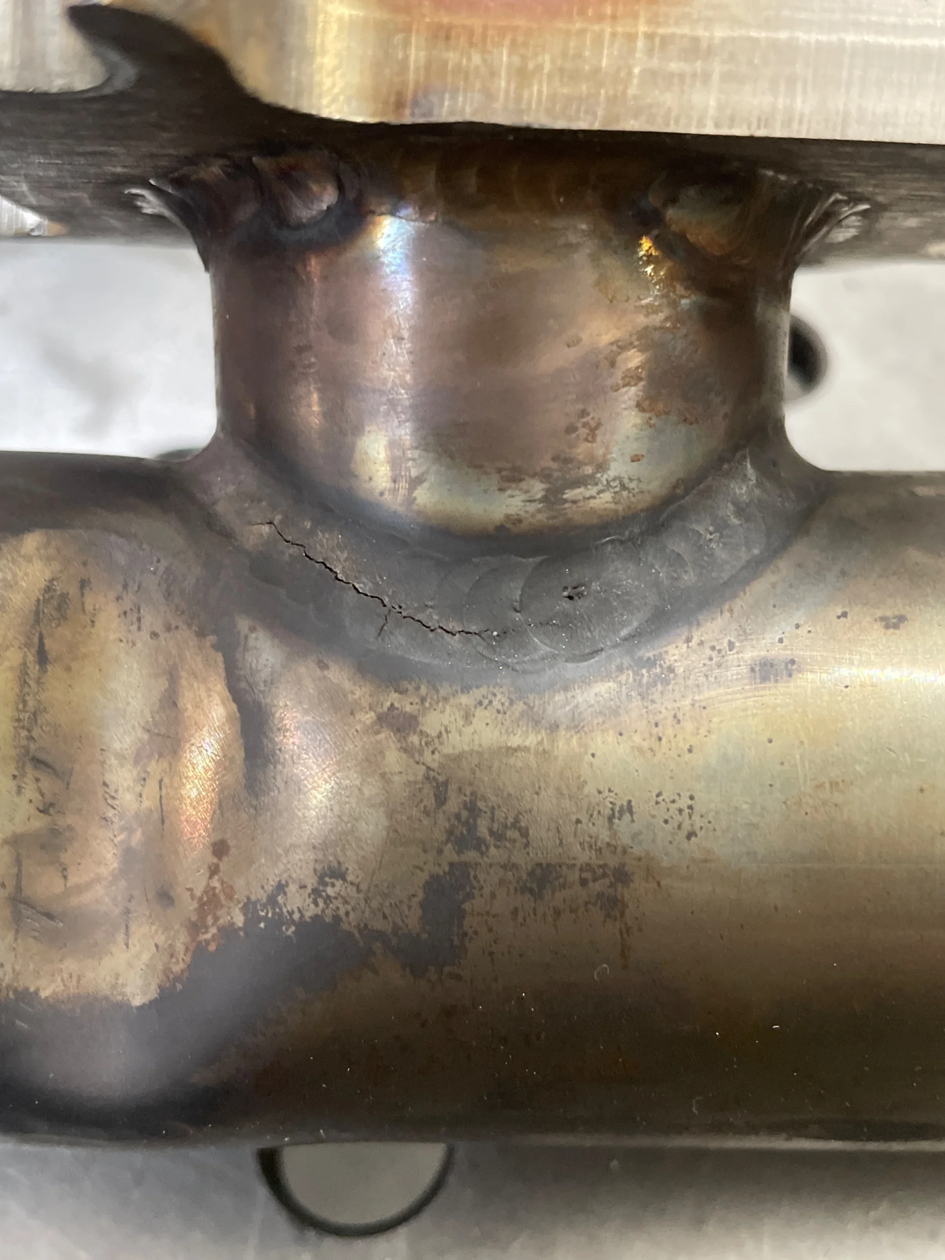

Update: Don’t use these as the welds cracked and had me chasing misfires. Spent way too much time fixing their welds and re-welded 90% of what Holley did. Finally got exhausted fixing their welds and built my own headers. Exhaust was fully supported with bellows and no stress on them.
