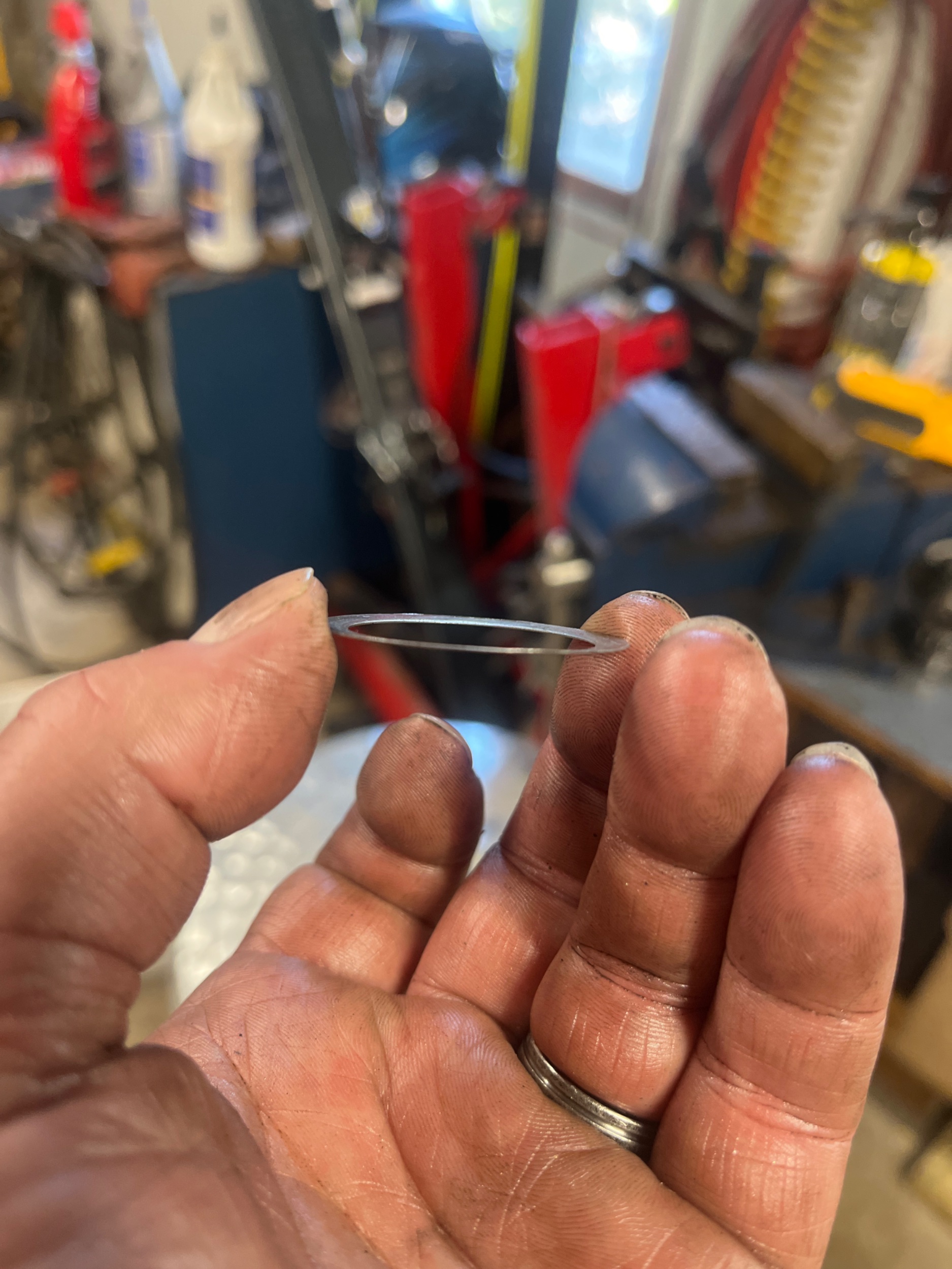

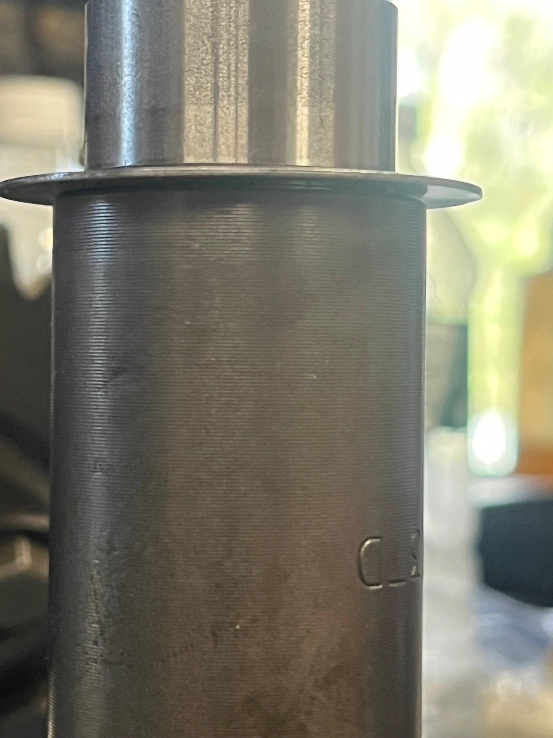

Not sure if you have seen this before. I was not comfortable with the pinion preload, it seemed jumpy and inconsistent, and the shims were not making much change as you would expect. I eventually found that the fillet on the inside of the land where the shims sit on the pinion was of a large enough radius that it was causing the shims to sit up about .010 from the land they sit on. When torqued down they were deforming the ID around it. I ground out the inside of one just enough to clear the fillet and let it sit flat on the land. Seemed to fix the issue and it now feels correct. Not sure if it was an issue with this specific pinion, I did not seem to have the issue on the front. I took pics best I could. I picked up eventually when I noticed it was deforming the shim
. View attachment 605489View attachment 605489View attachment 605490
That's a nice catch. There are a tone of small things like that that can cause a re-gear to get sideways. Whenever I have inconsistencies in pre-load the first thing I always do is pull everything out and clean out the housing and the parts. I've found a very small piece of my deadblow hammer that flaked off and got behind the race. Shim manufacturer inconsistencies like you found are also common.
Thanks, sorta weird, the factory one was undercut slightly in that area to not mess with shims. Didn’t seem to have the issue in the front,
