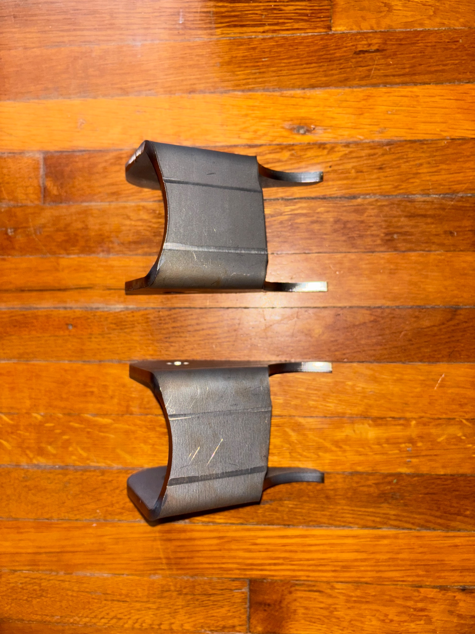

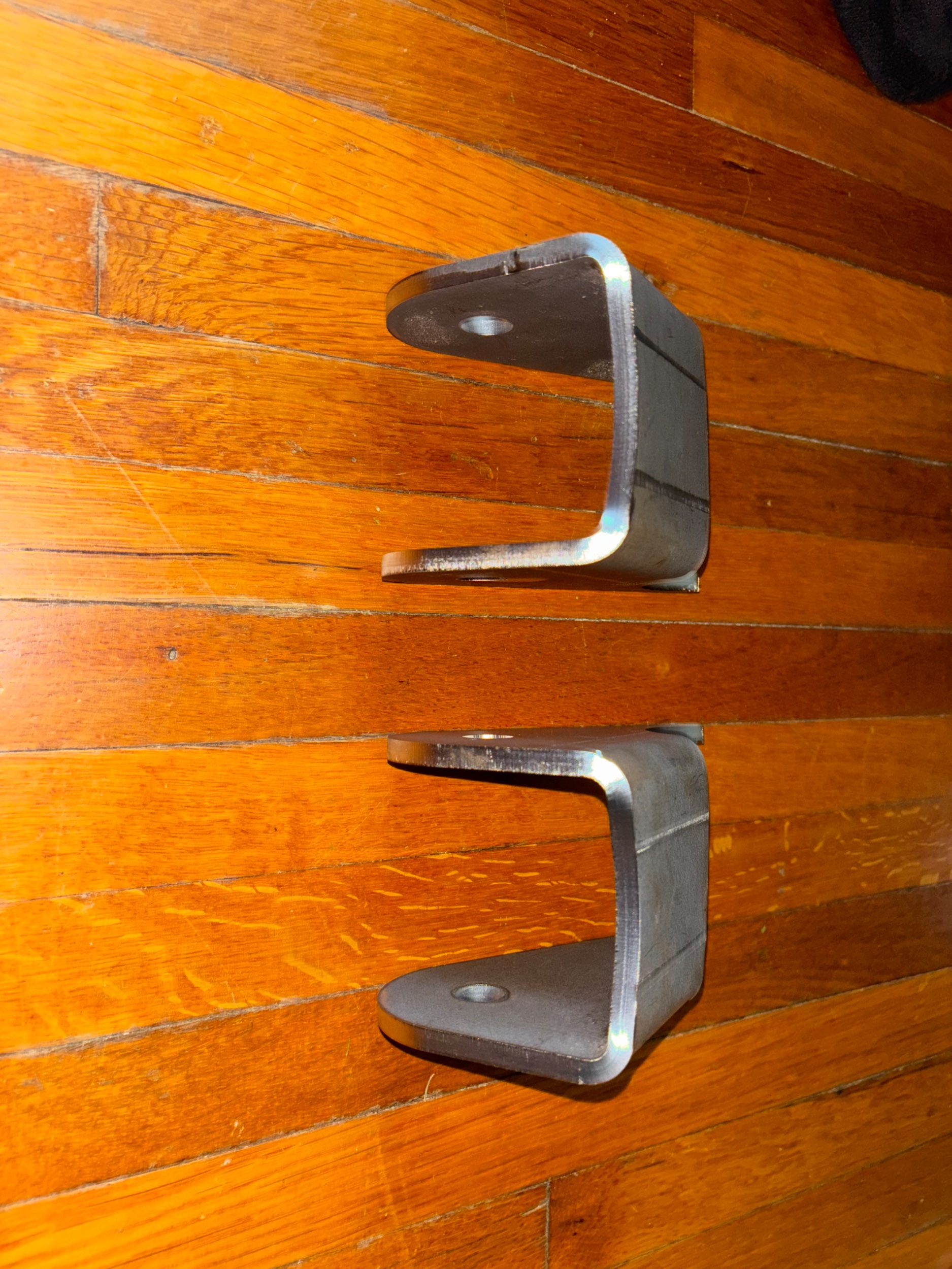

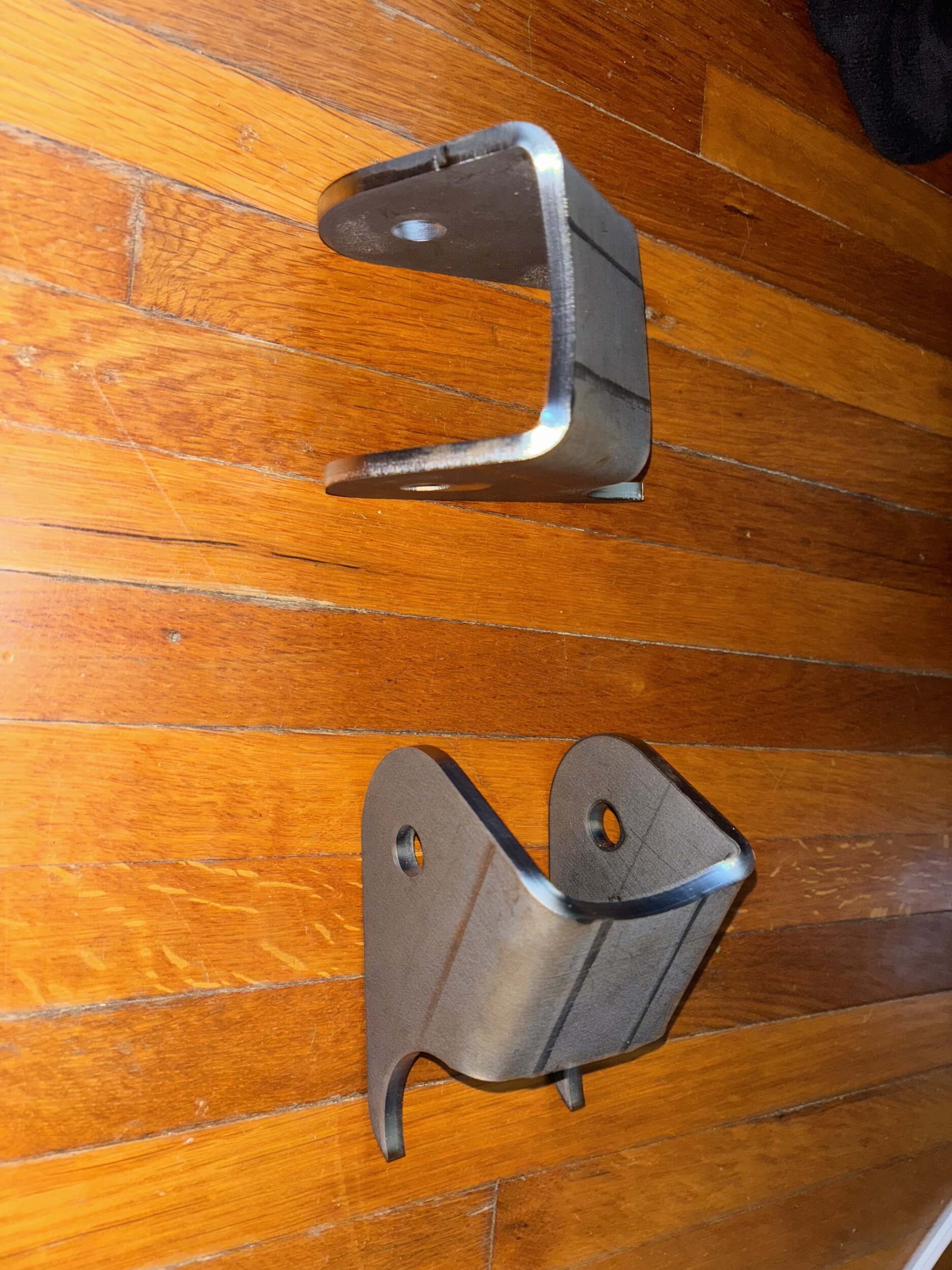

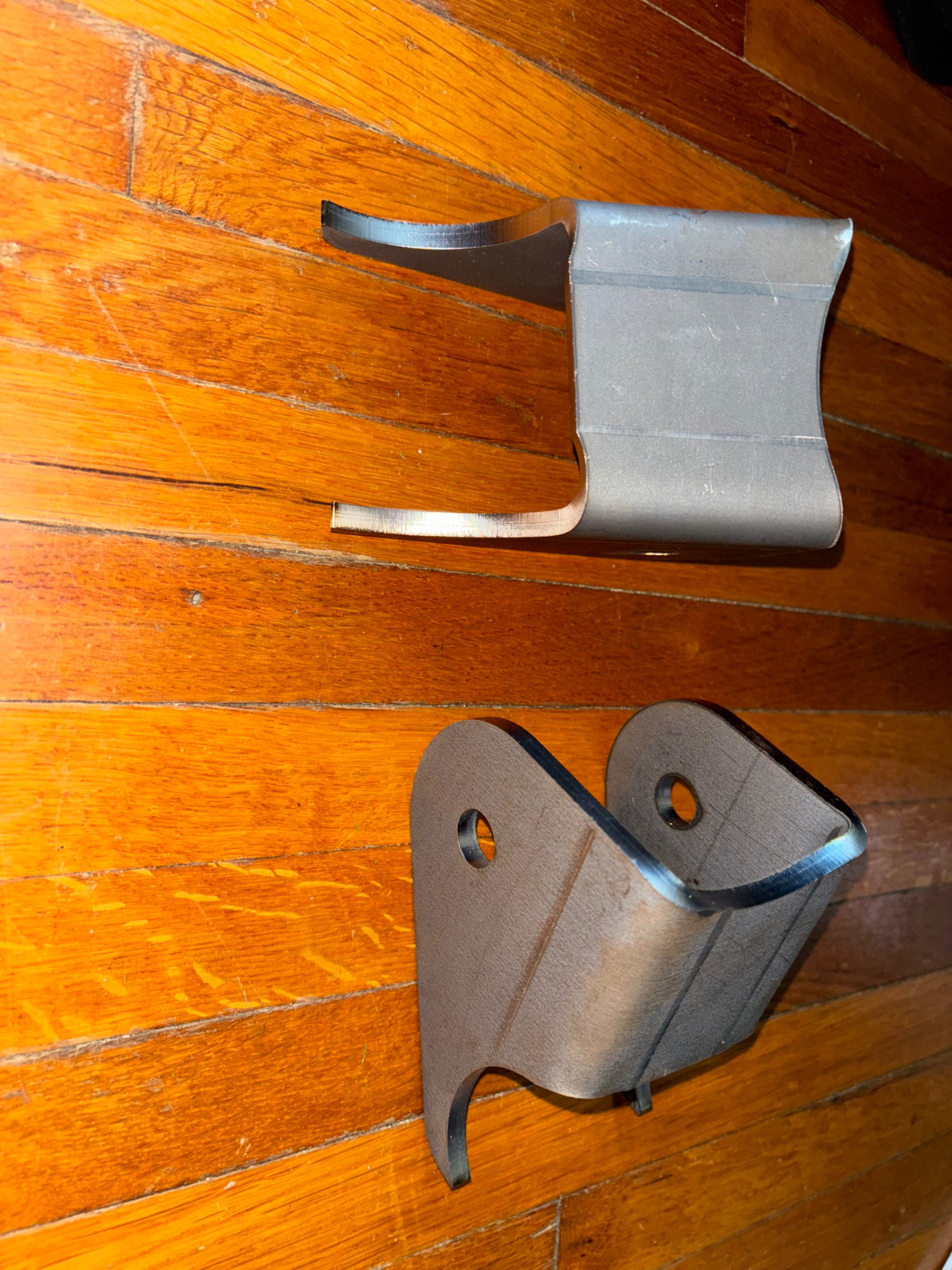

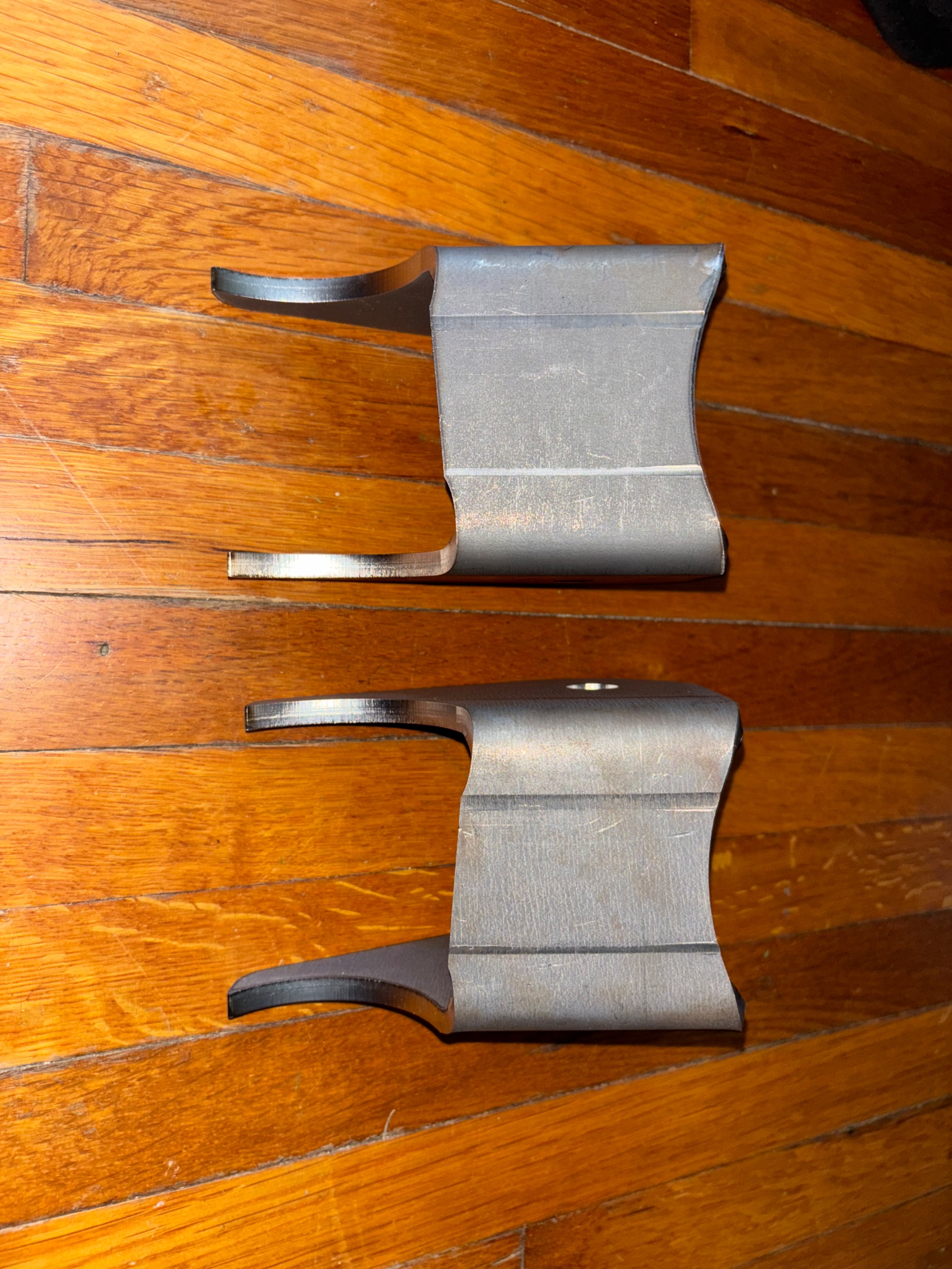

Hey, hope you all are having a wonderful day. I smashed in my driver side lower control arm mount pretty good. I ordered These from Iron Rock Offroad. Haven’t welded them in yet but some things to keep in mind are that the brackets are not the same for both sides. The left and right side are mirrored and Not identical. Note that the highest point of the bracket is pointing towards the Center of the vehicle.
Additionally, these do not use any Cam bolts or have the slots to weld on to support Cam Bolts. Could anyone recommend some hardware that would be suitable for my needs? Dana 30 Front Axle
