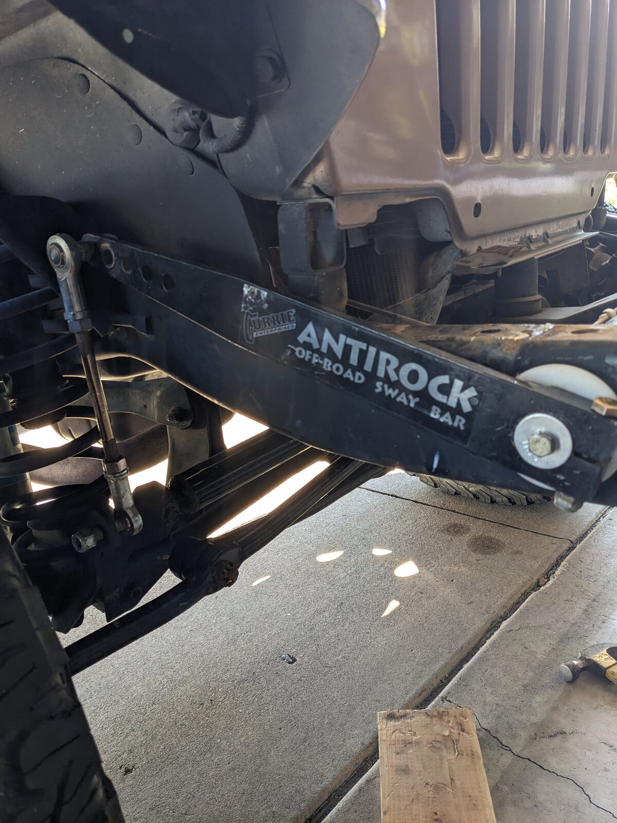

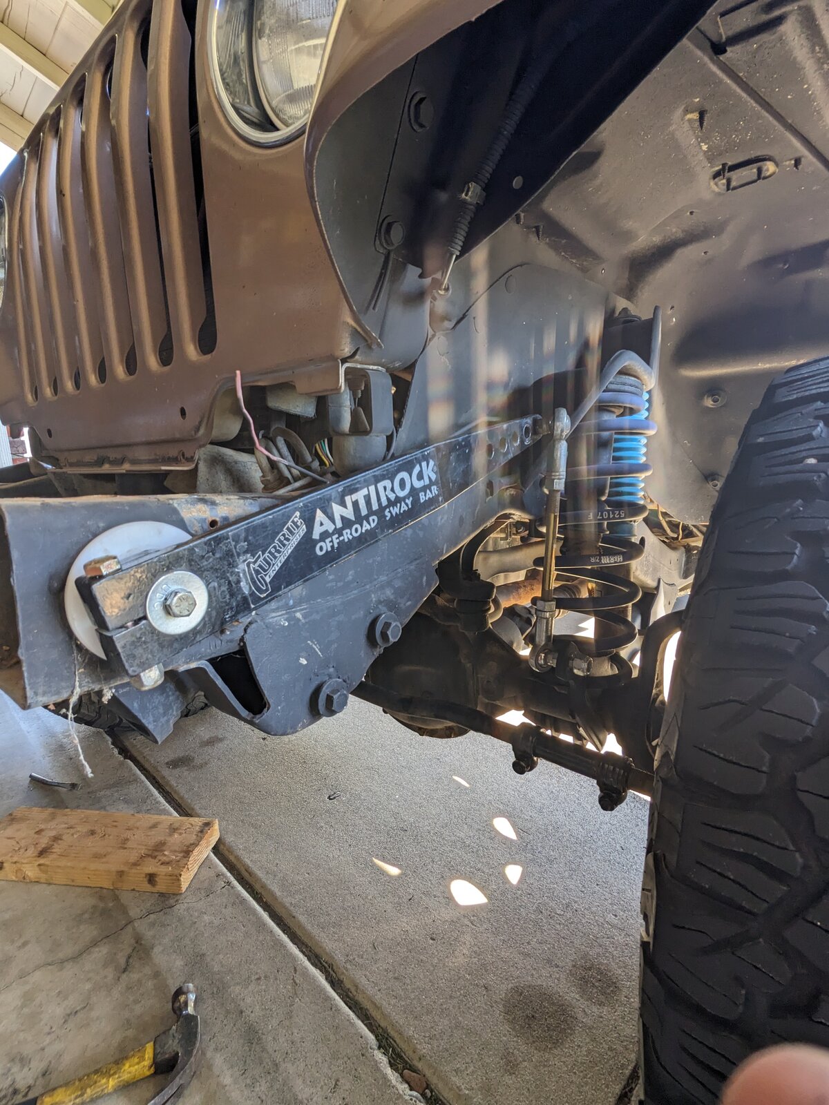

So on to my next problem which is regarding the anti rock. I got the sway bar arms installed and was trying to set up the sway bar link length by measuring the distance from the center of the sway bar hole to center of the mounting hole on the axle, which came out to 5.5".
The sway bar links for the anti rock are way too long to get anywhere close to 5.5". Check out the pics I took, you can see that the arms are way above parallel.
My Jeep suspension is stock ride height, with just a body lift at this point that we put on by prior owner.
Does anyone have experience installing an anti rock on a Jeep with stock suspension height? Do I need to cut these links shorter?

You’ll need to cut them, or I think Rock Jock sells shorter versions. I could be wrong and thinking of another company.

You could pull the front springs and move the axle to full bump to see if the arms contact the fenders. With the BL, they may not. If they do, shorten links and try again. If not, they're probably okay to run as is. Also of note, it looks like you have the H&R 1 - 1.5" lift springs.

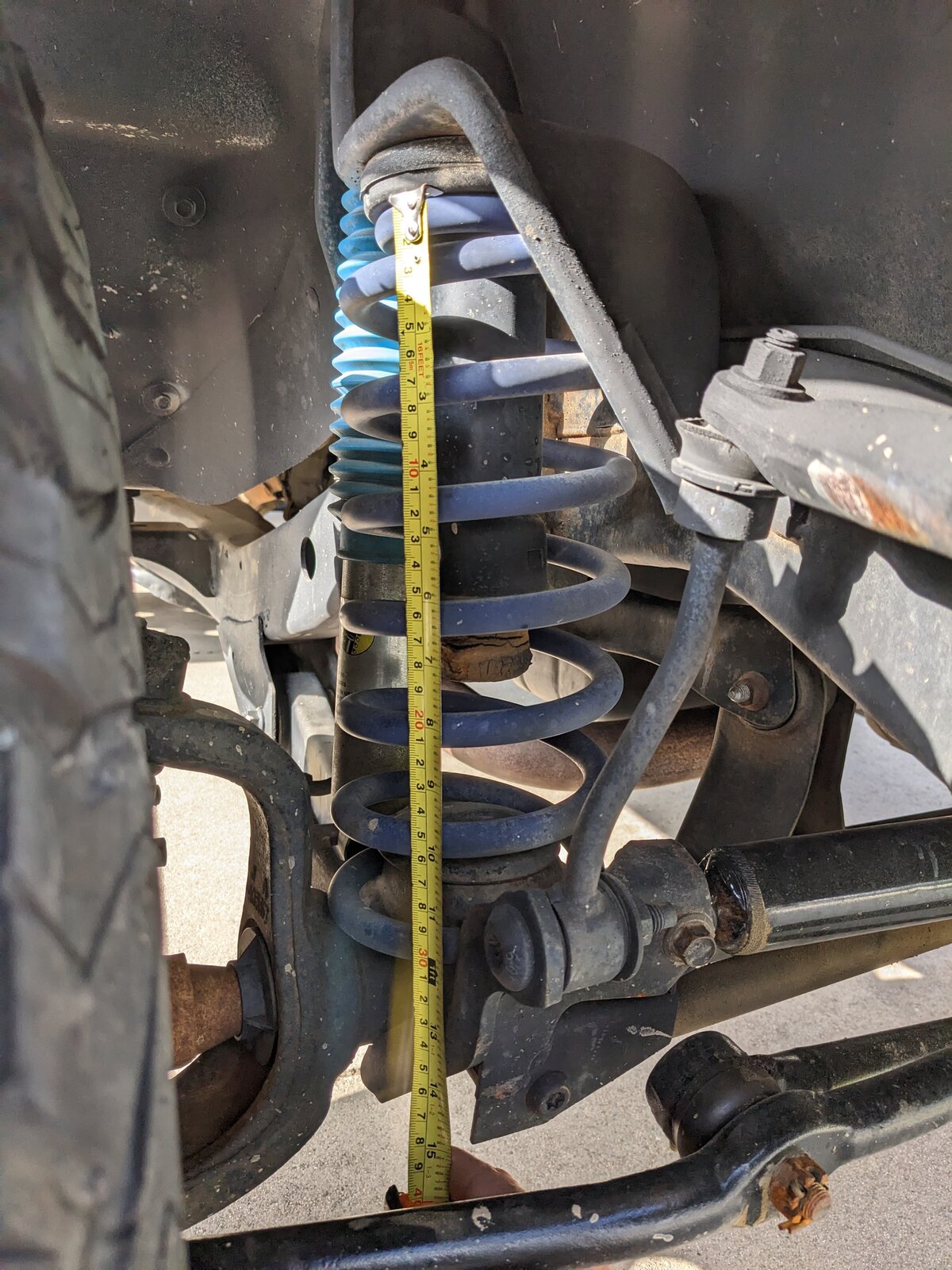

The shocks and springs were installed by a prior owner. I tried measuring them and they seem to come out to 12" which I thought was stock?
So as long as the sway bar arms don't contact anything at full stuff/full droop it should be good to run as is even with the arms above parallel?

I *believe* you want to very there is no contact between the arms and fenders at full stuff. On the droop side, links that are too short can invert. I cannot think of any issues that would be caused by them being longer than nominal at full droop.
As to the springs, I agree they appear to measure as stock. Looks like they're not living up to their promise. Here are the specs from H&R. (I know it says "lowering" in the chart header, but on the left it says "lift springs", and most seem to get 1" - 1.5" out of those.)
Cool, I'll try and verify no issues at full stuff.
The springs might not be giving me the 1"of lift because of the bumper and winch?
