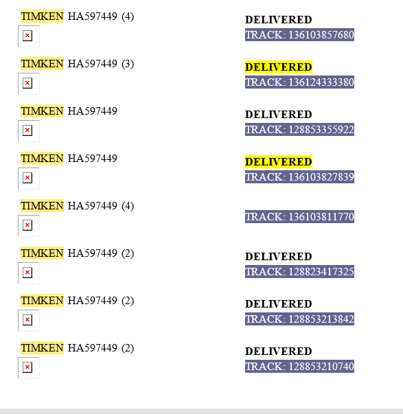

I've ordered batches of 20 unitbearings from them at least 8 times previous. Shows up in 1-2 boxes, takes 2 days to get here and cost me 25-30 bucks in shipping.
Last order for 20 shows up in the following manner and takes about 8 days all in for a cost of 125.

$125 shipping!?!?!
