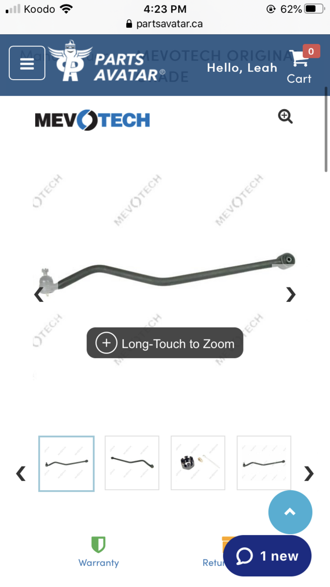

Track arm doesn’t need to be anything special right? I’m not going to buy the most expensive but this ones fine ya?

That will work as a replacement. The bushing quality would be my main concern.
I have no clue who Mevotech is, so I cannot comment on their quality.
I have no other comments, I do not want any geese thrown in my direction.
Just remember the bushings in the one you have are replaceable ... And you can get better bushings or upgrade to a JK bushing with a larger Bolt if you need to.. I would not buy a new track bar unless I was really sure that my existing one was not going to hold bushings and needed to save the fuss of replacing bushings.
There are a lot of high strength components on the market and they've got their place but it's the connection at the end that does the work for the most part... Some people will put on a ZJ tie rod and swear it made things better but what fix their jeep was the new tie rod end that came with it.
There are a lot of how high strength components on the market and they've got their place but it's the connection at the end that does the work for the most part... Some people will put on a ZJ tie rod and swear it made things better but what fix their jeep was the new tie rod end that came with it.
Thanks Andy!!! I was just looking at the tie rod end ...so you can buy these bushings and just replace it on the arm? I’m going to do this then because there’s nothing wrong with the bar....both ends of the track bar though you wouldn’t believe the movement just grabbing it and pulling up and down/ in and out ...insane. No wonder
To give you a frame of reference... If you can move that thing by hand that is absolutely off the charts... It normally takes the resistance of a 3500 pound Jeep to see anything.
