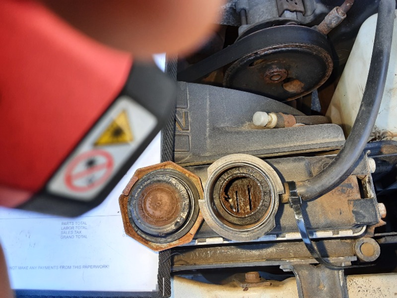

I was driving the other day and the engine shut off suddenly. I thought it stalled because it’s been sitting for a couple months so I turned it back on and let it run for a minute. I realized that it was over heating because steam immediately started pouring out from under the hood. The coolant line had popped off which I was able to zip tie back on temporarily. I had it towed to a mechanic in Philly and they claim that there is engine oil in the radiator which may be from internal engine damage. I’m not sure I believe them because it seemed like they were short staffed rushed through the whole explanation. I’m thinking there may be stop leak in the radiator making them think it’s engine oil?

Get a second opinion. If the engine is good, make sure and replace the entire cooling system. It looks rough.

That's a cruddy looking radiator. I'd get a second opinion, but you really need to address that cooling system. That line to the overflow tank will not cause any issues, so your problems are somewhere else. Check your oil, make sure it's at the proper level and there is no water, then fill the cooling system with water and look for leaks. If no obvious leaks, start it, let it idle and look for leaks and listen for odd, new sounds like knocking. If nothing obvious, watch the temp gauge climb to normal, and make sure it stays in the normal range. Keep an eye on your coolant level, but never open a hot cap.

I hope it's ok. If after fixing any and all cooling problems it continues to overheat it's probably a warped/cracked head, blown head gasket, or the like.
That radiator looks pretty rusty/cruddy. Maybe it plugged up to the point you are overheating? Bad headgasket goes both ways. How does your oil look, normal or chocolate milkshake which indicated water/coolant in the oil? Any baseline on when the coolant was last changed? How long have you had the Jeep.
With the engine cool and the radiator cap on, run it for a minute. Open the cap, major hiss? If so it may be a bad headgasket and leaking combustion pressure into the coolant.
Its still summer time temps, no fear of freezing, I'd limp it home and drain that nasty coolant. Then fill with distilled and some ThermoCure or similar coolant flush and flush out the system. This will also tell you if you have water pump or headgasket issues. I'd probably stop at the parts store on the way home as a new Denso Radiator and a couple hoses would not be a waste of money at this point if it doesn't start overheating on you within a few mins of run time.

Did it actually overheat (on the gauge) or did you just see steam due to the line popping off?
