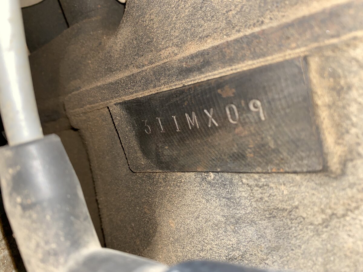

1996-2002
For the 2.5 and 4.0 engines it worked like this:
1. 1st digit – the year (for example 4 = 1994)
2. 2nd and 3rd digit – the month (01-12)
3. 4th and 5th letter – the engine type (MX = 4.0L) (HX = 2.5L)
4. 6th and 7th digit – the day of the engine month (01-31).
For example 601HX23 = January 23, 1996, 4 cylinder
and the last 8 digits of the VIN were used.

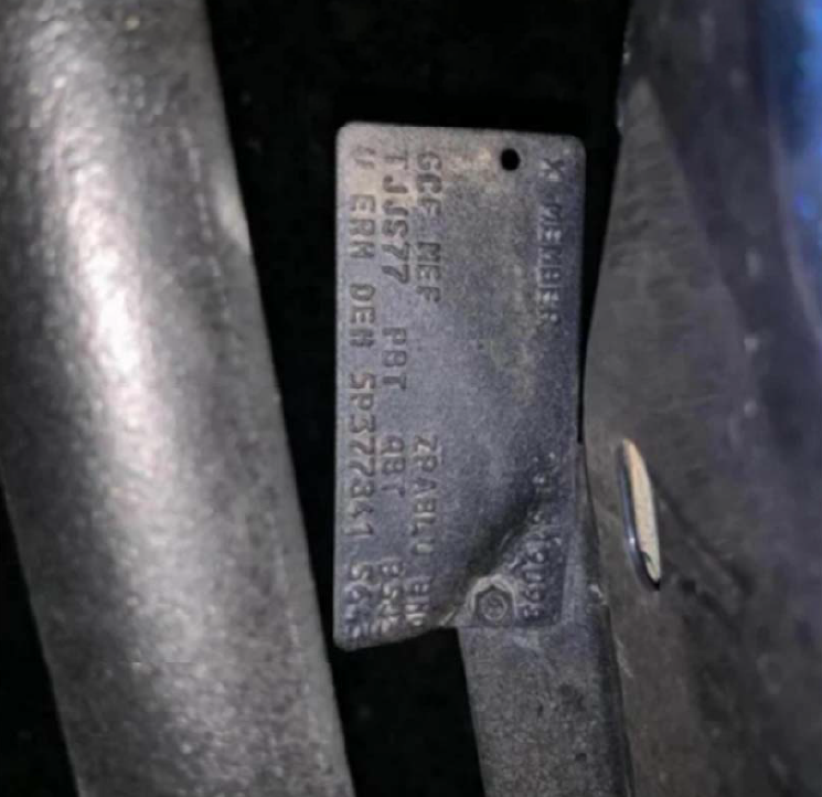

2003-2006. cant find anything. only thing I found was a tag of a 2005 rubicon 4.0L 6 cylinder:
It looks like the 8 last digits of the VIN are on there..

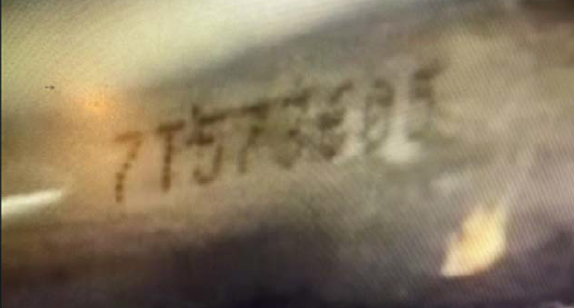

The 2.4 Cherokee engines have the last 8 Digits of the VIN number:
Chrysler PT cruiser 2007 2.4 engine has also last 8 digits of the VIN:

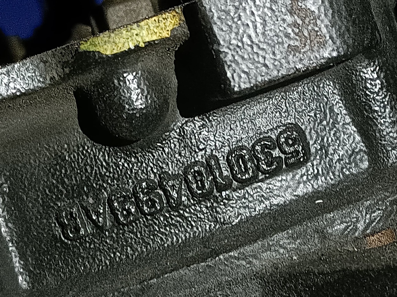

Wrangler 2010:

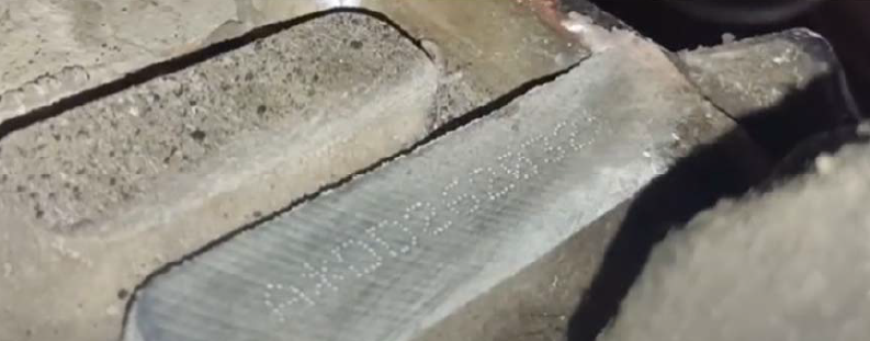

Wrangler 2015: (looks like my 3 years old engraved that)

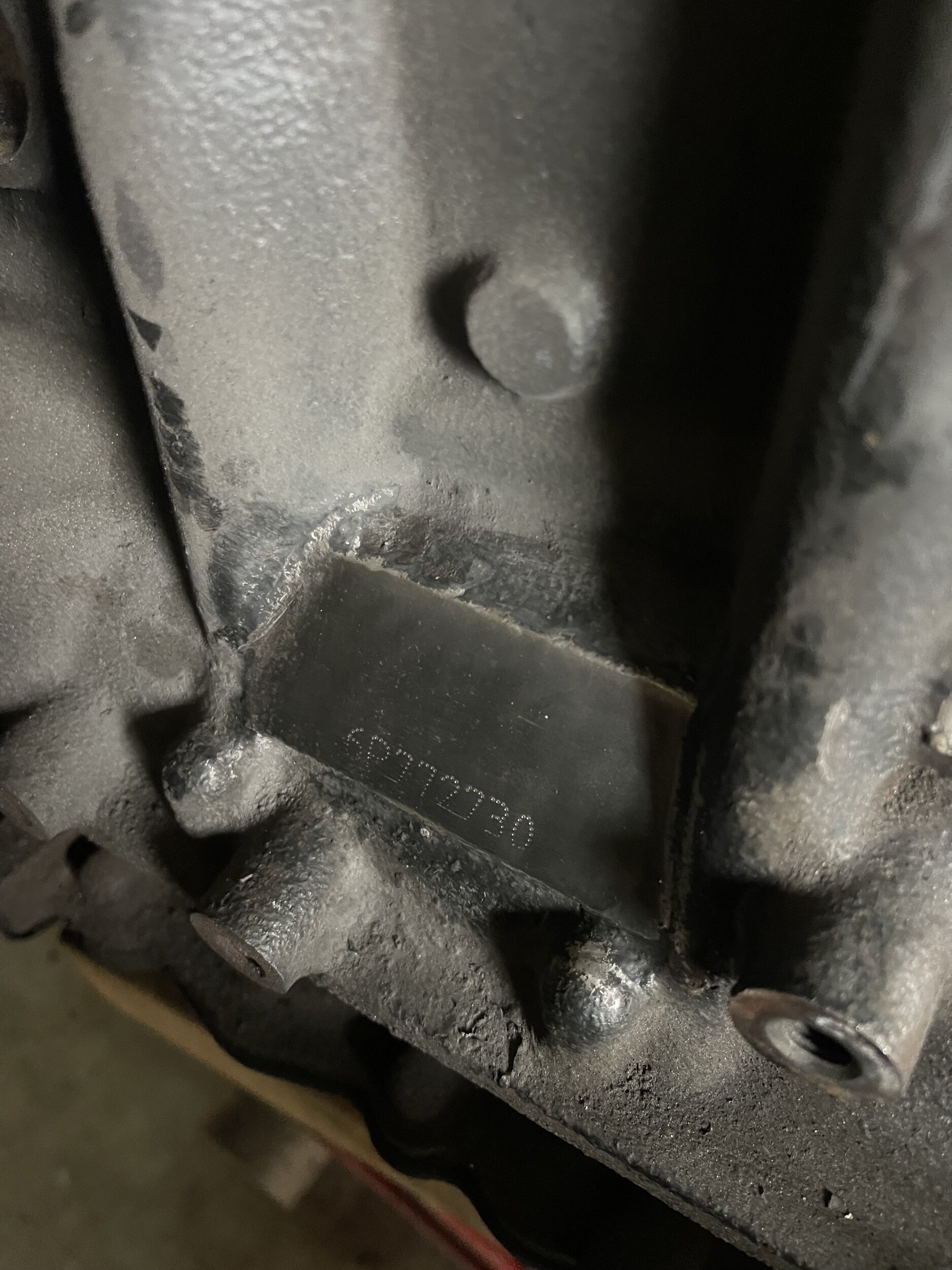

Wrangler 2017: (same as last digits of VIN)

Correct me if I'm wrong! :unsure:
1996-1999
As I stated in post #12 this is just a build date code. Not an engine number. There could be hundreds of engines with the same build date code on.
The VIN is marked on the early TJs too.
AH! I completly missed that, just looked at the picture....:sleep:
(I edited it)
but then it makes much more sence to put the last digits of the VIN in!

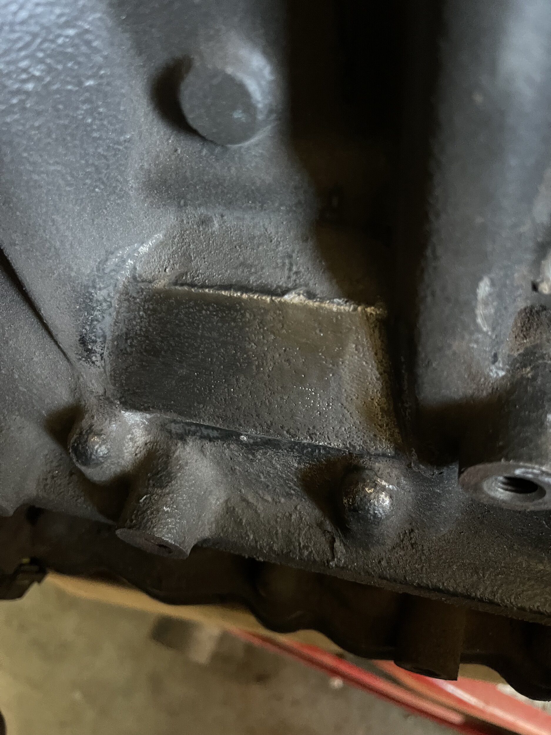

The Spanish guy replied with a picture.
Finally something I can work with.
It definitely looks like the last 8 digits of the VIN.

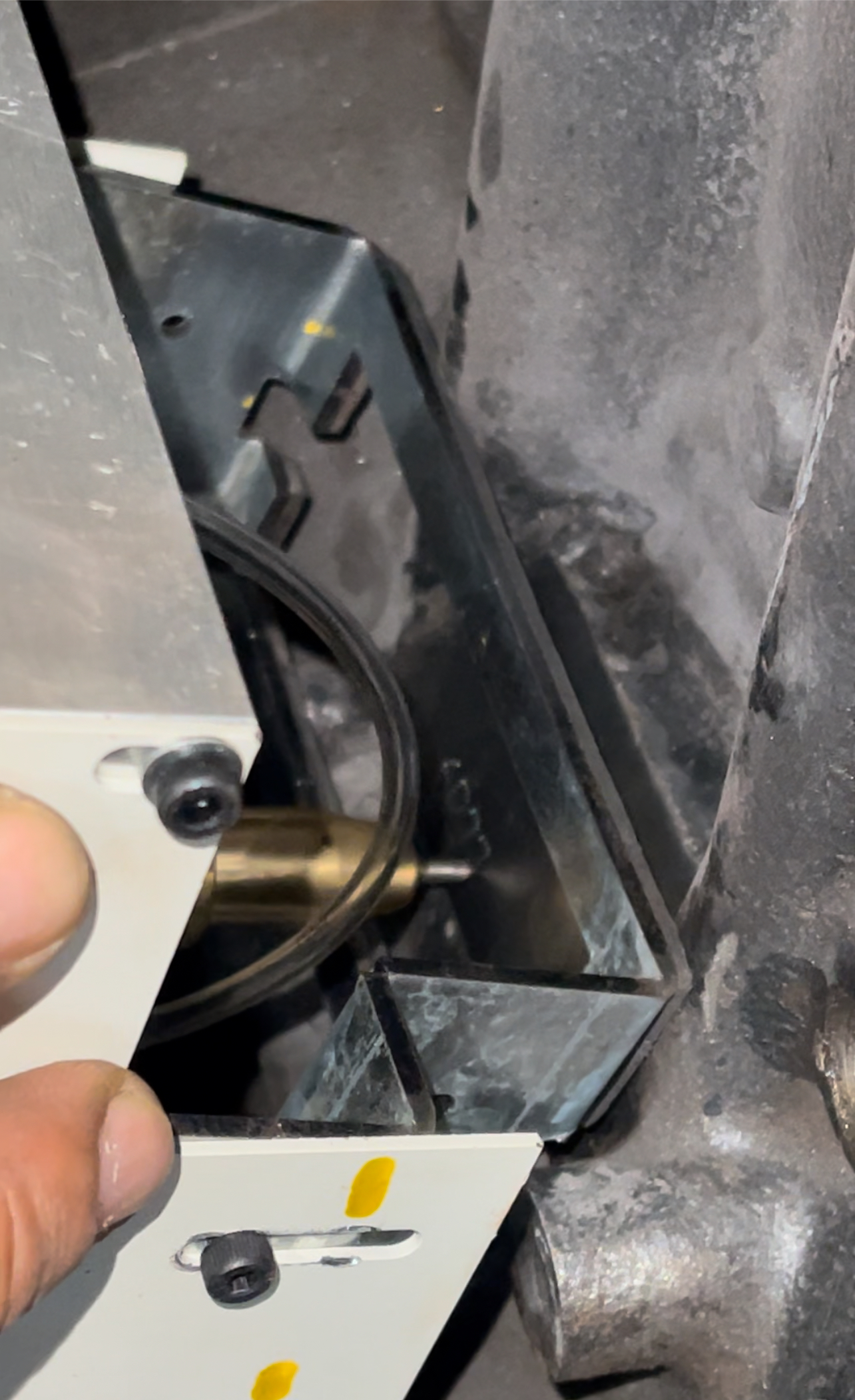

So I will just ask my guy to engrave my last 8 digits in the engine.
Thanks a lot for all the help and listening to my complaints.
I hope your morning is going to be as good as mine!
Cheers!
Reactions: JMT
That looks like a part number lots of Jeep parts numbers begin 5301. I can't find it in an online search but it might be in the parts lists I have on my laptop at home.
Ignore that, the last pic has just loaded on my phone. That does indeed look like the last 8 of a VIN.

I know, It is the same part number as my engine. So it has to be the same.
It kind of make sense if they engraved the VIN number in before they installed the engine.
Mine got a new engine in 2008 according to the jeep records. So they probably didn’t engraved the VIN number in. Just put the new engine.

Anyway, this weekend I’m going to slap that number on it. And Monday inspection.. Jezus..

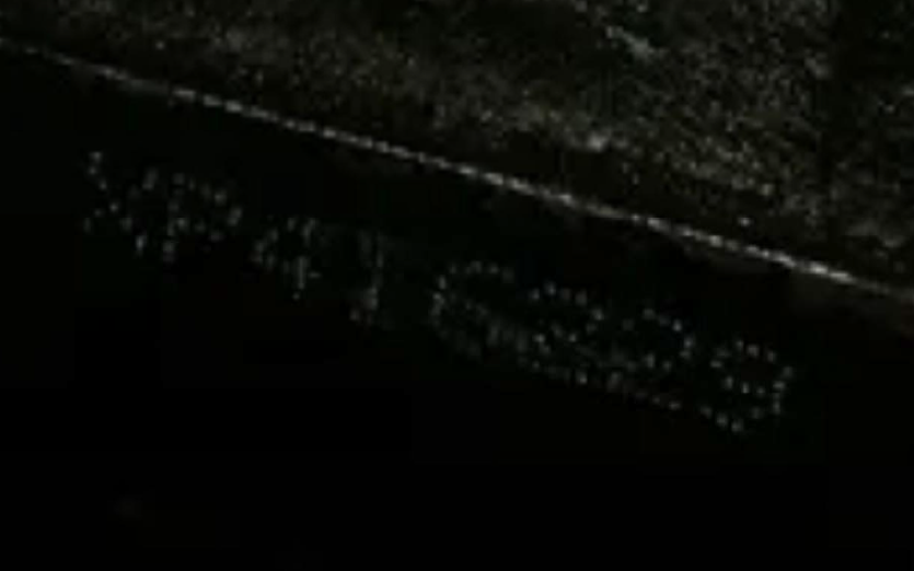

So engine number is in again.
When I was taking everything apart I found out that my manifold was cracked so changed that also. When I was sending the old “numbers” out they were getting a bit more visible.. it definitely showed the last 8 digits of my VIN, today we put it back.
Little bit lower that original, but I’m alright with it.
Anyway, if anyone is looking for it.
2.4L 2003-2006 engine numbers are the last 8 digits of the VIN number. Case solved.

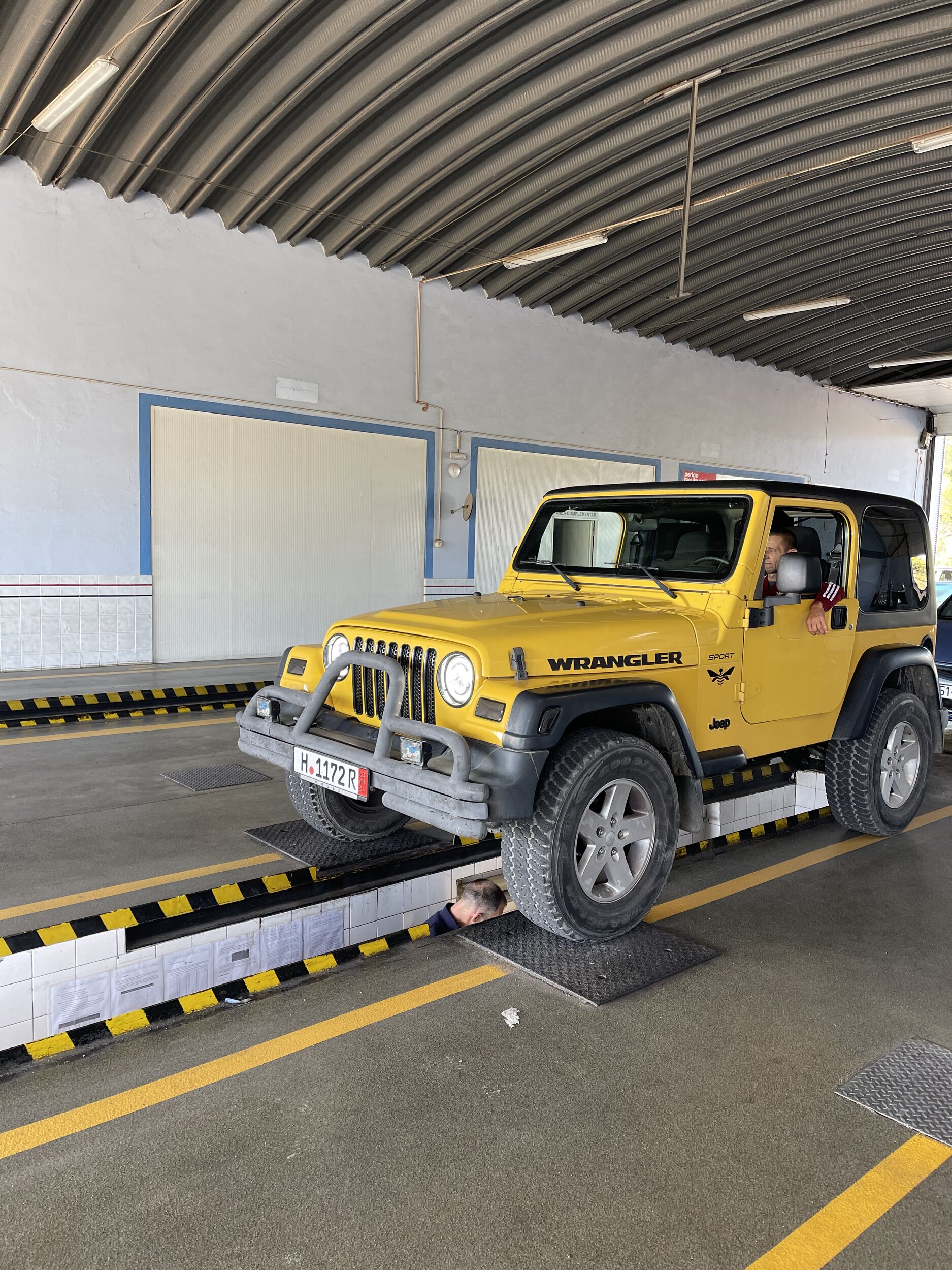

So, inspection is done and it passed!
Now I can finally remove that hideous bullbar 😂
Now pay the import tax of 4900,- euros and hopefully soon my Portugese plates.
