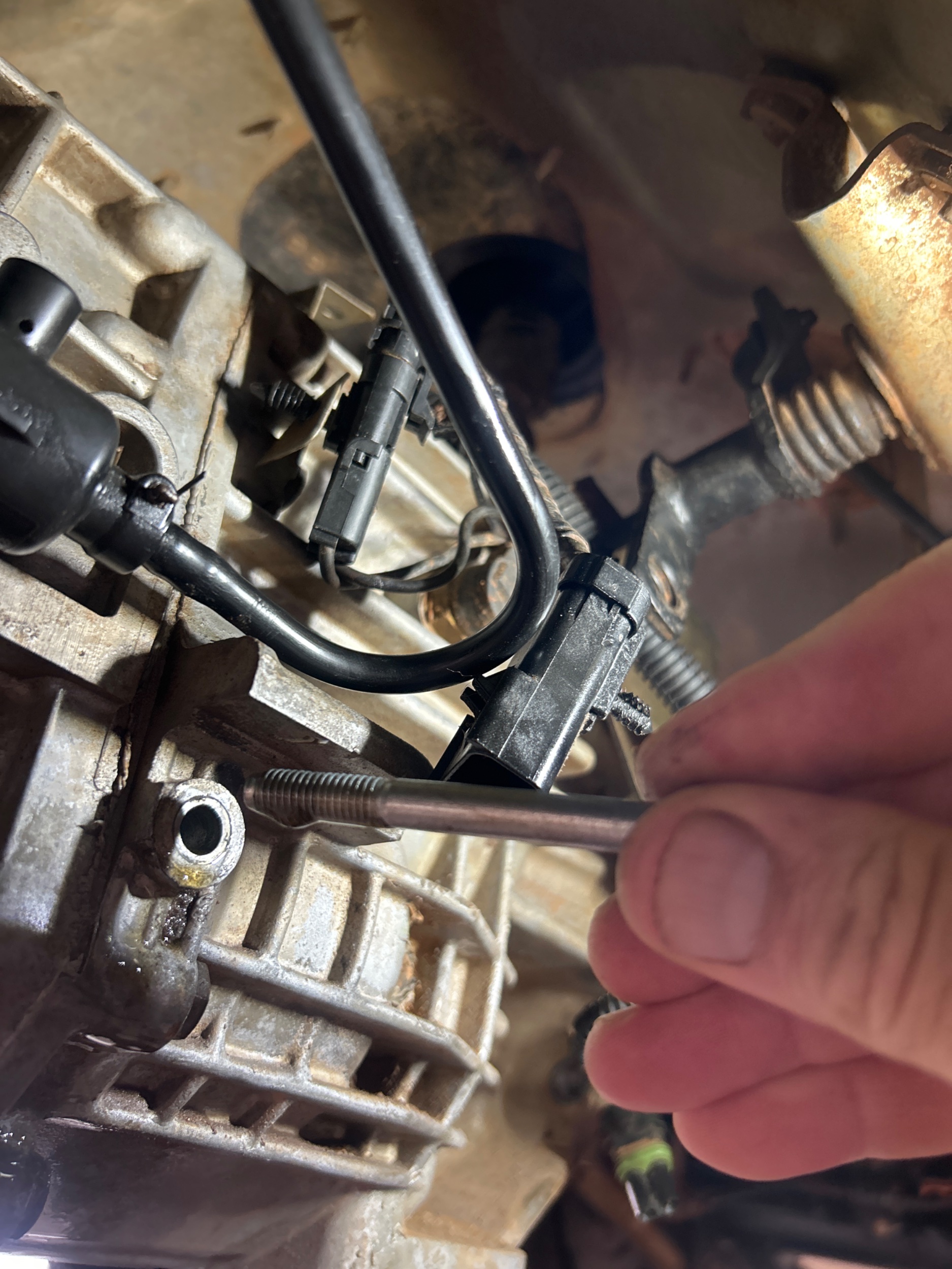

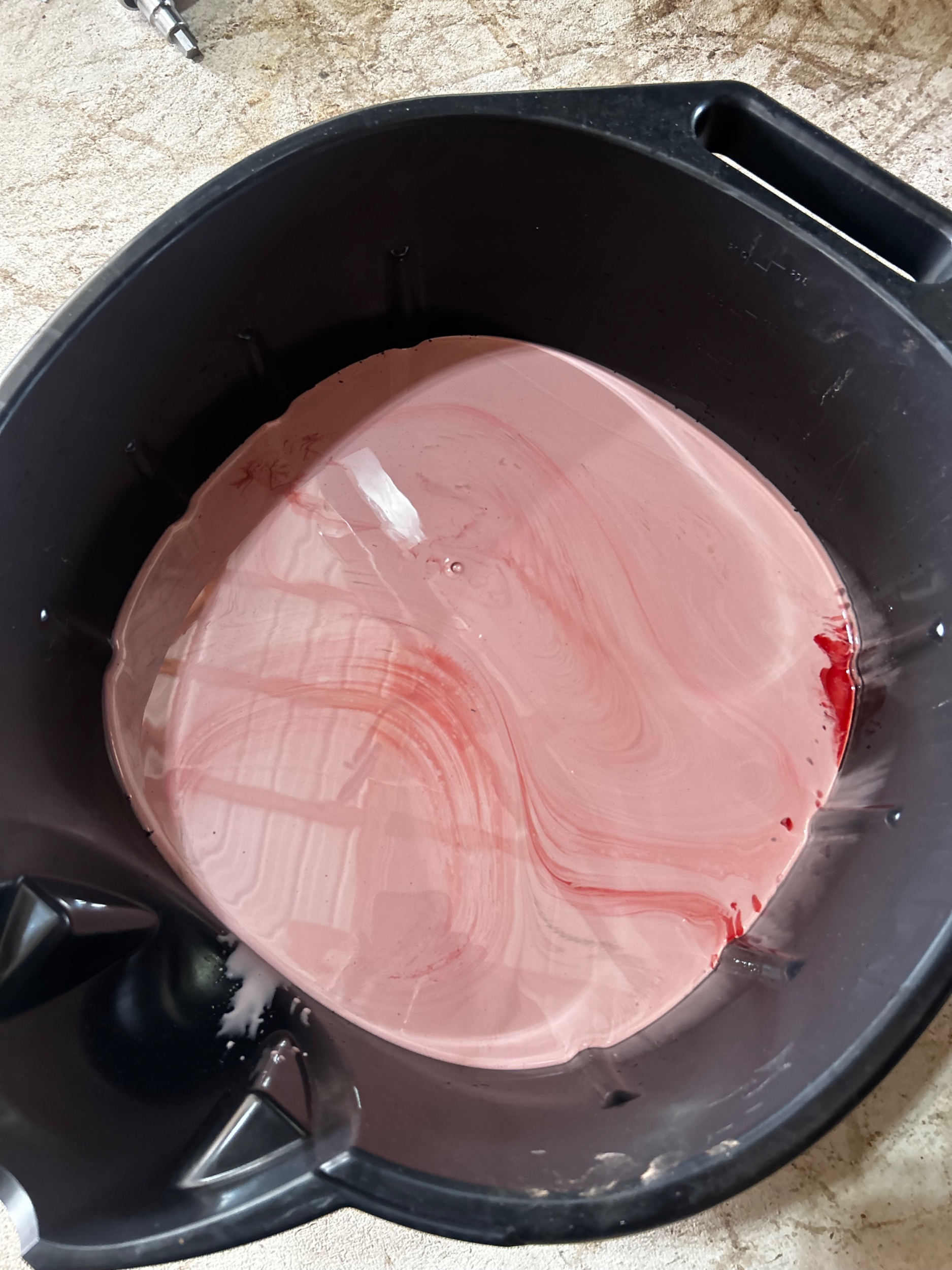

Where did all this fluid come from?
Flood victim Id guess. No way washing it would get that much H20 in the T case. Check the diffs asap also just to be sure.
All look good. I agree that it seems like a lot of water from just a wash but it was a wash and a wet sand. Everything else looks good. Glad i checked anyway. Thanks
Thank you for pointing that out. :unsure:

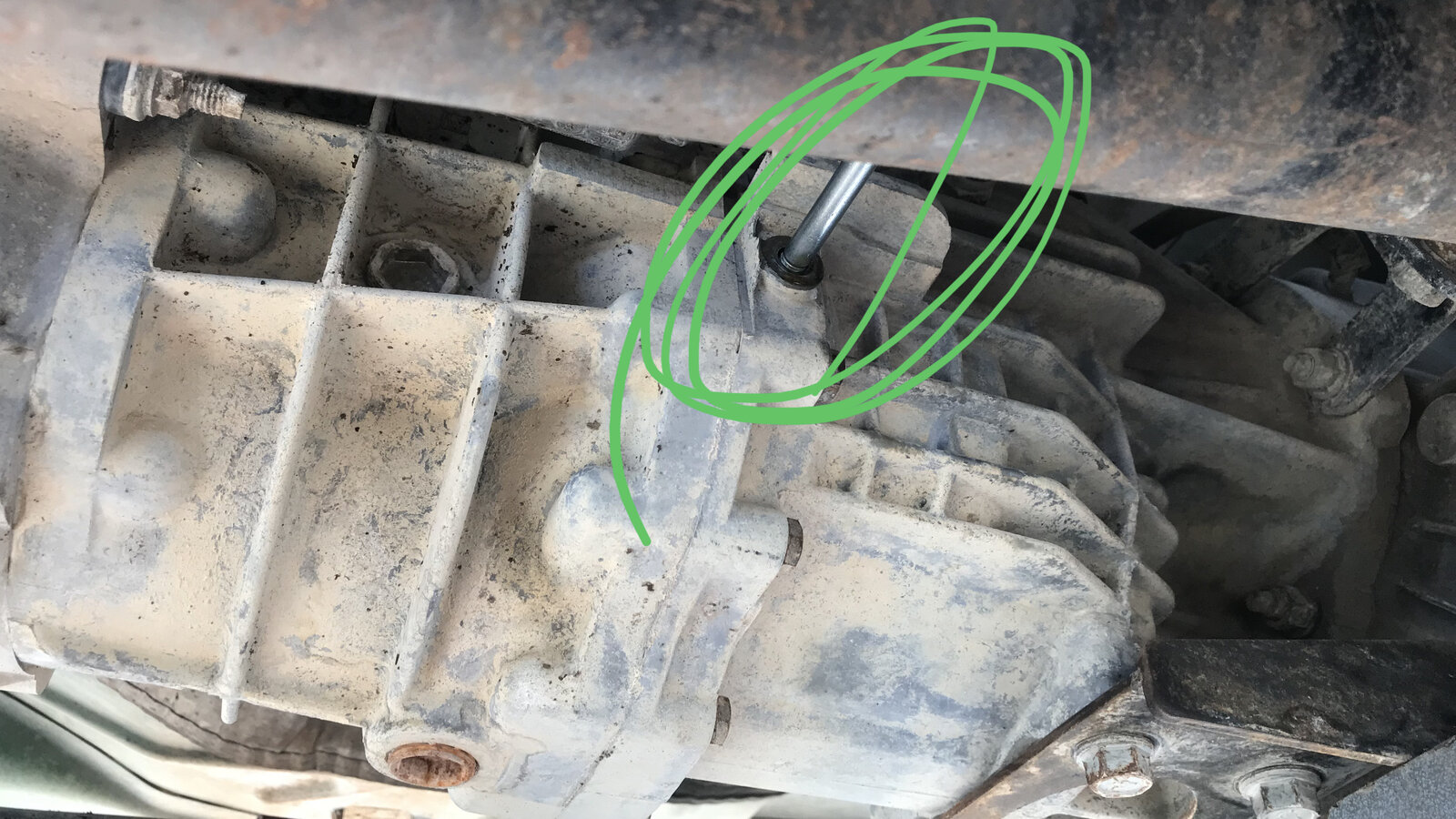

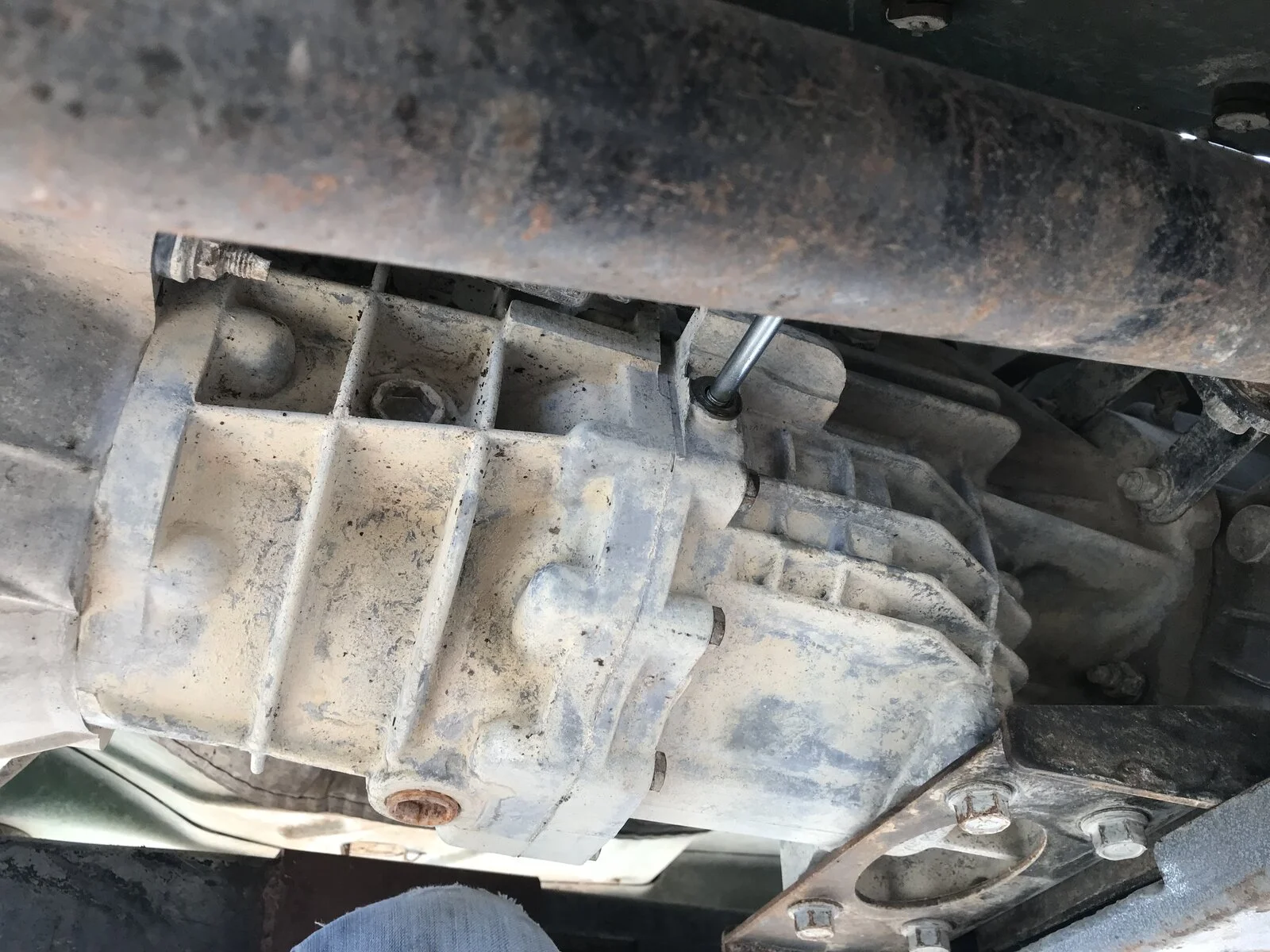

New breathers can be had from amazon and the like. You can also extend those way up out of waters likely entry point. Well, I should say for most anyhow.

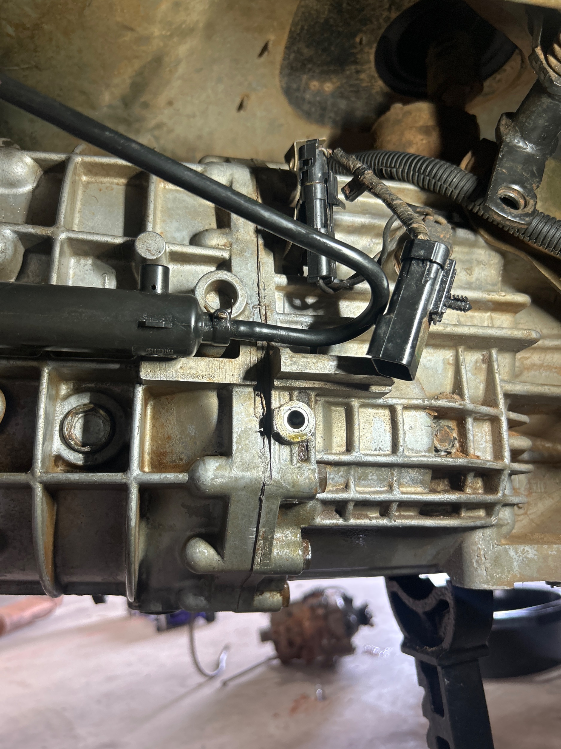

I had a crack in the front of my 231J that I chased for months.
No pink milkshake but six carwashes later and the back is still entombed in dusty ATF.
