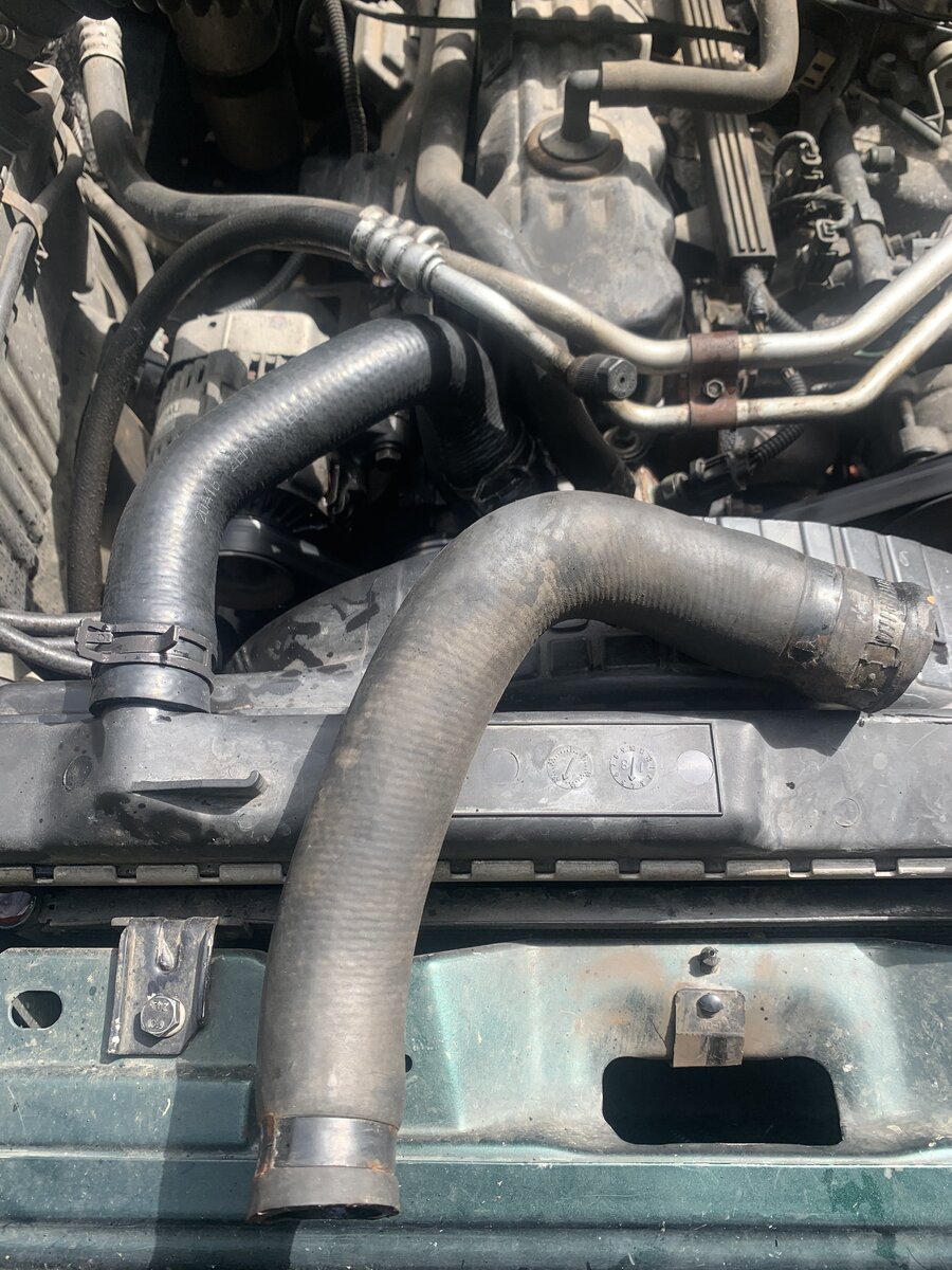

So I’ve been chasing a significant coolant leak for a week or so now and today was the day to wrap this up. I thought I had narrowed it down to the water pump and furthermore thought it was the gasket. It was not. On my Mopar water pump the weep hole is on the top so I had to remove the pulley to verify it was not coming out of that and it wasn’t. It was actually coming from above the water pump completely and turns out it was coming out of the inner underside of the upper radiator hose. Tightthat clamp up and added a 2nd one for safe measures until I replace the hose itself.
Hard to believe this went from almost replacing a water pump to simply tightening and adding a hose clamp.

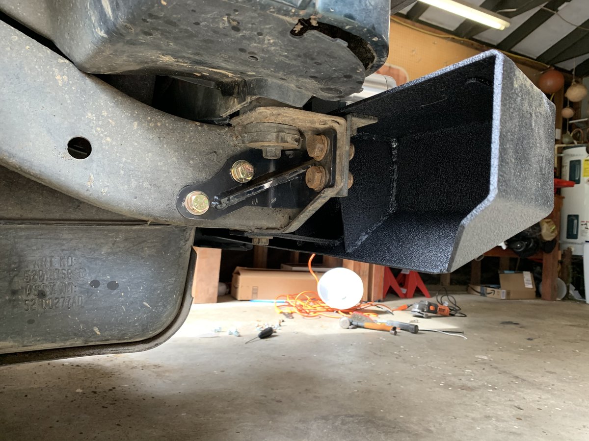

Also new EAG tire carrier addition. Last week some time I accidentally bumped my spare into a tree in the forest and it caved in my tailgate pretty good. Bent it back into shape with some 2x4’s and decided to try out this tire carrier instead.

Threw in the new Gates upper radiator hose today along with the 2 clamps from @MountaineerTom (thanks again buddy)! Those went on perfect and the leak is finally gone there.

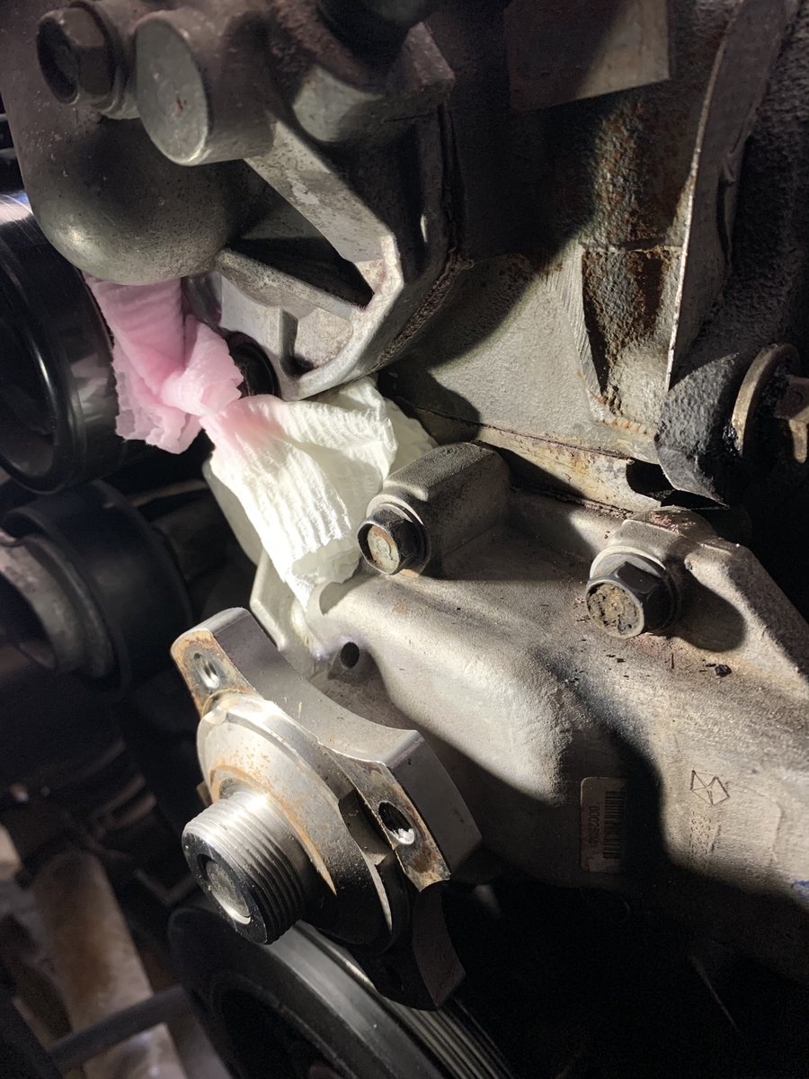

Now I seem to have an oil leak somewhere in the lower front driver side of the engine...🤬 There was a couple different small spots where oil was dripping down off of control arms, tie rods and the diff. Not sure where to start looking or what the best approach is for finding that leak. Oil seems to be hitting the fan a little too as there was spray on the inside of my hood. Any common areas anyone could highlight for me that would leak oil and hit the fan?
I just noticed the other day that my radiator hose is ramming right into those AC lines there. Was yours doing that? And did you get the Gates to resolve that?

Crank seal maybe? Check around the harmonic balancer.
Oh I hope not...would not look forward to replacing that seal, it’s pretty buried.
Will check it out though on my next dry day outside.
