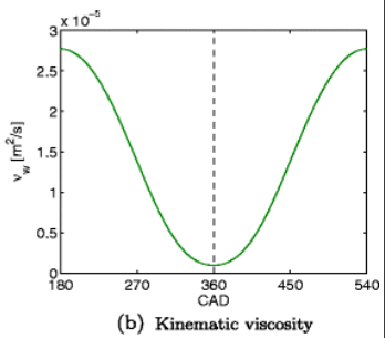

If you want to get real deep in the weeds there, think about this, with piston speed, at a certain point the rings will begin to hydroplane on a thin film of oil on the cylinder walls and lose friction, but when piston speed slows down below that threshold the rings break through the boundary layer and friction increases back to "normal", and that happens with every stroke when pistons speeds are fast enough. I hope that makes sense, and if your head starts hurting thinking about that, that's normal. :sneaky:
This is about the best representative graphic I could find. Think of the middle as max speed/least friction.
