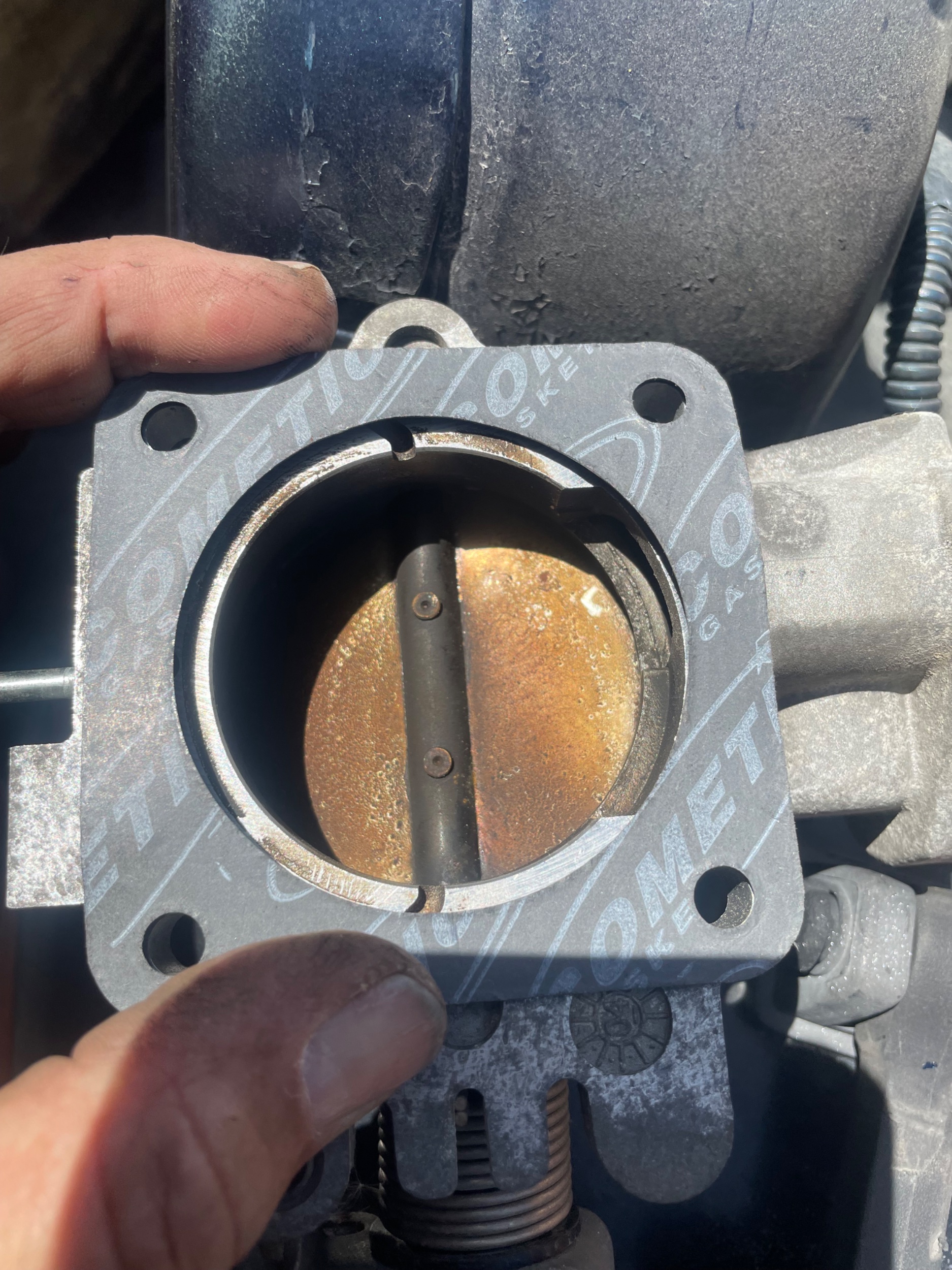

This is the Holley throttle body sized difference from stock, the gasket is the oversized diameter.
When I installed my stroker, I used a 62 mm BBK throttlebody instead of stock which was maybe 6 mm less in diameter? The BBK unit matched the opening in the stock manifold so that made me feel good but no idea whether it makes a difference. So, I’m looking forward to @Jezza ’s data (although it won’t directly correlate because presumably the 4.0 needs less air than a 4.6).
Because of the better flowing heads I put on the Hemi I got a larger throttle body also. Have no clue if it helps or not... One day I do want to get it on a dyno.

That absolutely makes sense. In my case, the 4.6 stroker is making about 25% more HP and TQ than my prior 4.0 (not bad with only a 15% displacement bump). I think the extra 10% likely comes from a more aggressive cam and larger injectors because the the tune/ECM are still stock. Although the stock 4.0 is not supposed to be restricted by the stock air box or throttle body size (@Jezza's work will likely confirm or deny that), I wonder if my stroker actually benefits from the larger 62mm throttle body or is restricted by the stock air box (which I would probably keep because its a good design to protect against water ingestion in stream crossings).
What is the i.d. of the piping in front of the throttle body? If smaller, which I assume it is, it is a potential choke point, but then the question is at what point in the RPM/power range does it begin choking the intake.
