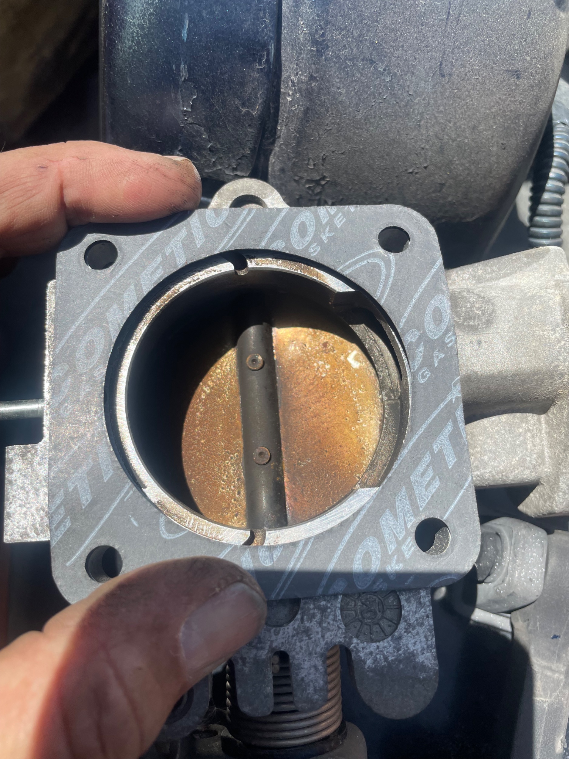

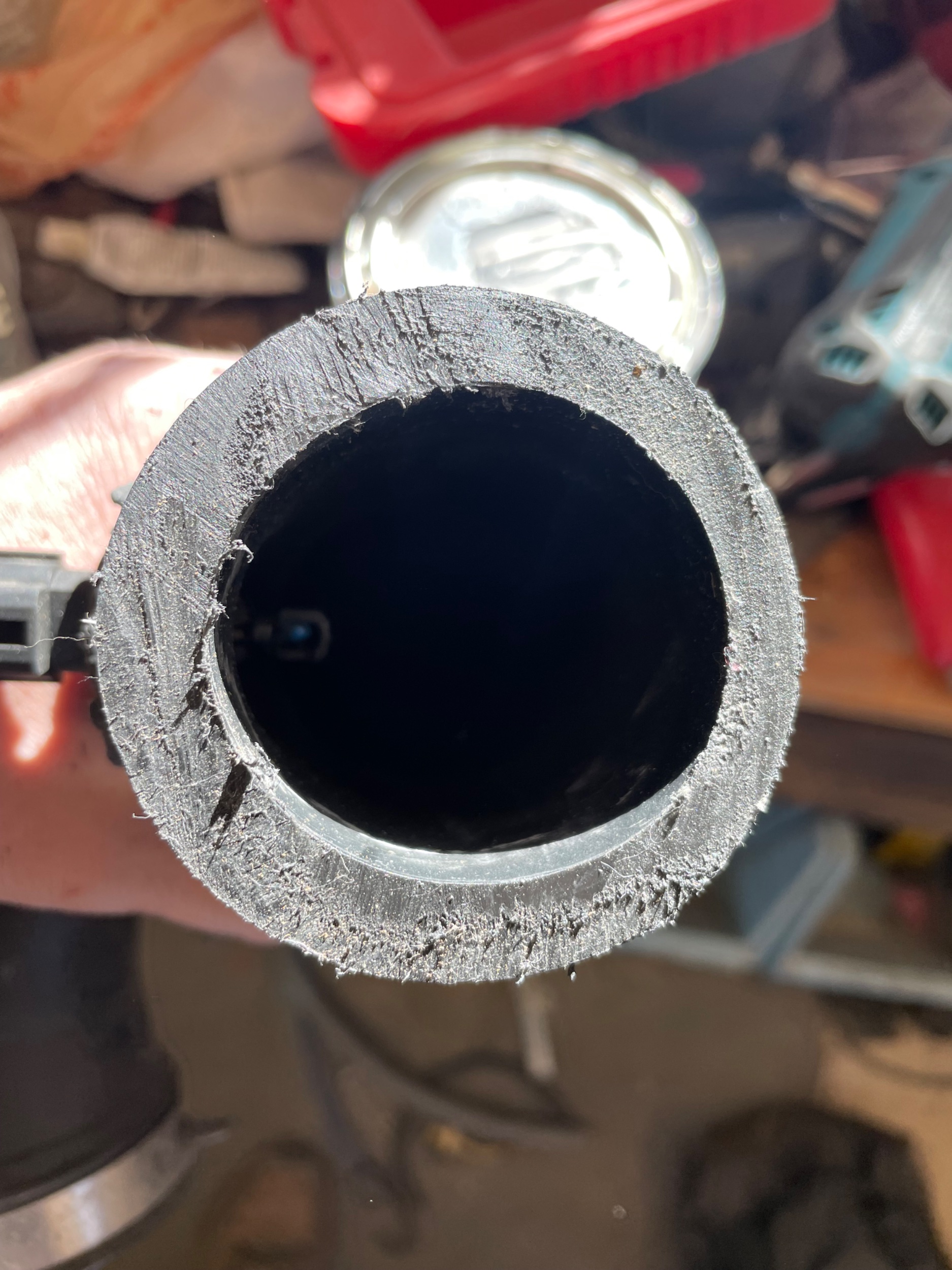

Here is a cross section pic of the air tube coming from the air box to throttle body. definitely smaller inside then it looks and smaller than the throttle body.
