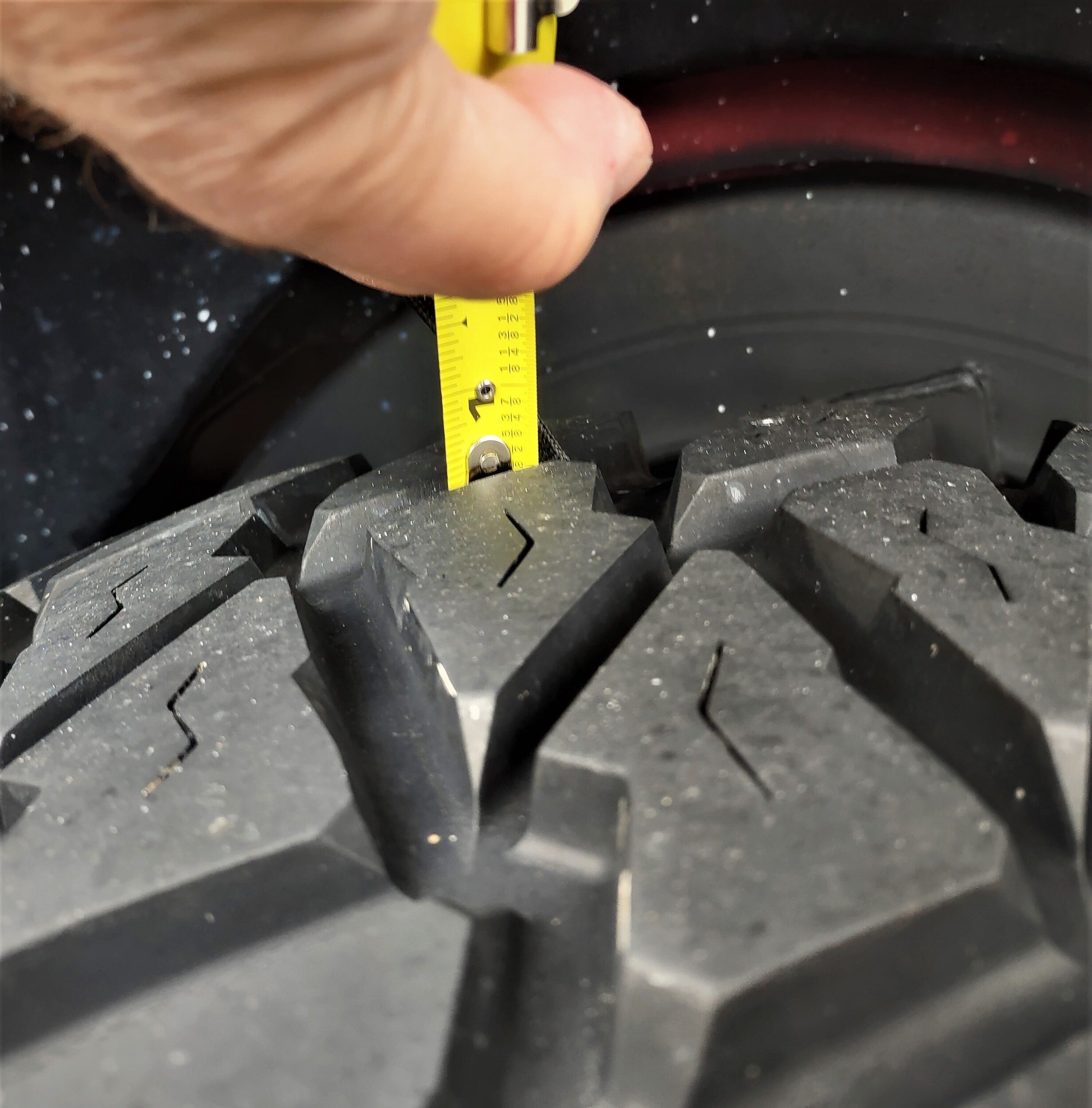

Im definitely due fir tires, I got them balanced but the jeep sat for a few years because i blew the transmission in 2020. My tires are from 2017
Damn man look at all that tred. I have maybe 2 mm left.

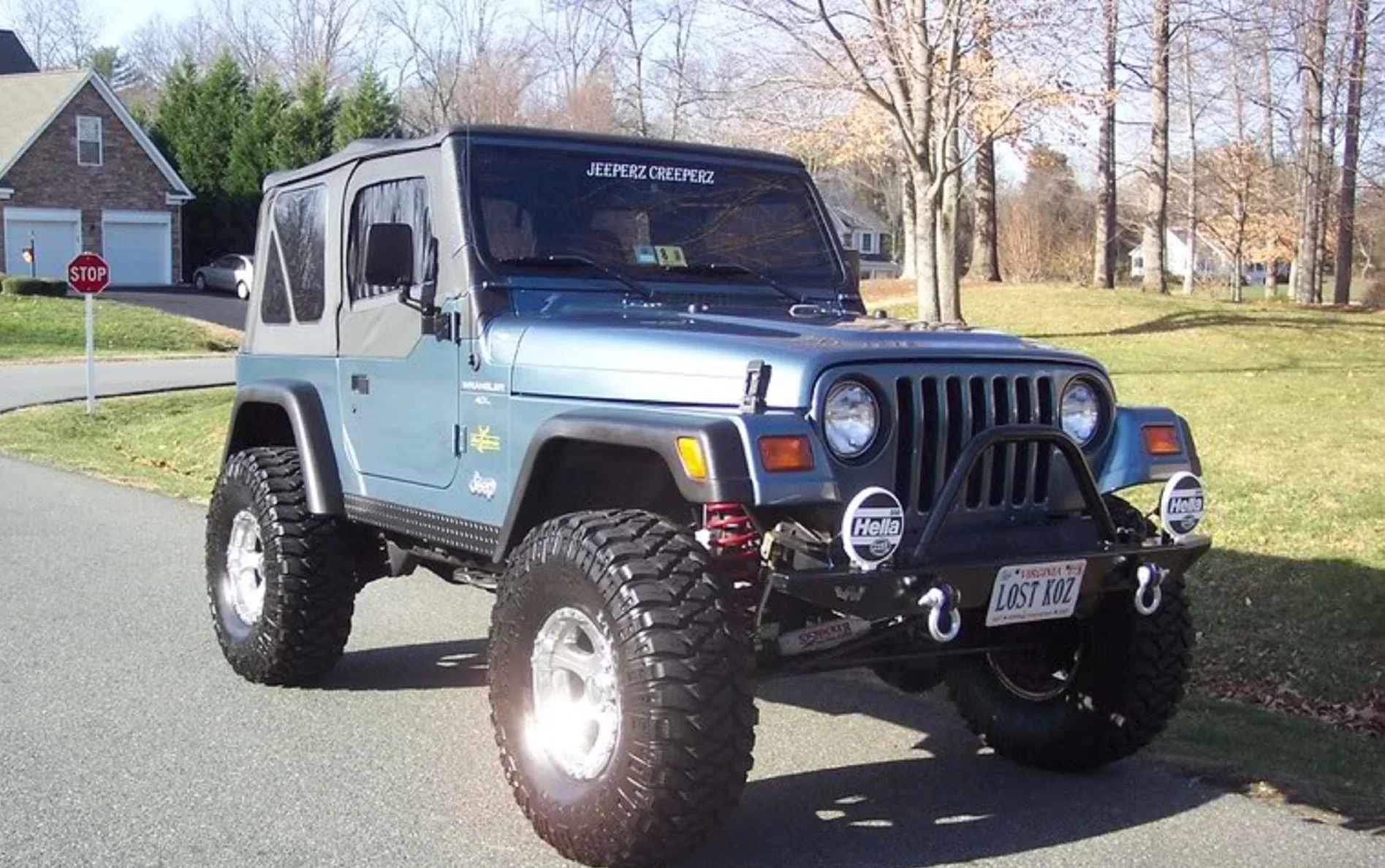

I've bought the Mickey Thompson MTZ tires since my first TJ (19 Jeeps ago). I always do a DIY alignment and keep 25 psi in them (35"). I'm too broke to buy 35" MT tires too often.
p.s. I park in front of my rich brother's house for the illusion. 🤫

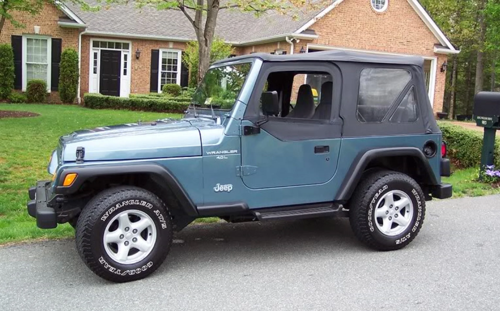

First 98' TJ.
